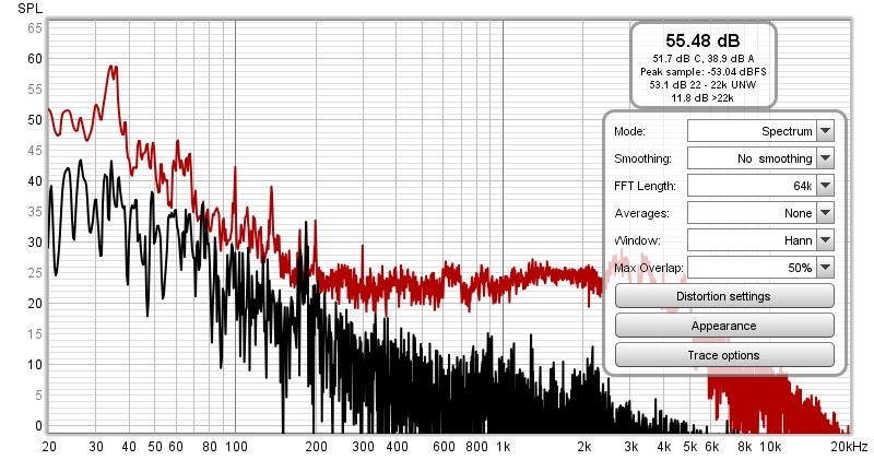

I connected the SET to the midrange driver, no protection cap, and measured the spectrum of ambient noise (black; quiet house) and the trace upon turn-off (red). The noise does have lower frequencies down to about 300Hz, but their magnitude might be low enough to be safe to use this amp on the tweeter without protection cap? About 15-20dB at 600Hz. It's a pro AMT, 102dB/W, rated 80W played above 1100Hz.

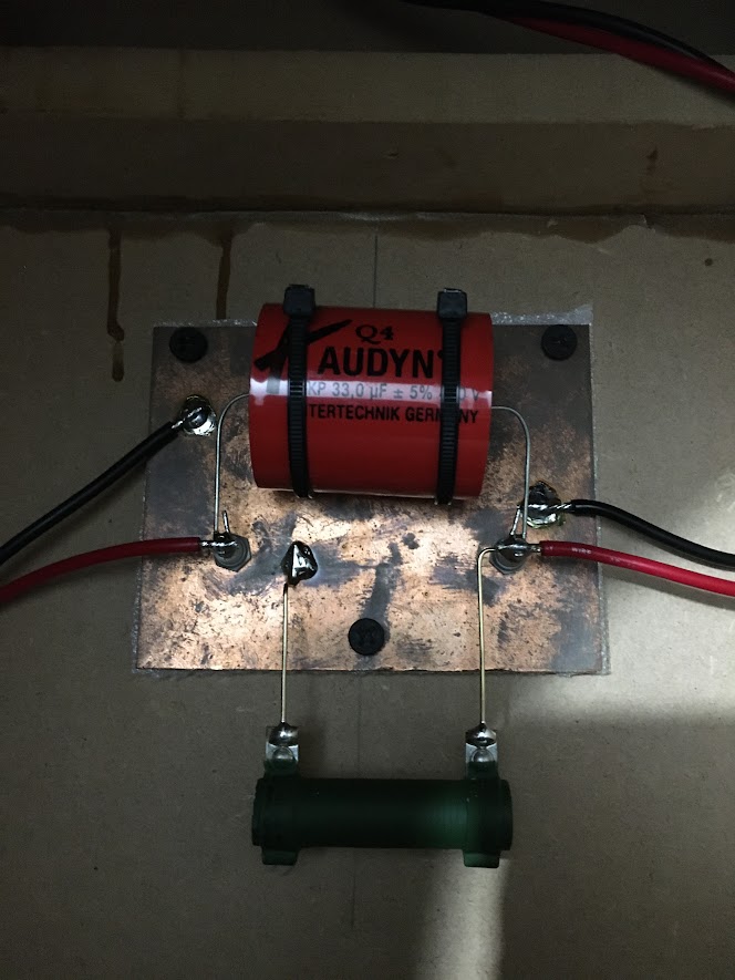

I've asked something similar in this regards some time ago, also an old JBL whitepaper recommended this resistor as well across the compression driver.That's not just a lack of damping factor, that's surely a resonance between the tweeter's inductance or mechanical impedance and the capacitor. A resistor across the tweeter (and/or in series with the cap) would surely help a lot, and a (low power) frequency sweep with and without a resistor would show the problem. Now that I read about this, I wouldn't want to use a capacitor by itself without something to damp such a resonance.
CD's + DC blocking cap + damping factor

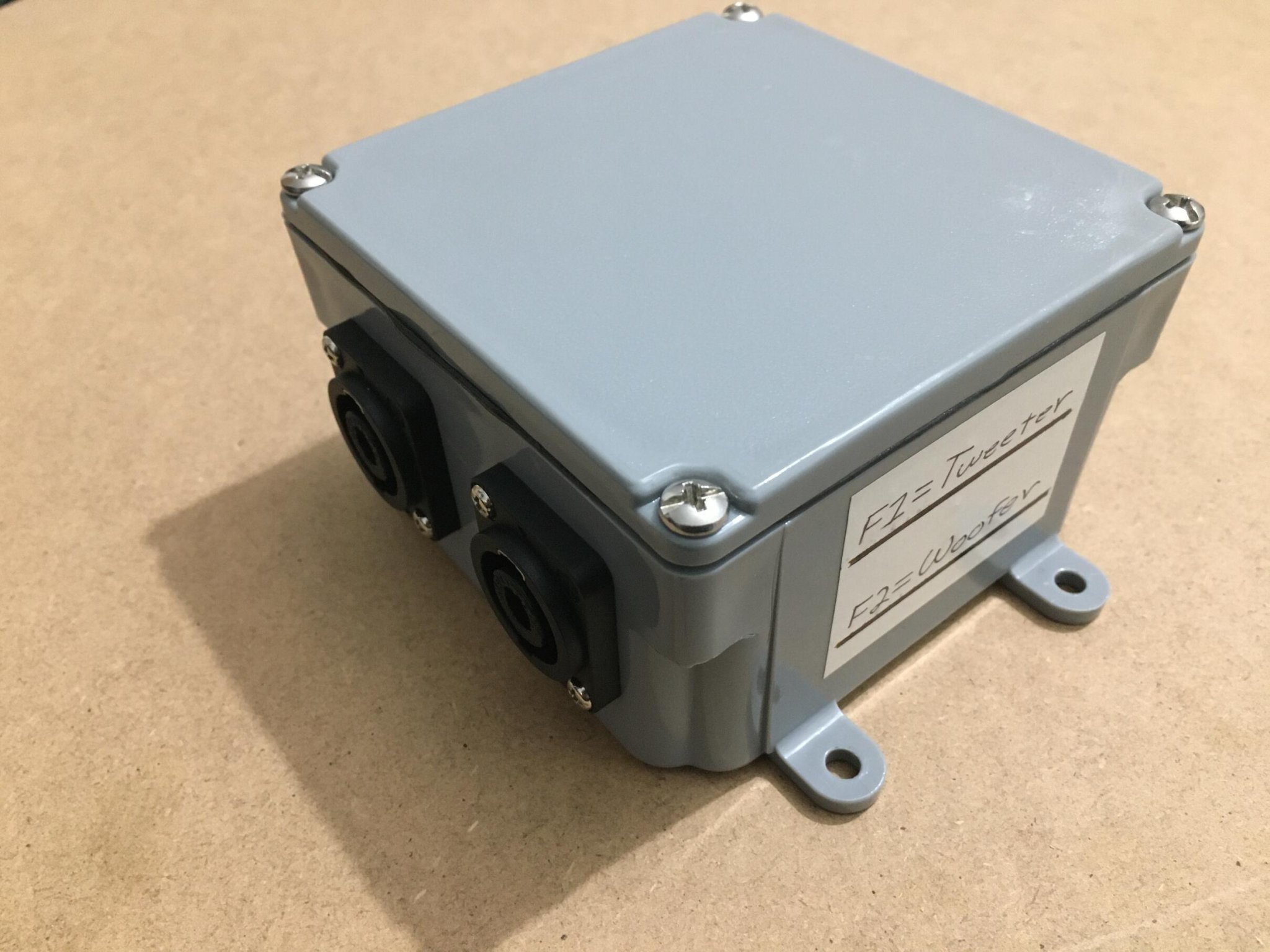

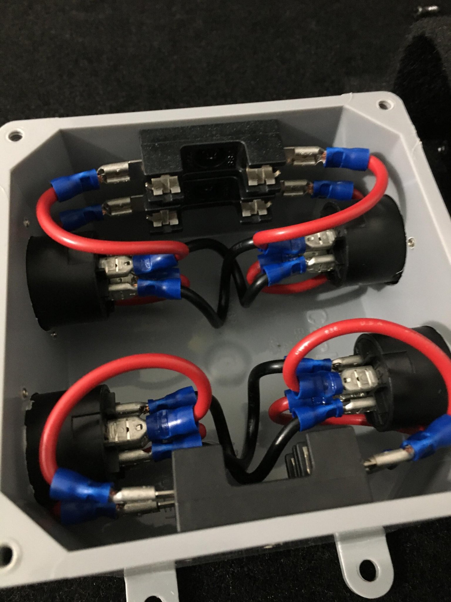

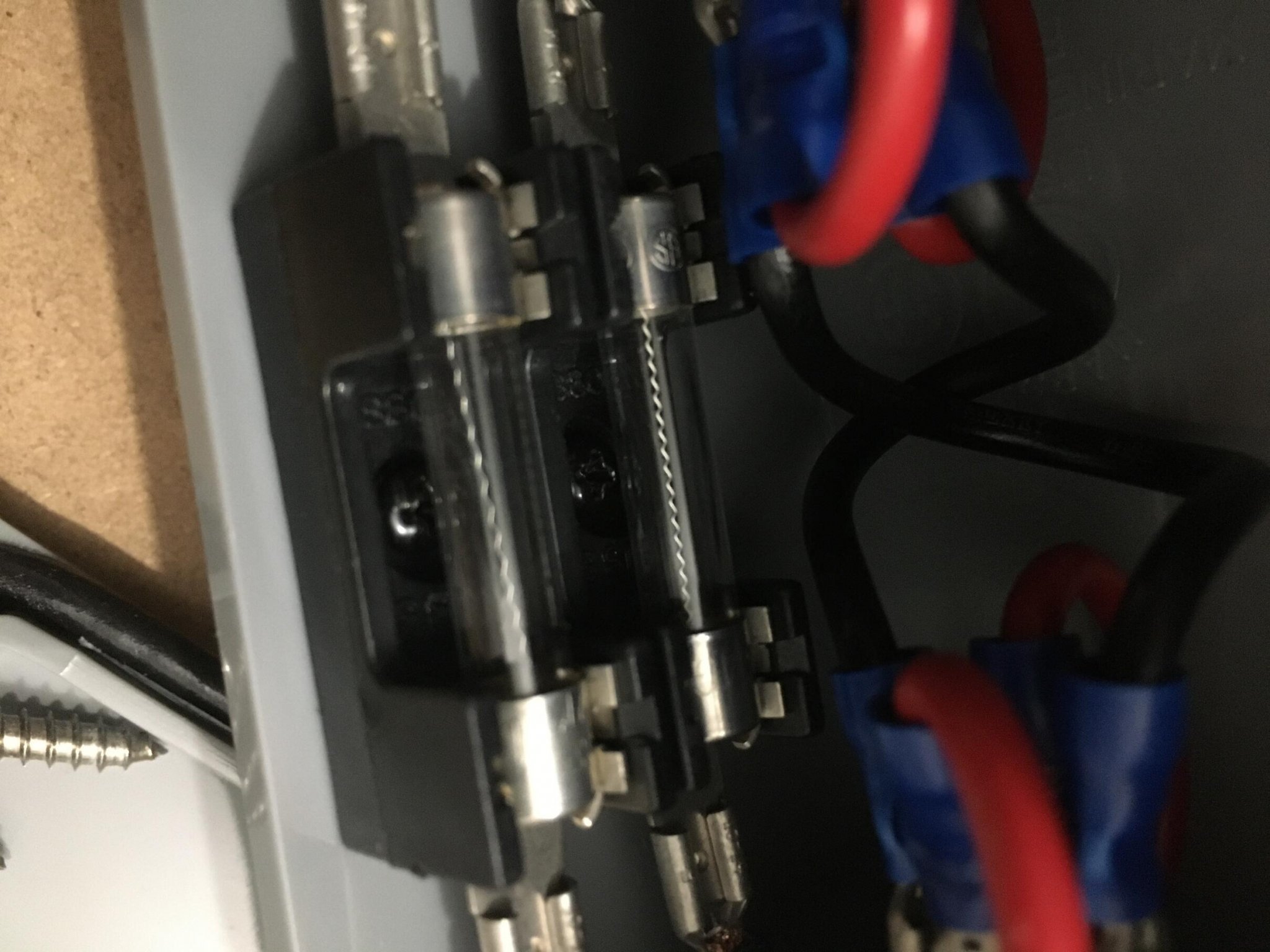

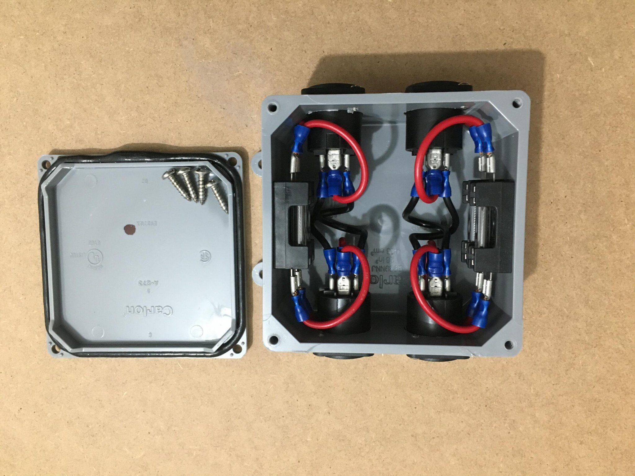

Now I just use the old-school way of using a very small fast-blown quality BUSS fusible and holders for protecting the tweeters in case the amplifier gone wild regardless having DC protection, but beware this does not protect against end-user error playing with the DSP but just overload and/or DC surges.
Here is the DIY fuse box made with an 4x4 junction-box and speakon connectors for reference:
The F1 is 1A for protecting the compression drivers, however the F2 is 9A(a bit oversized) as I don't care much for the midbasses as those can handle more abuse.

Can't say much about the mystery resonance and resistor damping, but basic electricity suggests a resistor is needed around driver.That's not just a lack of damping factor, that's surely a resonance between the tweeter's inductance or mechanical impedance and the capacitor. A resistor across the tweeter (and/or in series with the cap) would surely help a lot, and a (low power) frequency sweep with and without a resistor would show the problem. Now that I read about this, I wouldn't want to use a capacitor by itself without something to damp such a resonance.
That's because at resonance, the driver impedance goes way high (at least for voice coil drivers). So a capacitor which protects the driver at ordinary driver impedances, would be much less effective at resonance... just where you need it the most (even though that's lower in freq than the rest of the tweeter passband).

That's what I was trying to say in my earlier post. The "damping factor" as seen by the driver at (electrical) resonance is NOT simply (as someone else was saying) the reactance of the capacitor at that frequency, it is much higher due to the inductance of the driver. Due to it being a tuned electrical circuit, the voltage across the driver can be MUCH HIGHER than the voltage from the amplifier at the circuit's resonant frequency. The only damping is the voice coil resistance (and also the speaker cable resistance and amp output impedance in series, but they're surely less than voice coil resistance).Can't say much about the mystery resonance and resistor damping, but basic electricity suggests a resistor is needed around driver.

I'm measuring the noise the amp makes at turn-off, so I connect ithe amp directly to a midrange driver to be safe any lower frequencies won't damage the driver, and measure the spectrum of the noise.
Black line is without any sound being produced - ambient noise. About 55dB.
Red line is the noise measured at turn off, which indeed has lower frequencies down to 250/300Hz. If loud enough these frequencies would destroy the tweeter, specified for above 1100Hz 2nd order xo, but at 80W.
I guess the question boils down to whether the frequencies down in the 300-600Hz region are loud enough to damage the driver?

While playing music the active xo filters frequencies below 1300Hz so it's not an issue. Plus the 45-type SET is rated 2W while the tweeter is rated 80W...so while playing music it looks like a non-issue to me.
The problem might arise when I turn off the amp and low frequency noise is generated after the active xo. Hence my question.
Also don't see how measuring voltage over a resistor would offer much different insight than measuring sound spectrum from the midrange woofer. Can you help me understand?
