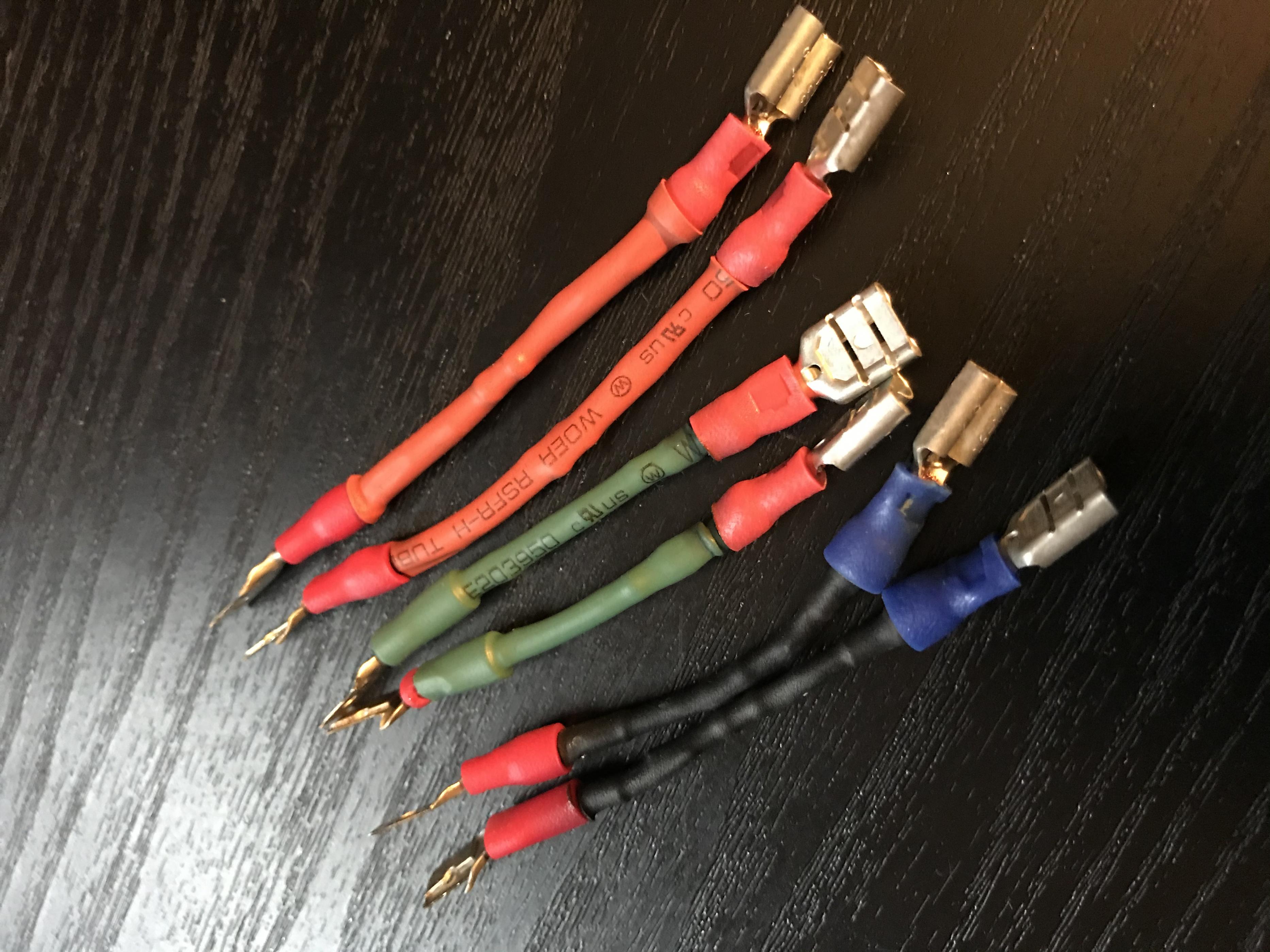

I added the “plug” on the end of the tweeter wire on the R speaker. Listened to a female vocal track and switched back and forth and it sounds like the high frequency (ringing like) sound is almost gone. By applying your method to the L speaker maybe I can hear what the difference between the two are.
I decided to make the second plug for the L speaker first and listen to this modification for a while before I solder the resistor to the crossover board, using AllenB’s method of placing it in series right next to the capacitor for the tweeter.
I have no idea what the difference will be but maybe I can hear it.

Pulled the plug and replaced the Clarity CSA capacitors with the OEM units. Low and behold the warmth, mid imaging is back. So I’m back to square one, where I wanted to tone down the upper frequency just a tad. I’ll try the plug in resistors I made first then draw the crossover in a CAD software package and start to play around.
you meant you still have no success with the clarity + extra resitors ? Go back to the original filter with the original caps if not in the garbadge. Clarity is a good invest for a further project or different needs. ( avoid long tim soldering, 5 seconds on a lead at 350C° is the maximum, better a hot iiron to go fast btw. Avoid soldering with silver into it.

Edit 2 : the resistors you use seems not to be resistors for speaker with bigger wattage... could explain also the bad result in your experience : too much heat gives distorsion.
