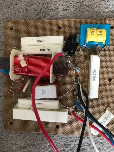

Before:

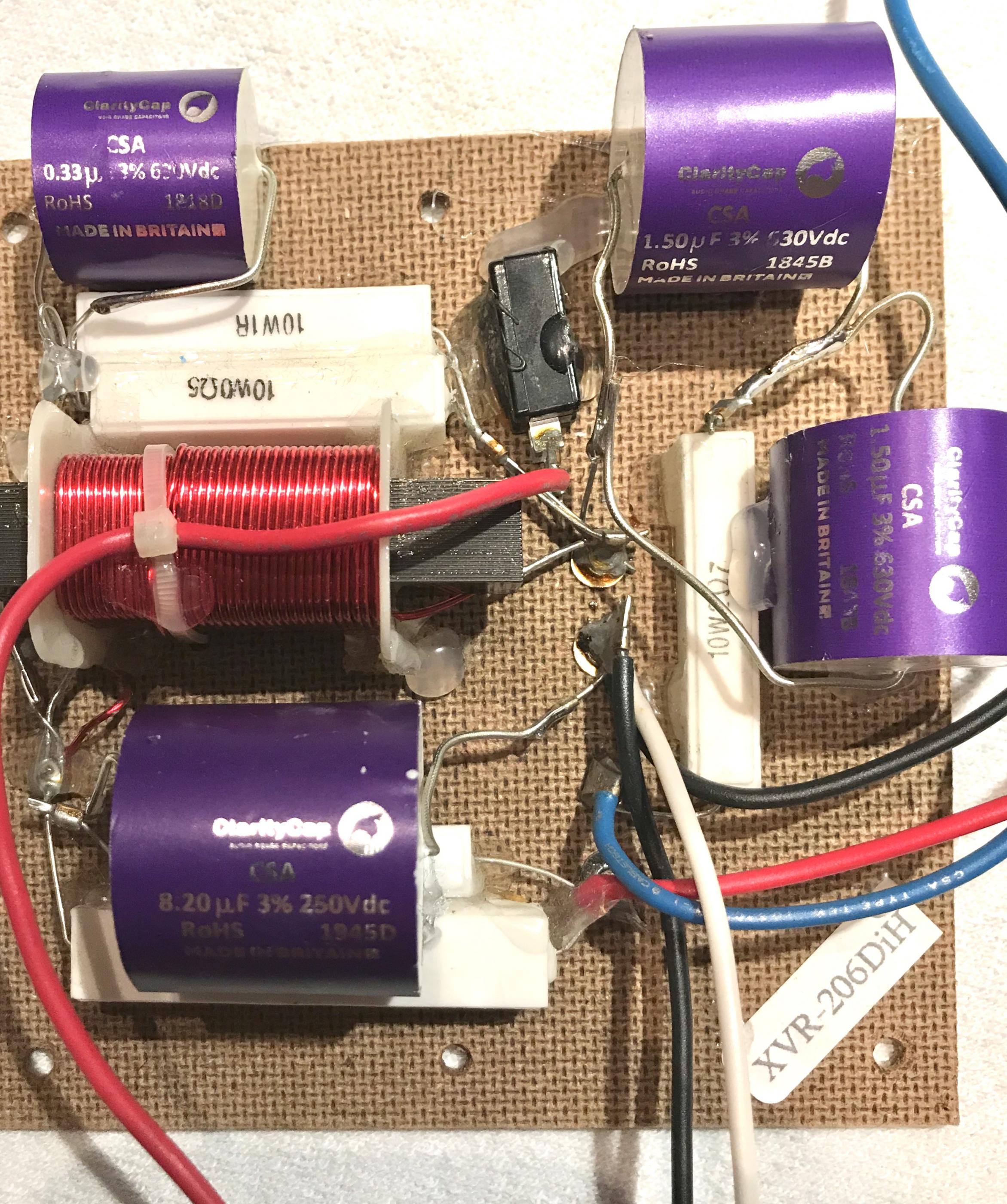

After:

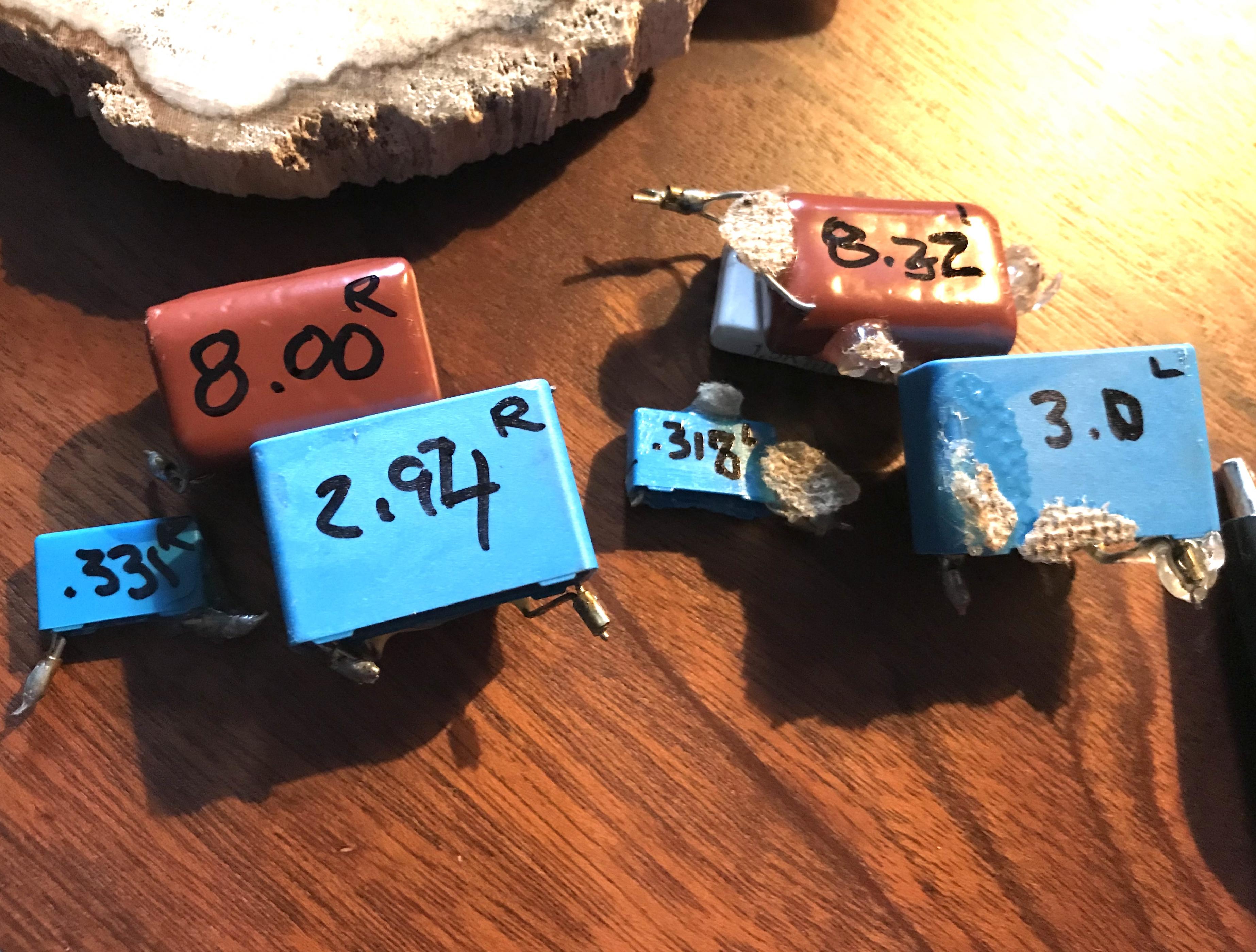

Double check the 8uF. Sure it wasn't 80?
Are you saying 8 is low and the original set might be much higher? I’m not familiar with what a standard configuration would be. I sent my original capacitors to Madisound who checked and sent the ones in the “after” photo.
It would be nice if you had a full schematic to share. I wasn't sure where that 8 uF was. It's a little low for the second pole of a low pass filter, so that's why I wondered about it.
Clarity caps are spot on. Can you measure the ESR ???
I don’t have an ESR meter.
Please swap back the squarred capacitor, you certainly moved from MKT caps (yellow is MKP or MKC or MKT?) towards Polypro which may explain less ESR with the Claritys and the perceived change + bias (you are so focused on a change that you may hear it wheither it happens)
What do you hear when going back with the formers ?

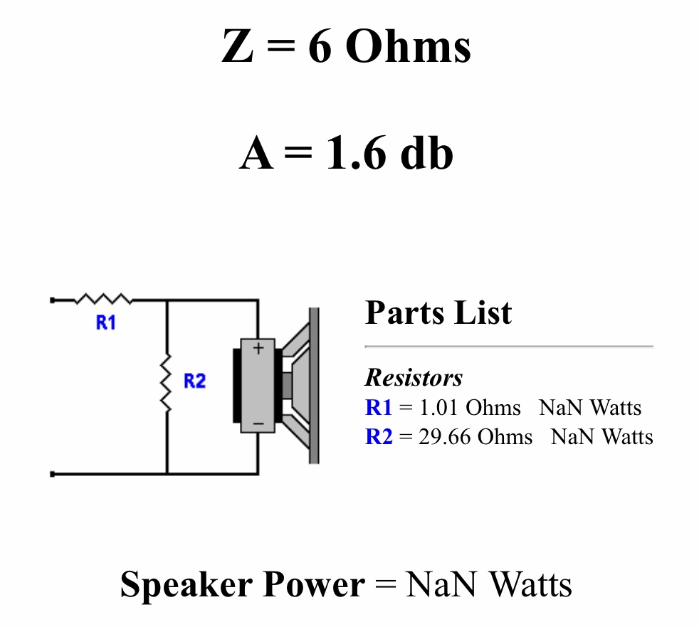

AllenB, looking on line I see single resistor like you recommended and 2 resistors. I have the second resistor to match your 1 ohm recommendation. I don’t know what difference I would hear going to 2 resistors.
Your situation is a special one and it is not about attenuating the tweeter (even though it looks that way).
Normally I would encourage you to consider two resistors for the reduced source impedance at the speaker node, however, your position is specifically compensating for a replaced capacitor.
When a capacitor is changed and it has a different ESR and you want to compensate directly, then you should use one resistor.

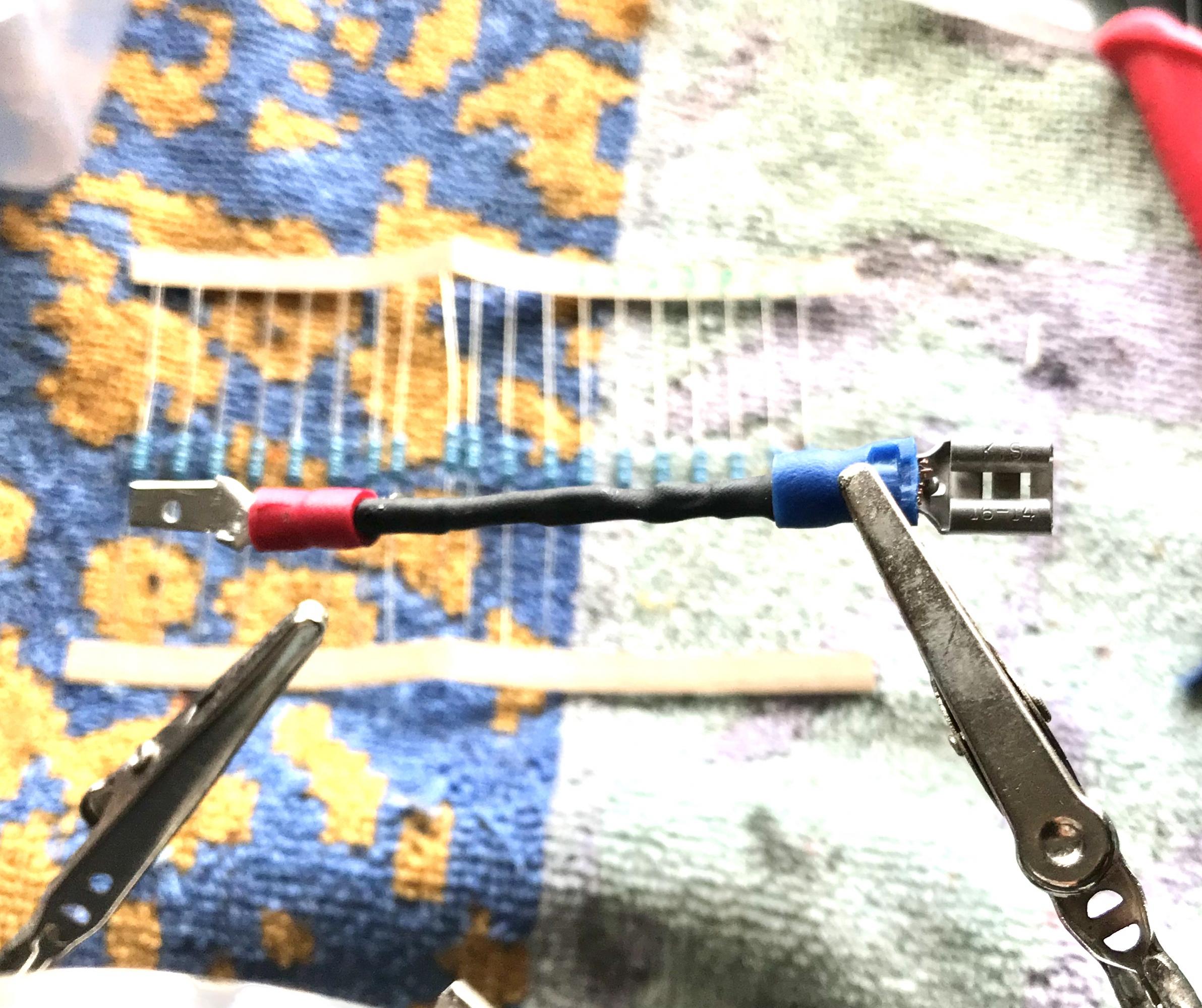

Thanks for the explanation. I’m adding the resistor now. I made an add on to the end of the tweeter connection from the crossover board with a 1ohm resistor soldered under the shrink tube. I think this is the direction you advised.
