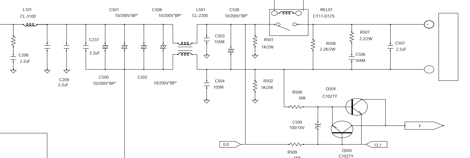

I repaired an amp for someone and the original problem was the 22uf 250 v no polar caps were blown .
I replaced the caps with the Mylar caps as suggested amp worked fine .
The customer opened the amp and sent it back saying the caps were not like the originals and I explained why the Mylar caps were used .
He basically said he wants the replacement caps to match the original caps and I told him I would give him his money back and send the amp back to him .
He got irritated and said he didn’t want his money back and wants the amp fixed so the replacement caps look original . He does not want to listen to what I’m explaining to him .
So at this point wondering if anyone knows where I can get 6 of these non polar caps from or an alternative cap that looks more original the the big Mylar caps that were used
A lot of amps used them. The diagram below is from a JBL BP1200.1. These are 10uF but the caps used vary from multiple 10uF to multiple 33uF BP.
