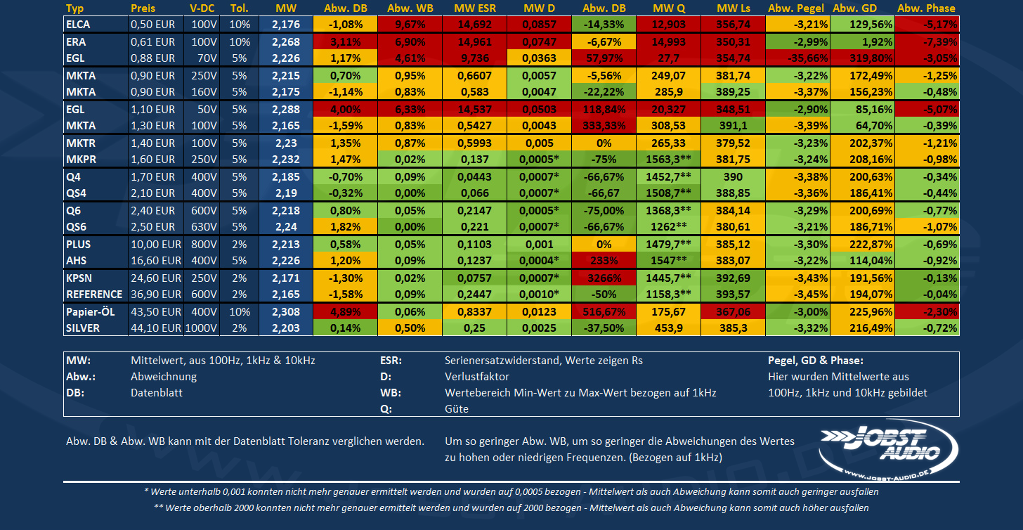

In the 2000s, German manufacturer and distributor Intertechnik published distortion measurements of different coil types in the yearly catalogue, also HobbyHifi magazine did similar measurements at that time. Best result gave Laminated Steel I-Core Inductors, since then I took this type whenever I needed a larger coil for the lowpass in series to a woofer in a 3-way. Large wire diameter aircoil would be perfect but too expensive....

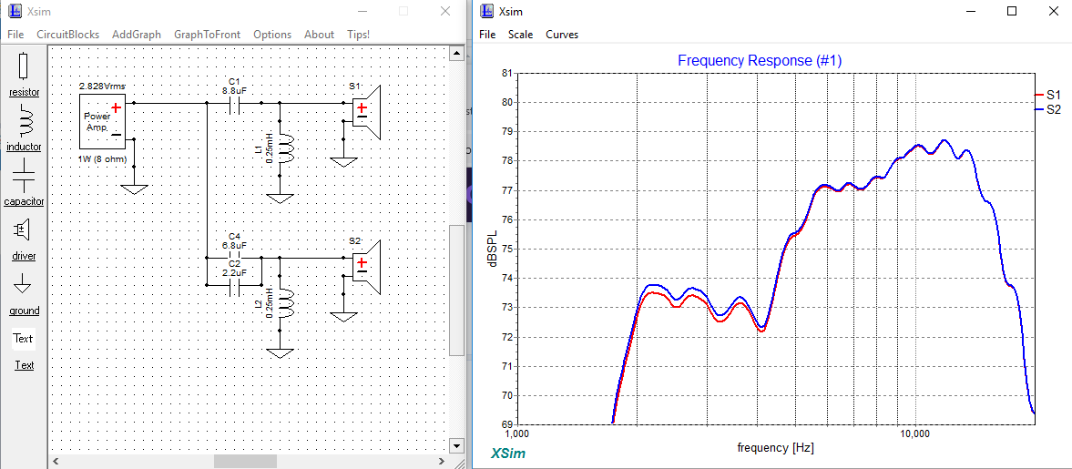

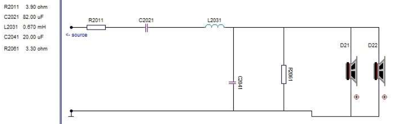

Regarding exact values for crossover components, try simulating them (XSim) and check your self that there is no need of perfect matches.
See below an example of a filter with 8.8uF and 9uF (6.8+2.2 easy to find). In the worst scenario, the difference is around 0.3 dB. Imagine variations you have in your room and listening position - we talk about several dB's, so no need to get worried about small micro variations.

Comparison between 8.8uF and 9uF:

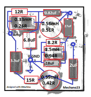

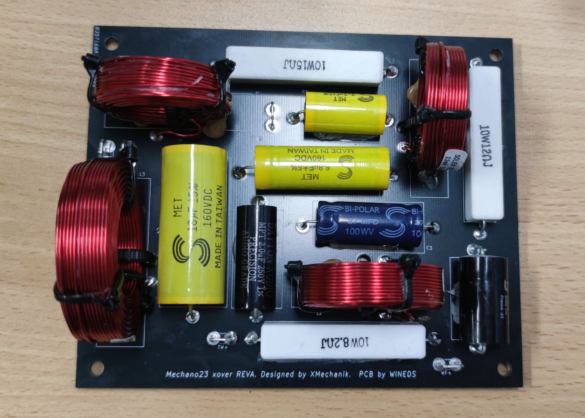

Hello chaps, noob here, i would like to make the Mechano23 crossover but SoundImports does not have the correct capacitor value what do?
Correct cap value = 18 µF | 5% | 160 V
They only have the Jantzen Audio 001-6144 | 18 µF | 5% | 100 or 250 V
1) Will 100v be okay (cheaper €1.49 - please say yes 🙂)
2) shall i use 2 parallel caps of 10 + 8.2 at 160v each (€10.64 - 7 times the price of 100v above 💰)
3) audiophonics.fr have the right one but its €4.90 and shipping fees/VAT etc
What do bro's, what do?

@ubermensch in general as long as you have good enough capacitors, it doesn't matter what you take, you can save A LOT by not going Jentzen.
Also in general stacking the capacitors is fine as long as the capacitance total is close. But you can easily find 18uF from for example ClarityCap. Want to go much much cheaper? Try to get polish Polnik capacitors - amazing prices, still sound the same.
I myself won't go for 100V, someone more knowledgeable than me needs to comment on voltage.
I was massively using parallel capacitors in my passive crossover, sometimes as many as 3. In fact, using parallel caps is often recommended for the reasons:
  1. You can get the exact value, not even by value but by measuring the result with a microphone. Croco clips are your friends
  2. You can get the value with whatever spare you have in the toolbox
  3. You can get most of the value with a cheap cap, and then add the final delta with the best you can. High value high end caps are expensive
  4. It's really nice to add a tiny bypass cap with value of 0.1 or even 0.01 to sprinkle cleaner highs
I was usually coming with something close but different from what Xsim recommended anyway. Maybe that's why it took me 5 months to build my speakers but I was really enjoying assembling >20 versions of my crossover with Wago connectors and listening each variant for days.
On the picture, please remove those white resistors, they have some inductance because the wire inside is twisted. Being right next to the inductor will cross feed them. Just use those green $1.5 parts express resistors.
