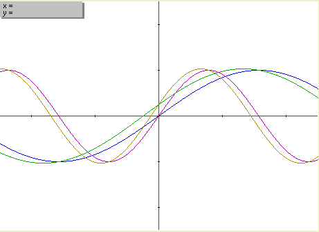

Okay. I understand now.
B*A0*sin(omega*t-phi) + C*A0*sin(omega*t-phi-theta)
can be expressed as
D*A0*sin(omega*t-phi+rho)
where D and rho are some function on B,C, and theta.
Since pictures are worth a thousand words, maybe the image below will help others like me. Blue and purple traces are equivilent to sin(x) and sin(2x), green and brown to sin(x)+0.25*sin(x+(pi/2)) and sin(2x)+0.25*sin(2x+(pi/2)). It should be clear that the above relation holds, and moreso that rho has a linear relationship with omega.
