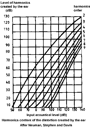

None of the newsagent for miles around here carry E&WW, and I don't want to subscribe, so I haven't read the articles you mentioned, though I'd like to. Did Cyril only measure THD, or IMD as well? I don't think THD is as audible a problem as IMD, IME, so it'd be interesting to see how the components measure, both under static conditions, and with a two-tone burst, and looking at the response in the time domain on a spec-an and THD meter. If that test had a poor result with two tones, imagine what it must be like trying to reproduce something with an enormously complex structure like a choir.
I found this in my files, and thought you might like to see it. I cannot find the supporting documentation for it (probably lost in my PC crash last year), but I do recall it being a valid looking study.
THD Tester
Oh boy, are you saying that my ears distort too now ?.
I always thought that my ears were 'blameless' !. ;)
Only joking - I well know that already from experience.
Recent high spl exposures and wax ear can cause extra clearly audible distortions and resonances - really infuriating/disturbing if it's bad.
