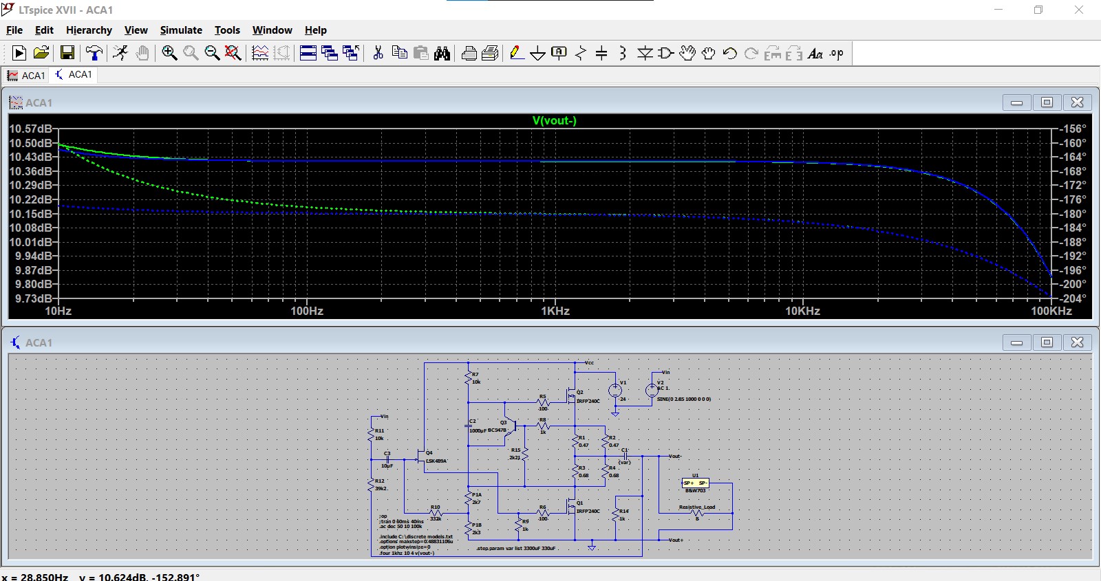

The popular ACA here on diyAudio has the coupling cap within the feedback loop. If you plot the response with the 3300uF as recommended or reduce it by a factor of ten to 330uF the result is the same... at least outwardly.
In practice the signal level before the cap at low frequencies is very much larger so as to take into account the high reactance of the lower value cap.
This is using 3300uF and 330uF into 8 ohm. The top trace is actually the two different values overlaid on each other. Essentially identical in response.
