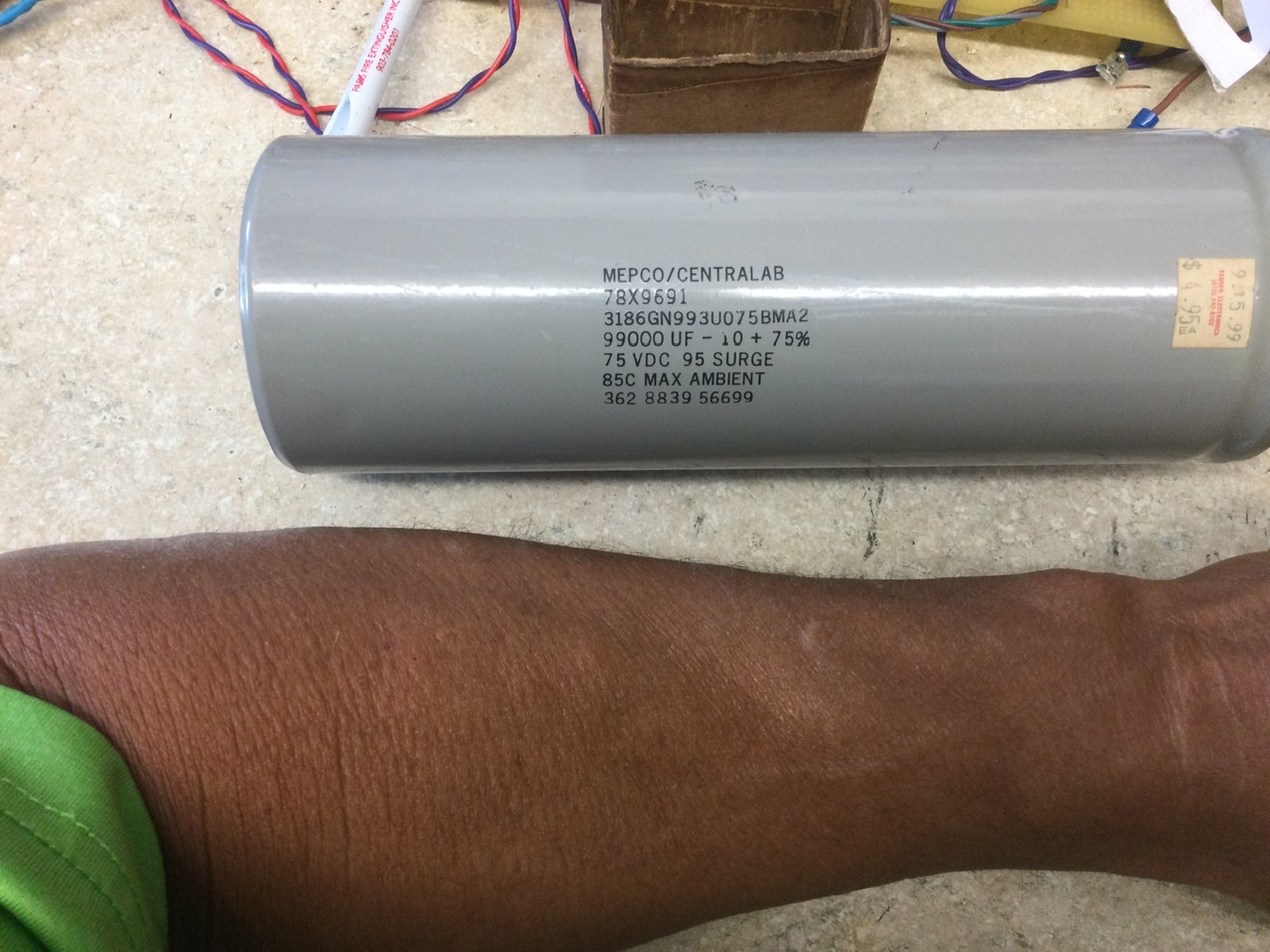

You are talking mid to late 60´s at most.When I went to my first hifi show, I was a bit surprised to see how many amps had massive capacitors on the output. Some of these capacitors were the size of my forearm.
Like this one? These would allow decent bass response even with a 2 ohm load.
2015 actually. I'm still in my 20s.
If you guys tell me that cap coupled outputs are pretty rare, then so be it. It just means that I have had pretty unusual experiences up until now. I am actually happy I am wrong because I never liked any of the cap coupled amps anyways.
Yeup. A lot like those. Just with a polished aluminum finish.
