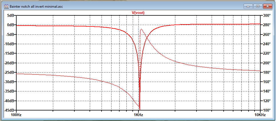

I found a thread here about the Hall notch, where halfway someone promoted the Bainter over the Hall as much easier tuned. Go figure ;-)
Bainter with flat 2nd - 3rd response.
Jan
