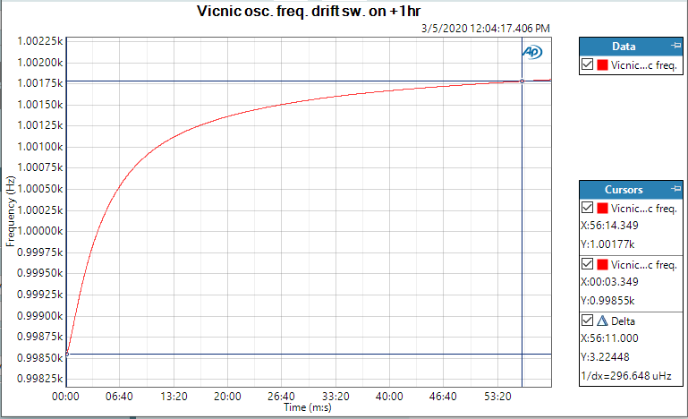

Matt, thanks for that. But my purpose is a tracking notch that follows the oscillator as it wanders or drifts slightly. Say total tracking range of 6 to 10 Hz. For a nominal 1kHz oscillator that means it could vary between say 995 and 1005Hz and the notch, at nominally -40dB, will follow it and keep it centered. The goal, as you noted, is to decrease the ADC dynamic range requirements and thus its distortion.
A flat notch with a similar width would be nice but the ones I found were always 4 or more staggered notches and pretty complex. The tracking is not that hard to do, but the issue is the distortion from the tuning system. It is much easier though than the AGC of an oscillator because the control speed can be very slow (oscillators typically drift over 10's of seconds or even minutes) and there is almost total absence of oscillator signal in the control signal. The remaining non-linearity is the inherent non-linearity of a tuneable impedance.

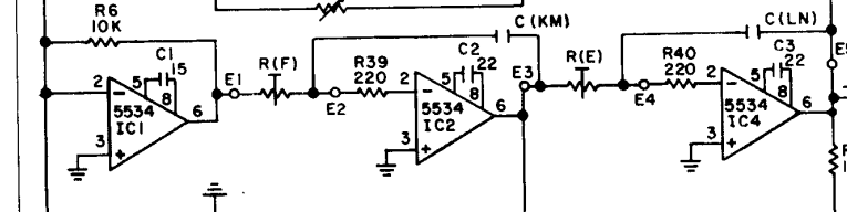

I now believe that the 20 ohms made a difference because it made the notch less deep which also means that the internal voltages, especially at the output of the opamp driving R1, also drop, which would lead to the lower distortion.
The difference was only a few dB anyway.

As I mentioned, the circuit I posted only uses inverting mode stages thus this effect does not apply.

That would de-Qing the capacitor which should show up in a simulation.

It does. Those 20R resistors decrease the notch dept from over 60dB to about 40dB. And it lowers the signal voltage at the output of the integrator by several dB. That could explain the difference in distortion, more than the 20R decoupling the capacitive load.
I was kind of stuck in this rut, I think I should stop worrying about that cap load and move on with the design.

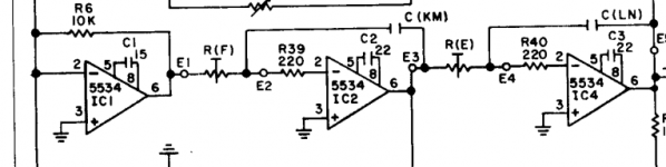

Actually I specifically moved GP3 to that position so that the cap drive would be isolated from the (unknown, often) source impedance.
You might think about the the CdS + LED (NSL-32S42) that Jim Williams used in his 2011 article--it works really well. The voltage across the CdS is very small (10-20 mV), the distortions of the oscillator are well under -140 dBC. Plus, the control is simple and 100% isolated--a DAC and opamp with 10-20 mA of drive capability could do the trick.
I indeed am using the NLS-32 .... And that 20mV is indeed a sweet spot. You're no longer allowed to guess here 😎

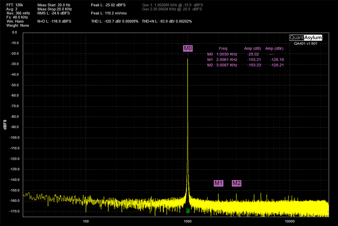

Re -135 HD. We need to put this into perspective to see what could cause it. -135 dB is around 300 parts per billion, a very small number. for a 32 nF cap 1 ppm would be 32 fF so this is around 10 fF equivalent change in capacitance somewhere. Its very conceivable that the input C is modulating that much with even the small voltage at the inverting input. The input C change varies a lot in different amp circuits. A cascoded circuit will have less modulation. It usually shows as odd order (if I have it right) since its a single ended phenomena, except on complementary inputs where it could be symmetrical.
When you are looking at nonlinearity this low everything will show up. PCB, solder mask flux residue and component issues can all show up. Lower impedance helps until current effects show up. A classic demo with the CLT-1 is to take a pencil lead to a resistor lead on a resistor under test. it increases the distortion as the lead interacts with the magnetic field around the wire.
An input charge error should show up in a simple resistive inverter circuit, the capacitor only shifts the phase 90 degrees. The composite amp IIRC has enormous AOL at 1kHz, I can only extrapolate from the paper but there should be <micro-Volts at the input.
Yes. Samuel's best guess is that the distortion at 1kHz is about -200dB (his measurement limit was -180dB). The OL gain is gigantic at 1kHz. Microvolts at most as differential input signal. It find it very hard to imagine that this would modulate the input capacitance.
It will be some days before I am back home and can experiment again, but my suspicion now is the trimmer that is in R1 position.
