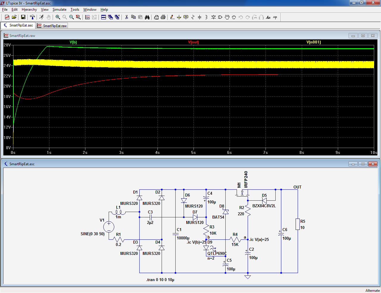

MOS-based cap multipliers gain in popularity, but they have one rather serious drawback: along with the ripple, they also eat a substantial amount of good DC voltage that could be used for more productive purposes than generating heat.
Here is a first possibility to improve matters:
The idea is to generate a small auxiliary supply with C3, D6, D7, C4 to drive the gate at a sufficiently high voltage wrt. the source.
What is "sufficient"?
It depends on the MOS characteristics, the supplied current, the direction of the wind, but also the minimum voltage seen at the drain.
This circuit takes into account the latter, by locking the drive voltage to the bottom of the ripple valleys, thanks to D8 and C5.
D9 and R3 then shift this voltage by a "reasonable" amount to drive the MOS.
You have to decide what that reasonable amount is, but when it's done (correctly), the circuit will automatically adapt to the input voltage/ripple, which is a small, but non-negligible improvement over the plain-vanilla version, in addition to the lower dropout voltage (yellow trace is the raw input voltage).
Next, we will see how to go a bit further with moderate complications.

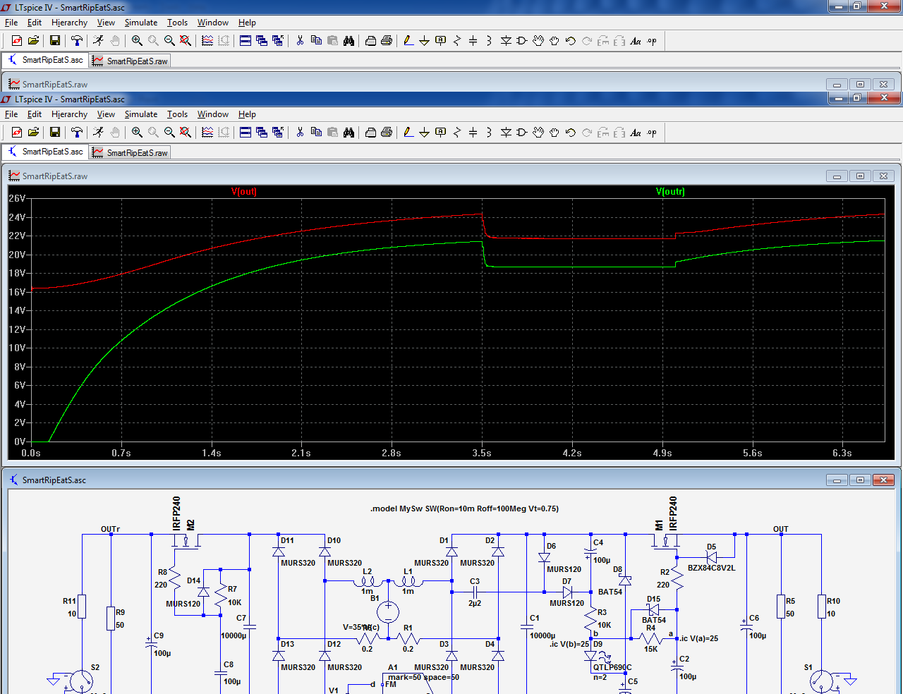

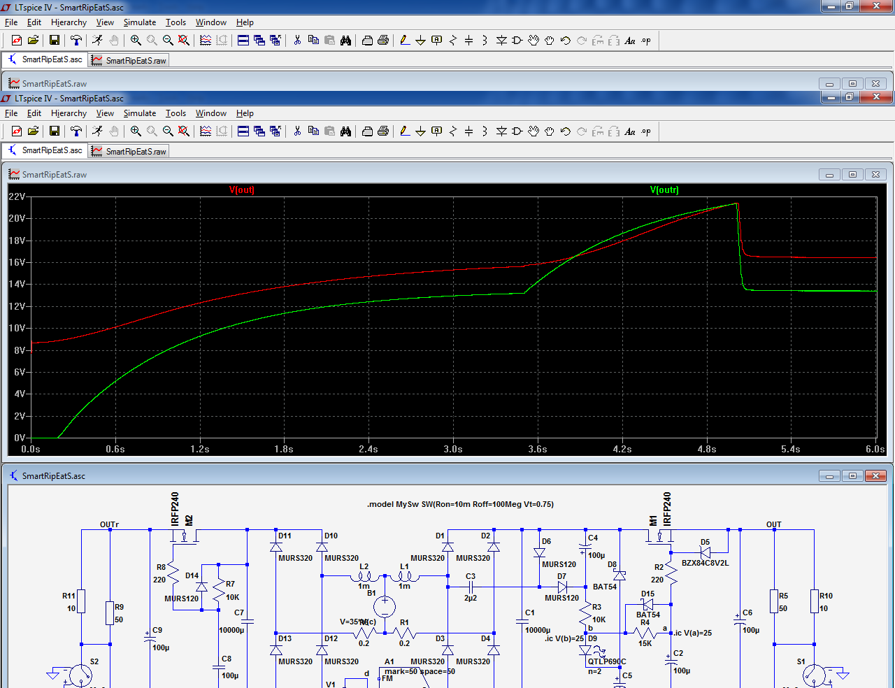

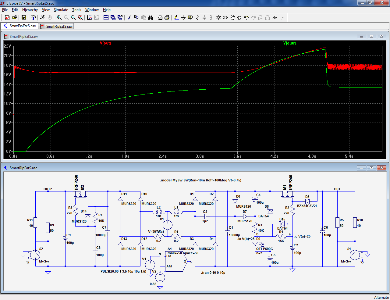

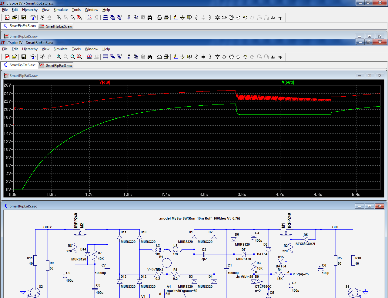

The transient behavior for line and load steps is rather disgraceful, see pic 1 and 2, with an ordinary multiplier for comparison: after an input voltage decrease or a load increase, the function is lost for some time.Elvee, for the first post, can you show some transient responses say for step load and step mains. The gate reference voltage is nicely clamped to the min of the raw ripple voltage, being directly pulled down if the raw ripple voltage sagged, but what does the recovery look like when load is reduced.

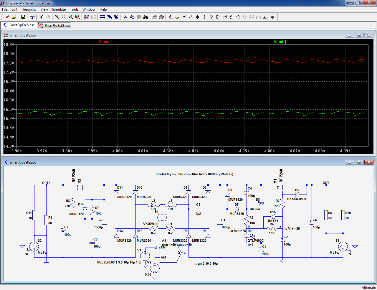

Fortunately, the remedy is extremely simple: add a diode (D15) across the filter's resistance, see pic 3 and 4.
Regarding the max ripple input, the limit is common sense: if we reduce the main filter cap by a factor 10, to 1000µF, the behavior remains normal: although it still manages to remain ~2V above the regular type, its output ripple is somewhat cleaner: pic 5

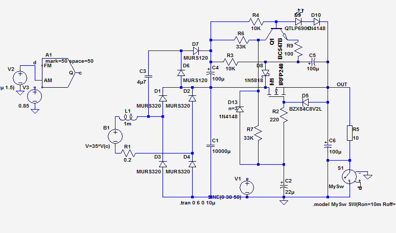

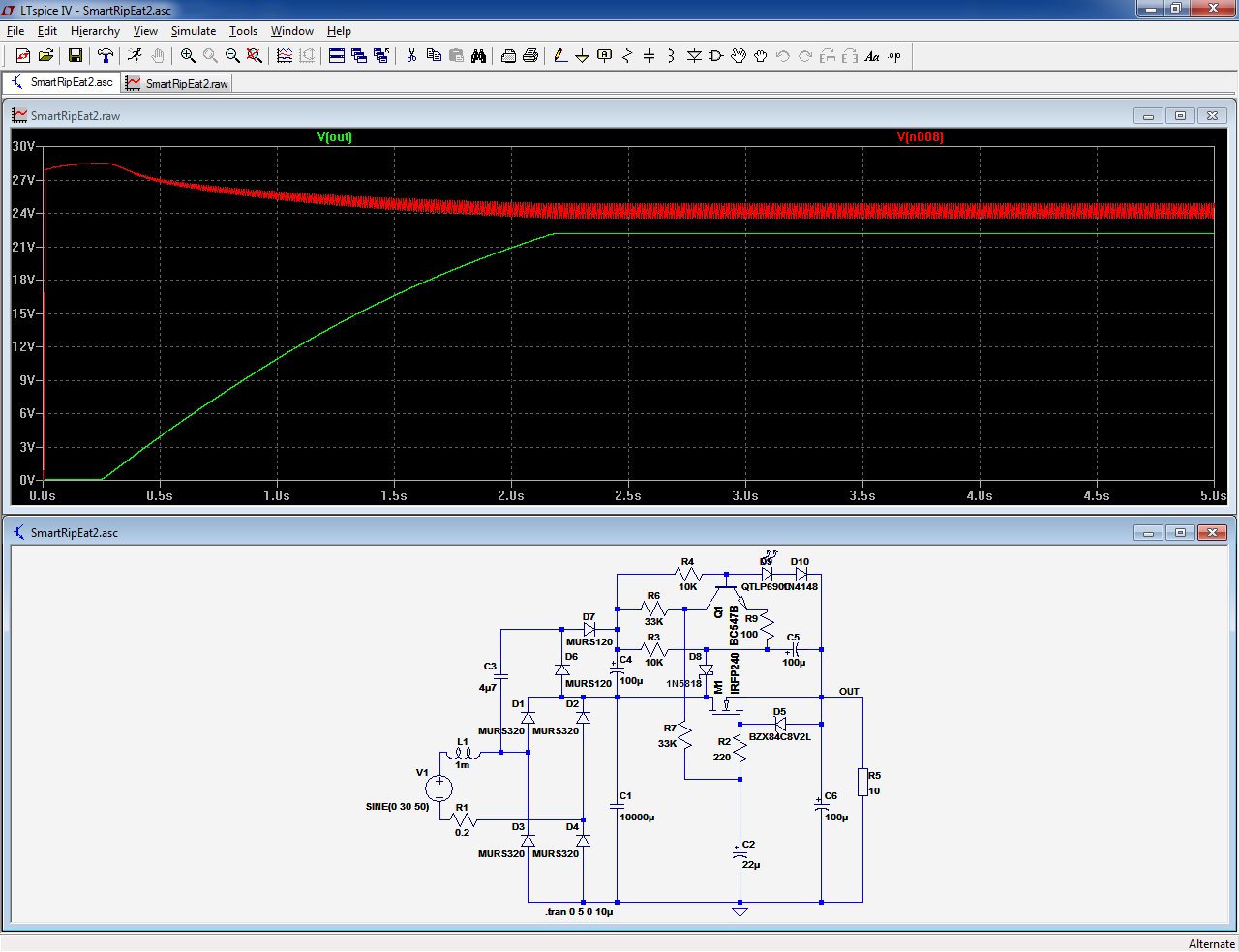

Let's examine the next step: the way the dropout was defined is not very practical, and directly imposing a minimum, deterministic dropout by design would be more convenient.
That can be done with a single additional transistor, see pic 6:
Here, the troughs of the I-O waveform are sampled by C5 D8, and the resulting value is compared to a reference, again a LED (but other options are possible) by transistor Q1, which in turn steers the multiplier's filter.
This eliminates lots of unknowns from the equation.
At first sight, one would think that with so many components straddling the I-O space, the performance would be degraded, as they leak corrupted input voltage into the output.
In fact, the opposite happens: the main performance limitation of simple, non-GNFB cap multipliers stems from the output conductance of the active device, caused by the Early effect for BJT's or the channel length modulation for FETs.
Additional components in parallel with the output should in principle compound these effects, but here, the active circuitry provides a raw, first-order compensation of these effects, in a similar (but cruder) way as the one outlined here:

The waveform at the collector of Q1, after integration by the filter R7 C2 mimics the effect of the ripple, but with an opposite phase.
This trick provides a 2~3 fold improvement over the physical floor imposed by the active device; not very much, but not to be scorned.
