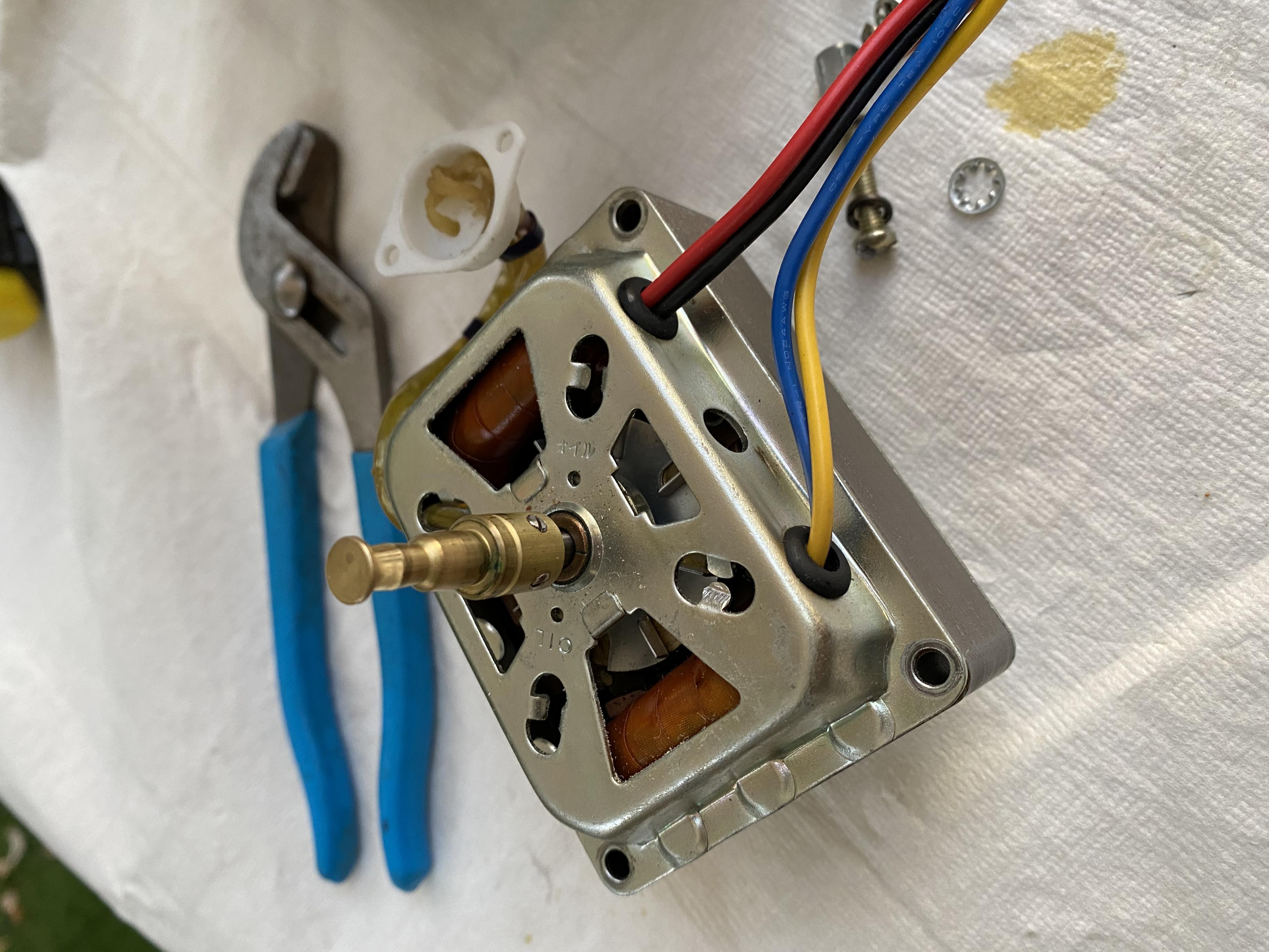

Okay, I cleaned and oiled the spindle. The thrust pad looked fine, but I cleaned out the old oil, wiped with IPA and reassembled. Problem persists. I tried moving motor up and down to see if the springs were sagging. No improvement. I have managed to get the motor off the motor plate but cannot get it open. Can I still do the boiling routine without disassembling the motor. Could someone give me a few tips on how best to clean old oil out of the motor and apply new oil?

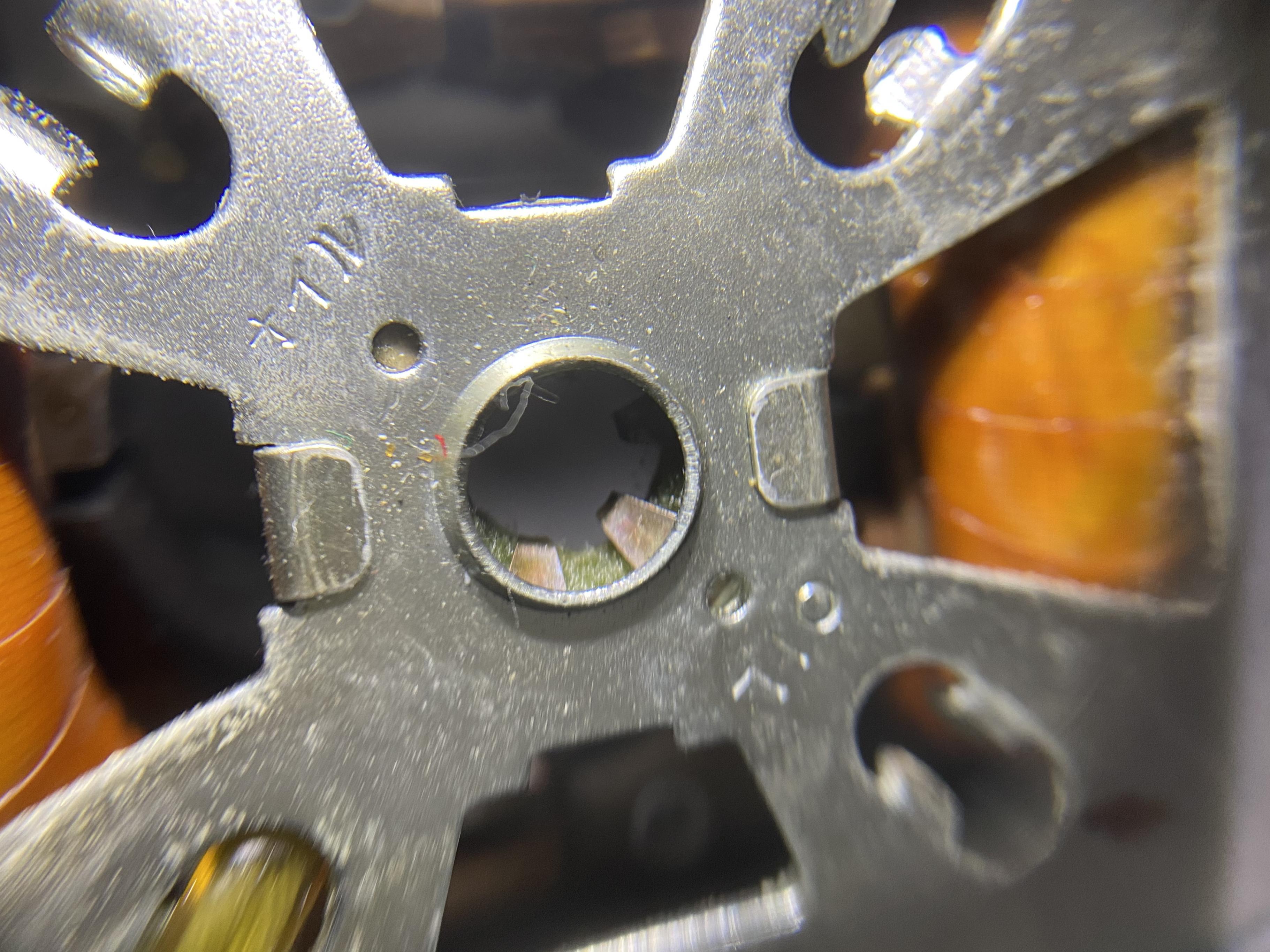

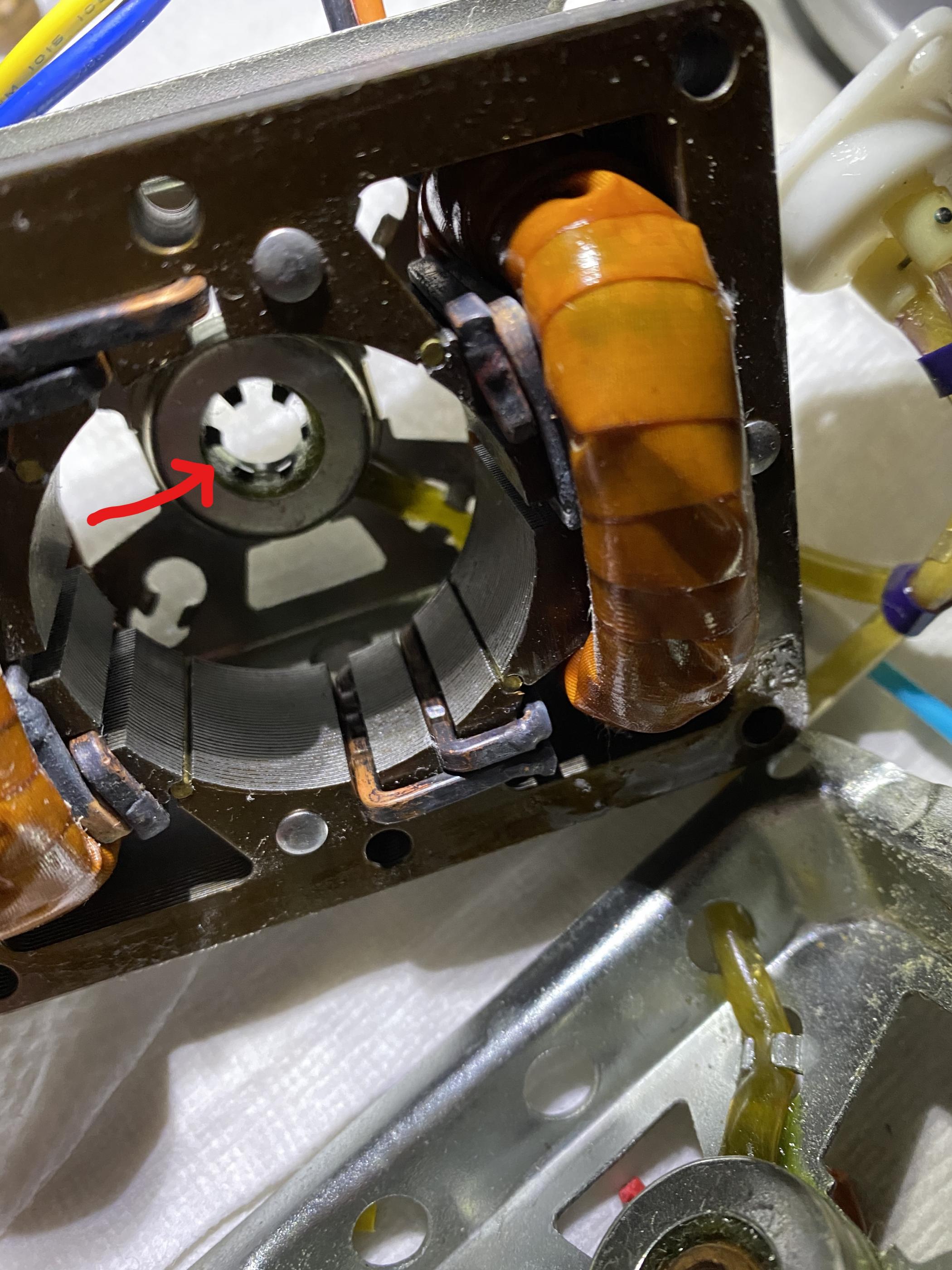

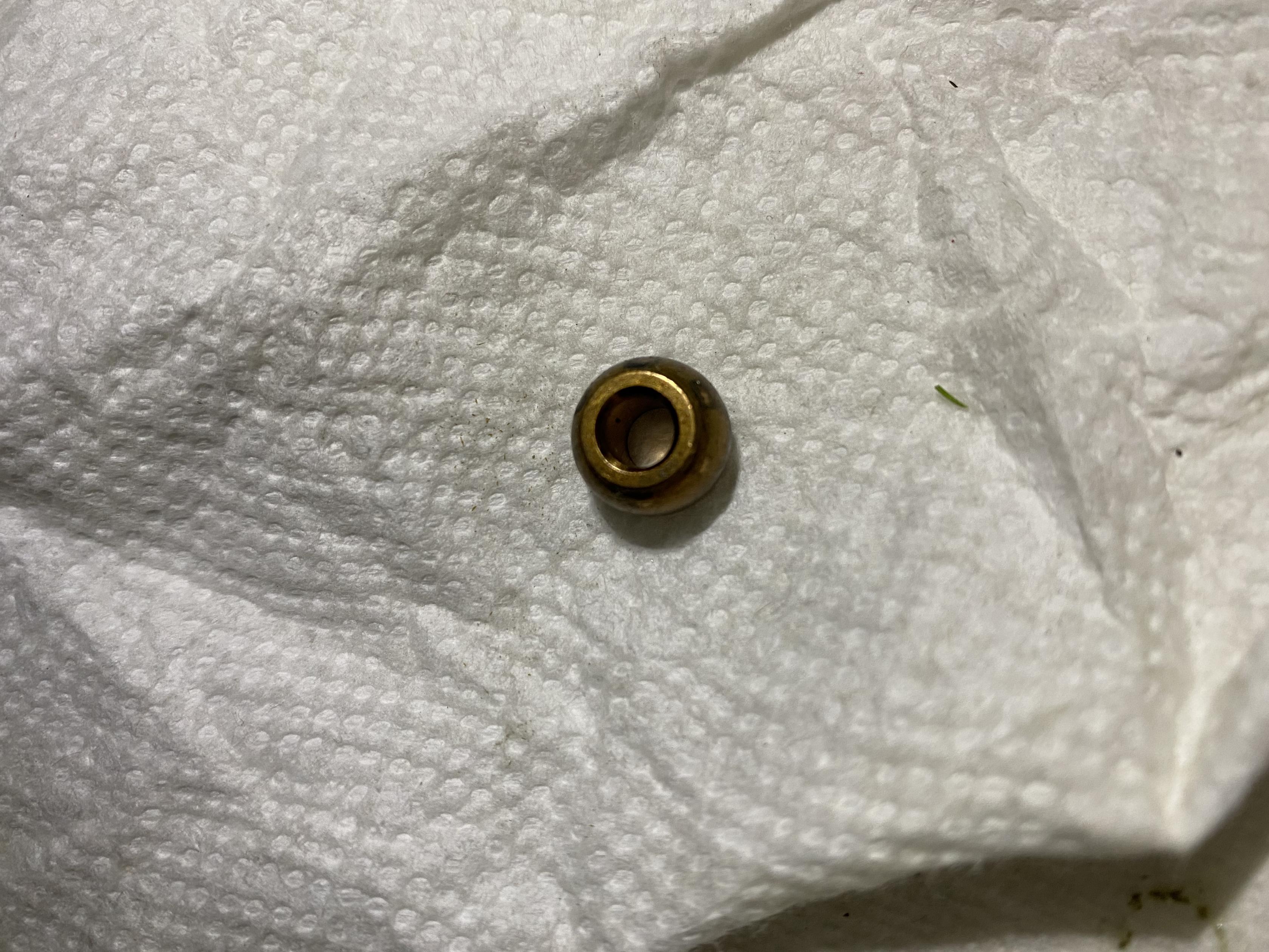

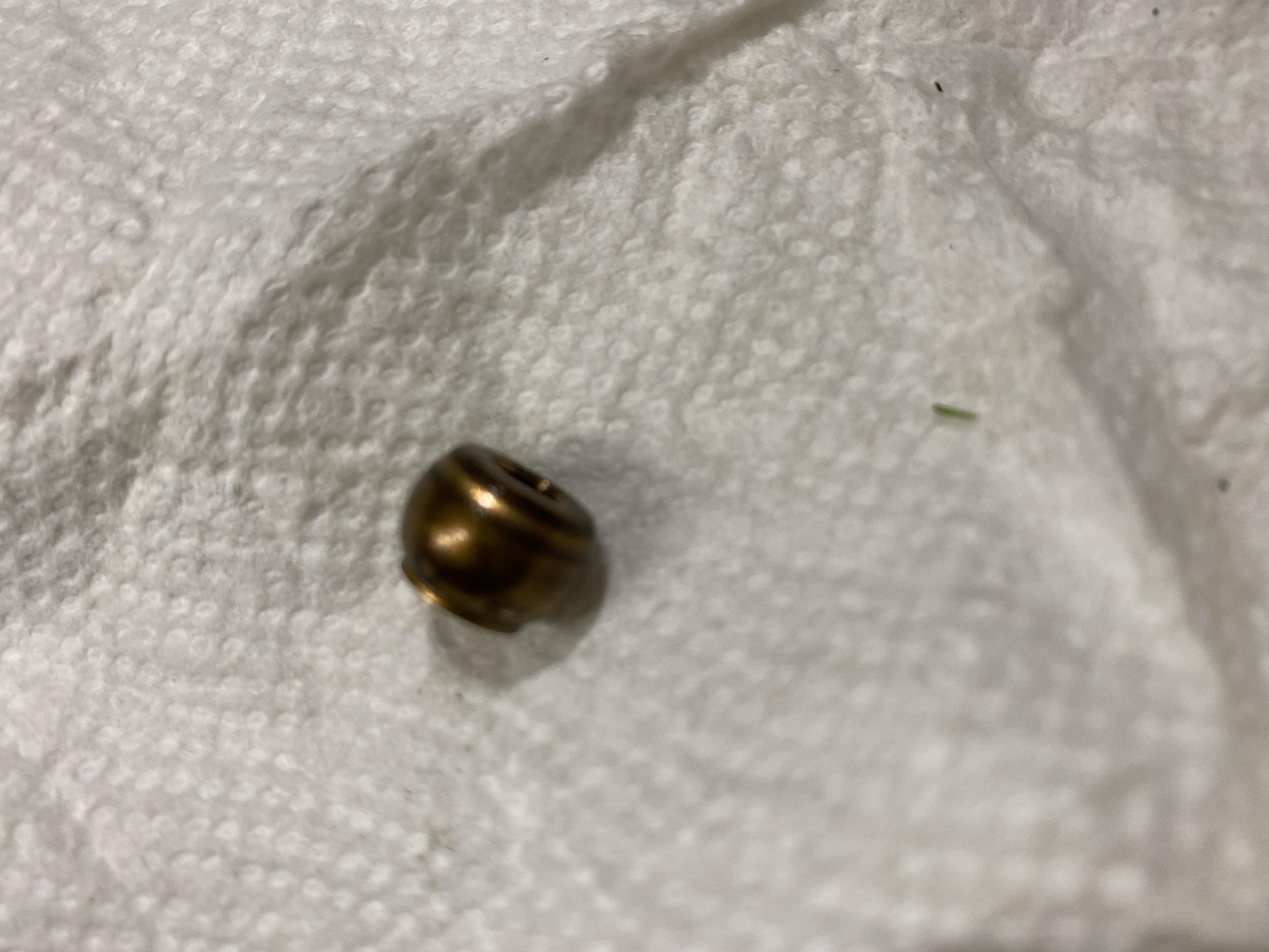

I was finally able to disassemble the motor, but I may have put my foot in it, so to speak. First, I started to clean out the bearing at the bottom of the shaft, using my soldering iron. Then I started to clean out the bearing at the top of the shaft. While trying to push a swab into the center, the bearing popped out. See photos attached. I do not know which way to orient it (it has a lip on one end) and I cannot figure out how to push it back in. There are little tabs that it rotates on that clearly suggest I have to push it in from the top (shown in photo 3, but it does not appear to fit through that hole. Photo 4 shows the spot for the bearing as seen from the bottom (inside) of the motor.
Any thoughts on how I can save this?
Thank you,
Jazzzman

The tabs seem to act as a spring lock
I would smear a liitle oil on the outside and push it in.
On the other hand, an excellent chance to lube the bearing properly has come.
It is really a sintered bush.... clean it, then let the solvent dry off.
Then soak in lube for 24 hours at least, that means submerged.
Then fit it.
This will give you a very long lube life.

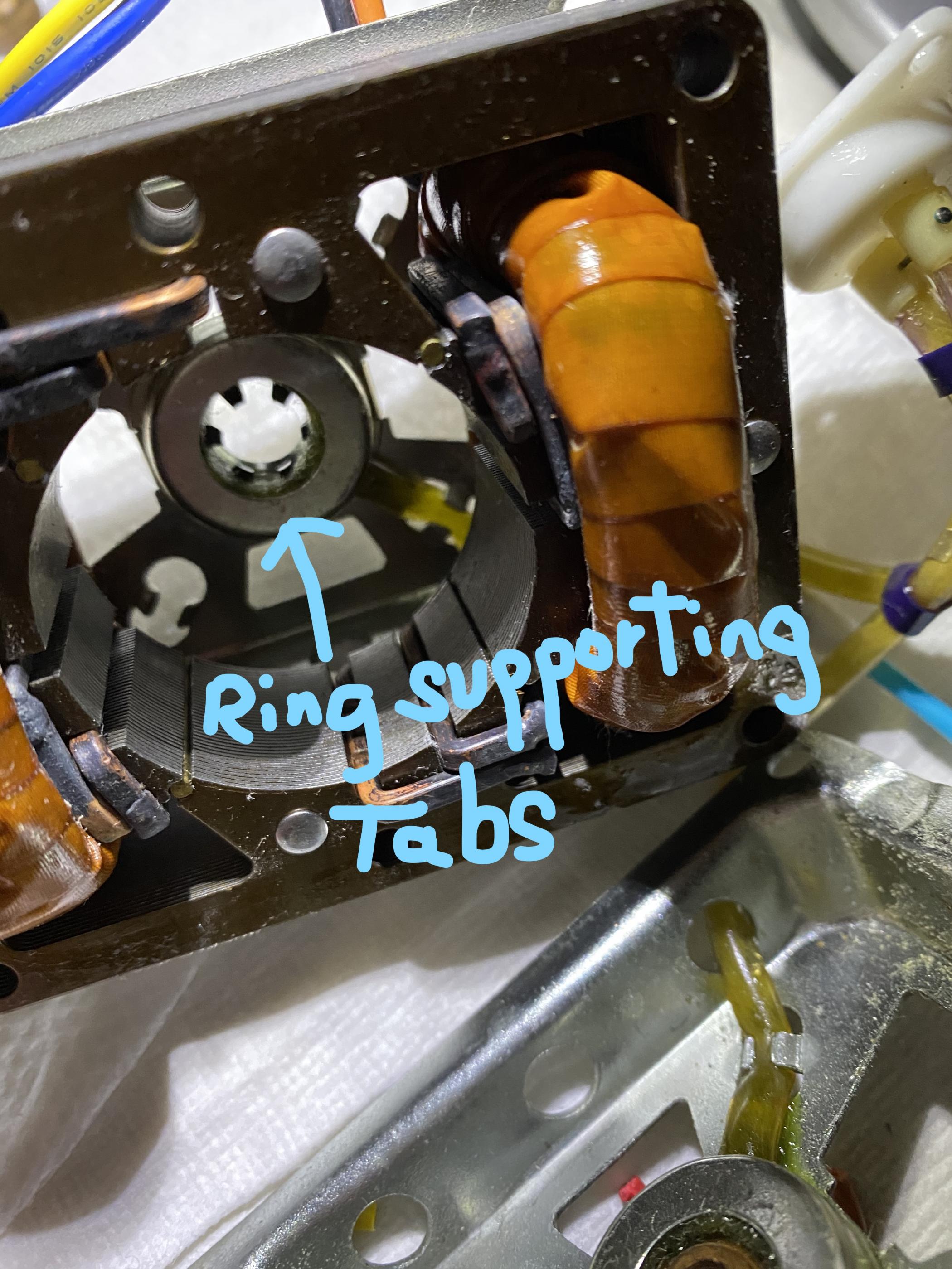

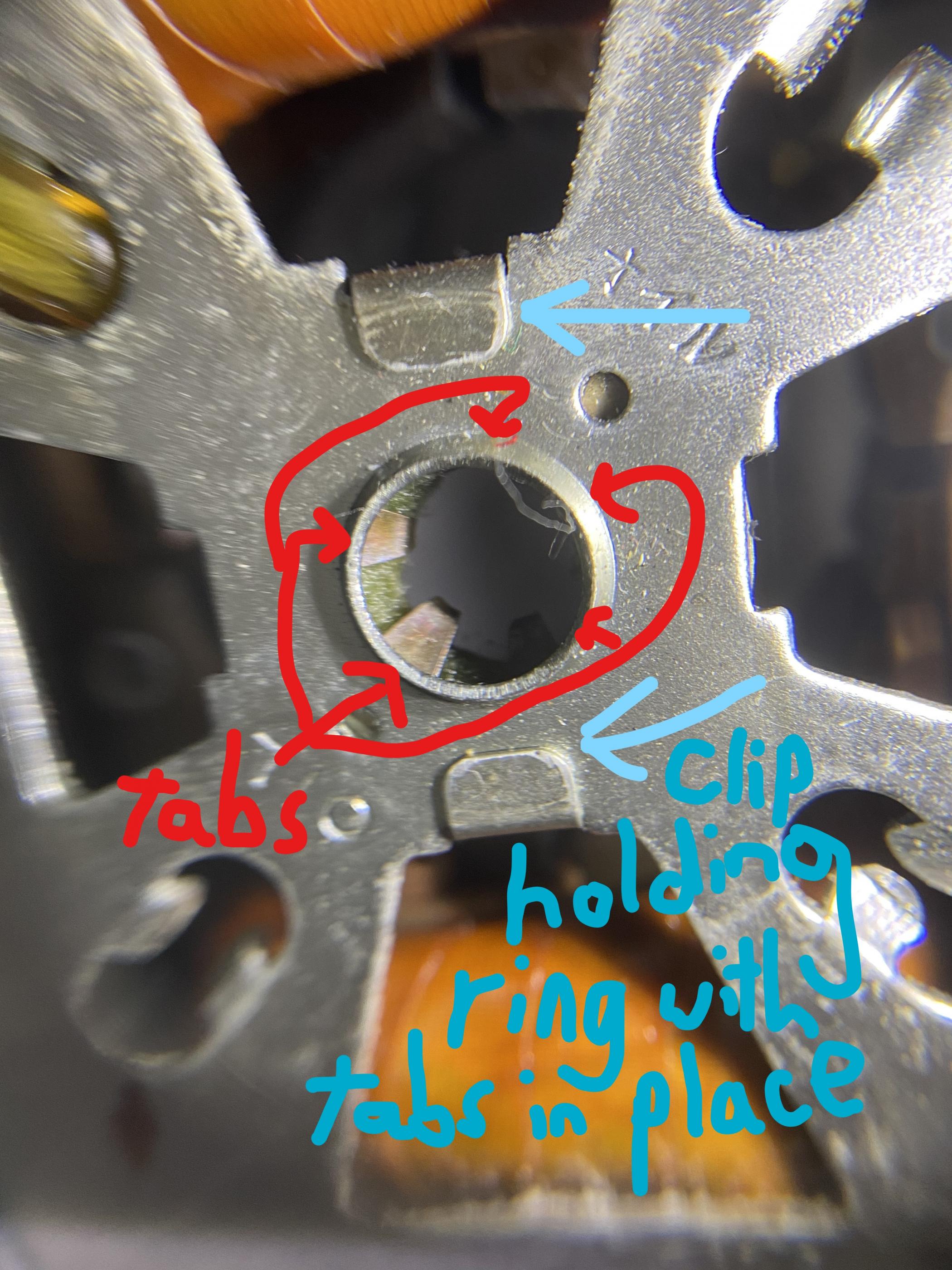

Well, I think I managed to clean the bottom bearing. But I cannot get the top bearing (bushing?) back into place. It is too large in diameter to fit through the top and underneath where there is enough room, there are tabs that the bearing (or bushing?) sits on when in place that do not allow it to pass. I was trying to remove the tabs by prying open the clips that are holding them in place, but I cannot get them to budge. Does anyone know of any way to get that bearing (bushing?) back in?
Thanks for any help anyone can give.
Wiseoldtech, you mentioned removing the bearings, how do you get them back in?
It looks like you will have to remove the supporting ring that supports the tabs.
Use a little WD40 or something to loosen up the ring a day or so before going in.
You will have to pry open the tabs, put the bush in place, and put the tabs back, tightening the support ring fron top by gently using a tiny vise or a soft hammer after the shaft is in place.
The tabs may be soft or brittle, and the whole thing has not been disturbed for decades. Be utterly careful.
But how did the bush come out?
You were doing something and it just came out?

I'm sorry that you took it to mean removing the bearings from the end housings.
I did not imply or suggest to do that.
Because of that, you now have another mess on your hands.
Cooking the bearings to cause the old oil out was to be done while they are IN the end housings - as I've always done it.
I keep things simple, I don't need the extra work that you now have to enjoy.
I was trying to clean it with a solvent soaked swab and it popped out. I must have been pushing down on it from above. I should have tried from below.
It occurred to me that I might be able to use an index card rolled into a funnel to hold the tabs out (they are very flexible) and slide the bearing into place from below. I will let you know if it works.
