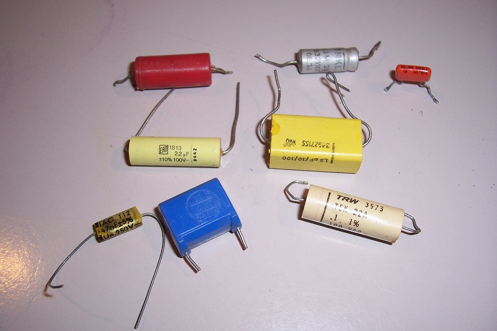

Out of curiosity, I made an informal test on a random selection of capacitors of various epochs and origins, and to my surprise, I found a relatively large number of mismarked caps.
I only tested the ones that were marked unambiguously, and I used a deterministic method.
Of those tested (several dozen), the majority was OK, but more than 10% were mismarked:
attachment.php
Not something I expected, especially from well-known and reputable manufacturers.
Morality: take nothing for granted.

This tester is completely automatic, deterministic, and does not rely on stray fields to operate:
ƑƠɭįƠ is a simplistic, yet automatic outer foil tester for capacitors
It is also inexpensive and requires only a single battery.
