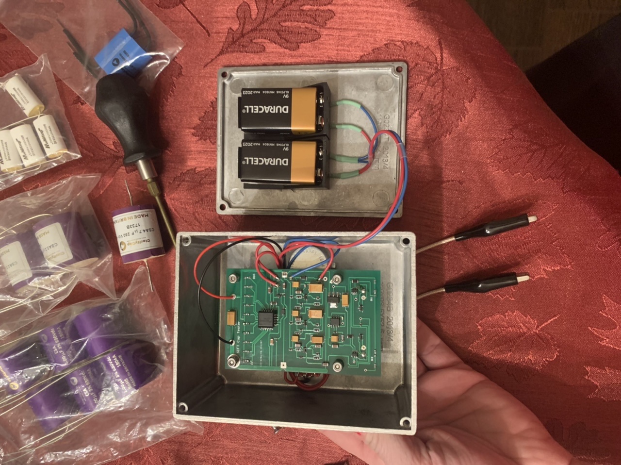

I’ve watched all the videos so I decided to make one because it doesn’t seem like there’s any product on that market that does this. I’m at the point where I ordered all the components and am waiting for them to come in.
Any thoughts on making one of these?

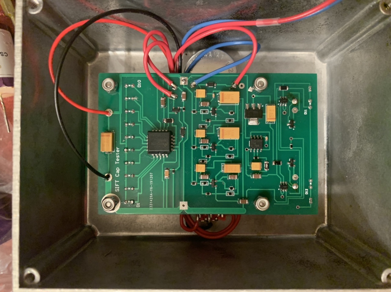

The only thing I did differently is I modeled the PCB in a CAD program as to get the PCB’s made professionally rather than etching my own. They’re due in today. I’m doing the complete unit so I don’t have to use my oscilloscope.

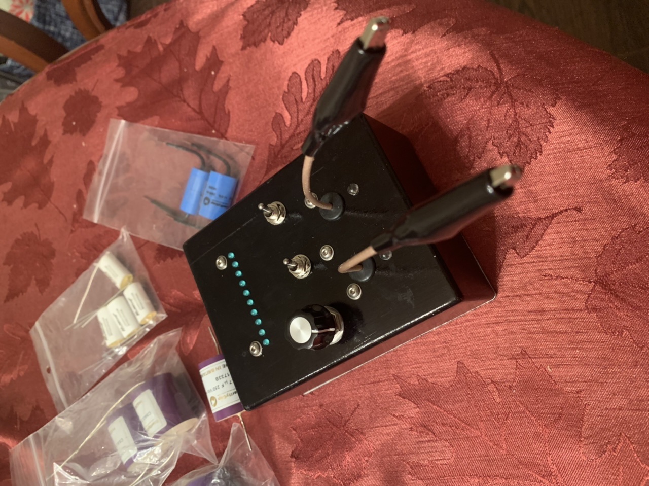

Here are a couple pics of my cap tester build. Seems to work pretty well.
