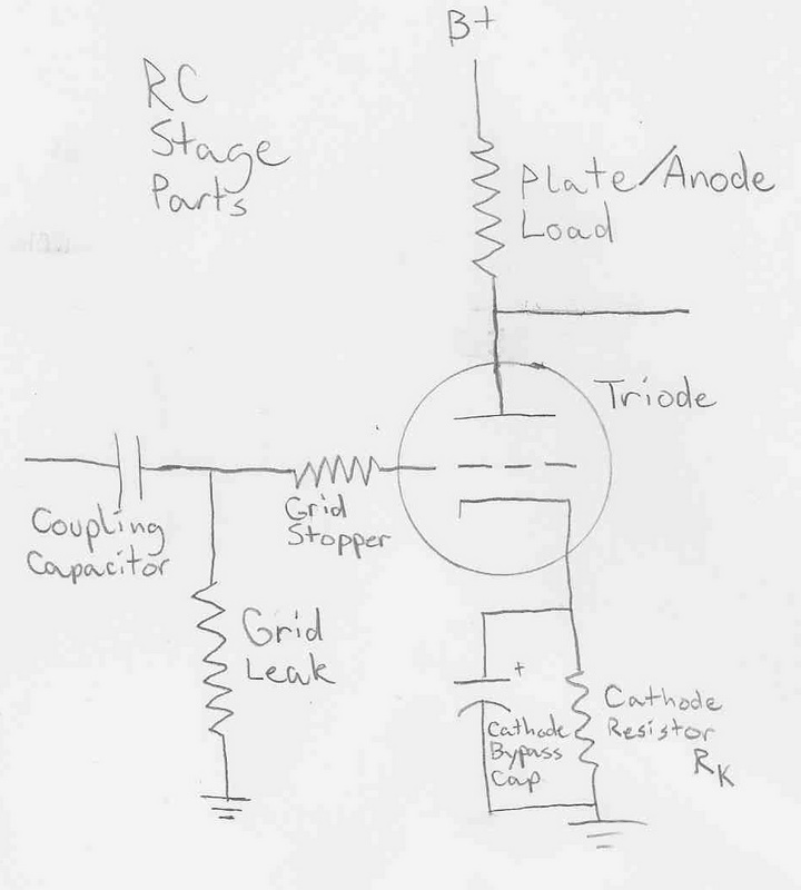

Use met. polypropylene caps over mylar (polyester), they are cheap enough.
Carbon comps are even noisier than carbon film. For lowest noise, replace the plate loads with wirewounds. For values between 10k-100k "NI" wirewounds are hard to beat in audio apps. Inductance is not an issue at these values, it becomes one as you go lower.
Metal film is a good choice in cathodes, carbon film may be "warmer".
Use carbon film or carbon comp for all grid stoppers.
Noise: carbon comp > carbon film > metal film > wirewound.
Metalized paper caps are for line apps and such, not signal. They are self healing and fail gracefully. Not to be confused with paper in oil (PIO) caps.
RC stage parts, the cathode bypass cap neednt be electrolytic, or even present.
2W metal film resistors are unlikely to sound much quieter than 2W carbon films, and carbon films generally sound "warmer"- so you may get the opposite of what you want! Carbon comp resistors can be quite noisy, but if they're in the 3rd/4th stage you should be ok. Wirewound resistors are great if you can afford it, but hardly necessary for a guitar amp.
As for caps, any poly type will do, although film types are preferred over metallized types. Teflon or polystyrene is the best, although polypropylene is more common. In a guitar amp you probably won't notice the difference though. Some people also like to add a ceramic cap in parallel with coupling caps, to give some high-freq texture.
I agree with Tweeker about cathode bypass caps- avoid electrolytics if you possibly can, and use non-polarized ones if you have to. However, in a guitar amp you can safely reduce the cathode bypass caps to 1uF or 2uF, thus allowing you to use poly-type caps. The lower value will really tighten up and smooth out the bass tone too!
You don't "need" to replace the PI components- that part of the circuit already has excellent signal-noise ratio.
No comments on the sound of one thing vs another, but regarding resistors in a tube amp, remember that resistors have a maximum voltage rating, regardless of value. Power rating isn't the only consideration. They also need to be derated in high temp applications. For metal films, I prefer the larger RN70 or equivalent types. Note that flameproof metal oxide resistors are very appealing until you find out how non-linear they can be with voltage. Though my favorite cap is polystyrene, remember the maximum temperature rating is very low for a tube amp- I'd stick with polypropylene or polyester.
