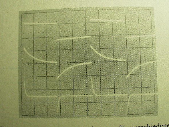

As my hand clap test has been quite a time ago and because I couldn`t remember well anymore, I have repeated my hand clap experiment today with a Sennheiser condenser measurement mic. with preamp and a small scope and guess what ... sometimes I can get two cycles of an even almost perfect square with about 1ms flat top and bottom of the waveform. It´s really a pity that my other Tek scope with storage capabilities do not work at present otherwise I could have presented You a nice screen shot from the waveform.
I always had the impression that applause is particular difficult to reproduce naturally sounding by speakers. Mostly it sound like rain drops on sheet metal roof but never really like what it should.
Anybody here ever made similar experiance?
Bill: :up:
I highly appriciate Your efforts for the "Square Wave Project" and for sure I`ll follow this very closely and try to contribute where I can!
Your active bandpass setup is a very good idea but I guess the output is predictable and it will look pretty similar to the center waveform shown at the pic. below unless the rising (and falling) edge of the wave will not be so fast due to the 20kHz lowpass (the rise time can be calculated but I`m to lazy to grab the formulas now).
Though this wave at the first glance does not look like a perfect square wave at all, we could be more than happy if we were to achieve this as ouput from a real life speaker only to some extend. To stay realistic I think more than this we can not ask for but it would be already much better than usual speaker outputs.
Eric:
of course You`re right that unless an explosion or something like that there is no acoustical sensation that can maintain constant sound pressure for substantial periods.
But the hand clap test proofs that there is for shorter periods and maybe we find more examples.

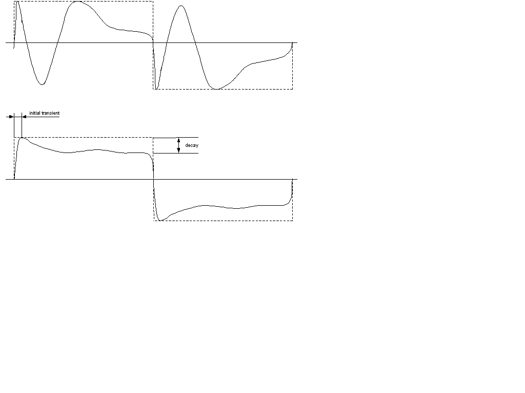

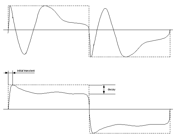

Hi all
Before someone else joins in just to tell us that in real life neither a speaker will ever be able to reproduce a squarewave nor would real sqarewaves exist :
=> I assume everybody agrees on both !
But we have to agree as well, how a realistic squarewave-response of a loudspeaker should look like.
I enclosed a drawing with two diagrams:
The upper one shows how an ordinary speaker (more than 95% of the speakers out there) would reproduce a squarewave: It is simply the lineup of the different driver's step responses.
The second one shows what could be achieved with good engineering: An initial transient that isn't infinitely steep due to the finite upper cutoff frequency, but which could be made reasonably steep though. Due to the fact that the speaker doesn't go down to DC there is also decay following the transient, which is smaller the lower the LF cutoff frequency and the higher the signal frequenciy is. There will also be some inevitable transinent ringing, interference etc.
But I think it is evident wich one represents a rectangular MORE ACCURATELY, isn't it ?
Regards
Charles

cocolino, youre handclapping is just a amplified clipping pre-amp 'sound'. You can't possibly make a constant linear increasing pressure-wave with your hands during no matter what time, cause that's what you need. Even if constant pressure during some period, membrane of mike wil tend to go back to rest position because of equalling pressure (result would be kind of triangle wave).
It is definetely not a clipped pre-amp. sound. The output of the mic.preamp is about 0,8V peak to peak which is far from its overdrive level.
Again: the scope has been set at the 500µs Time/div. range and under this conditions I was sometimes able (of course clapping hands can`t be done always equally) to get 1-2 cycles of a just nice looking square wave (around 10cm distance hands to mic).
I encourage everybody with access to a measurement mic. and a scope to try the same.
Of course the quality of the square is not like from a electronic square wave generator but the signal has very reasonable flat top and botton and in the 500µs/Time Div. range it looks indeed much more like a square than a triangle.

And I assume that most of us will agree that the shape of the wave must look like something what presented Charles above though IMHO the quite slow decay likely is a bit too optimistic assumption (supposed we use 30Hz square wave test signal according to Bill`s suggestion).
An ultrafast rise time, though desirable is not the first priority of the square wave approximation in this design.
Due to the reasons already mentioned namely that low frequency constant pressure waves don`t exist and additionally that our ears are less sensitive to perception of time distortion towards lower frequency, trying to extremely delaying the pressure drop decay also is not first priority IMHO.
The no.1 issue as I see it, is a as coherent and even as possible shape after the leading edge until a still to determine point after which further trying to maintain the pressure do not bring much more audible improvement.
