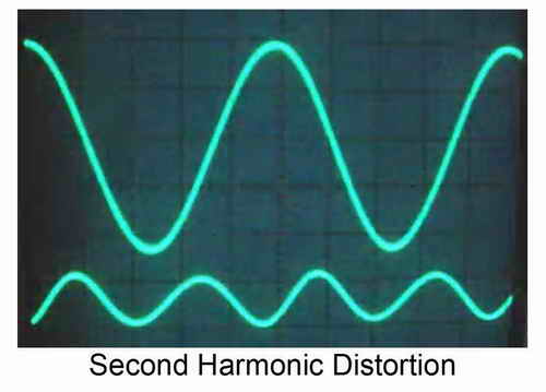

How can I get this picture on the scope? The upper is the basic sinewave, the lower is the distortion component, but they both appear at the same time at the same scope?

I guess not directly.
But how about this: Measuring three channel single sweep at 50 ms/div, and then zooming at the details without recapturing the signals to 200 µs/div 😎
lumanauw, I believe you'll need some kind of filter to pick up the desired distortion component(s) and eliminate the fundamental.
Janne
use an active T-notch filter -- this will give you THD+N -- to just get THD you need to count the magnitude of each harmonic -- which you can do in DSP -- design of such a filter can be found on Texas Instruments and Analog Devices websites.
fwiw -- the USB1208FS and Softwire (or other software packages) can do this pretty easily.
