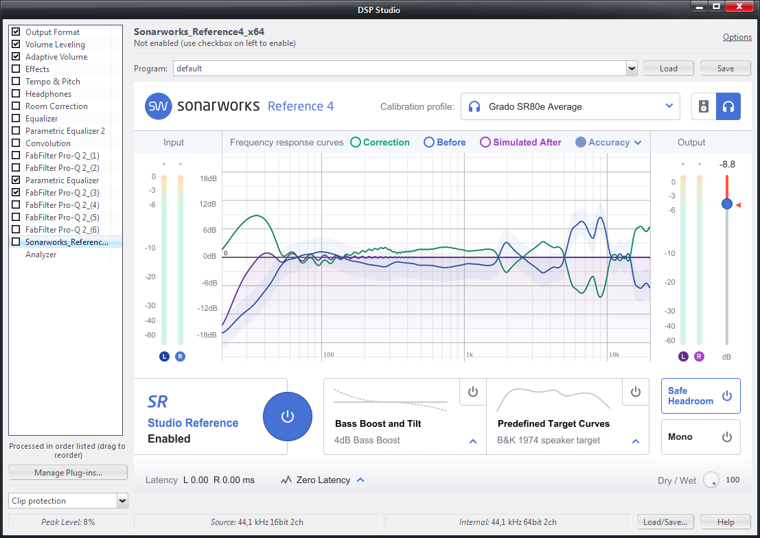

My headphones are the SR80. I found this test of the SR80e which shows the peak Pano mentioned and I can hear something very much like it using tones Grado SR80e Review - RTINGS.com
I found this test of the SR80 showing a much different response, swinging wildly between 3 and 4kHz, I'm not hearing that at all Headphone Review - GRADO SR80

Thanks. I'm going to have to get a real computer so I can fully participate in all the fun and games. That response doesn't look as bad. 10dB peak did seem a bit extreme

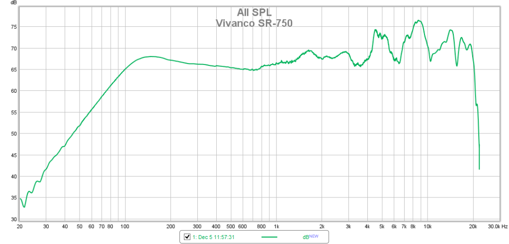

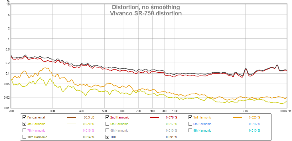

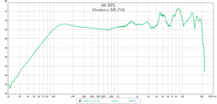

My attempt to measure headphones that I use for the tests is attached, it is a "free field like" measurement taken by a microphone placed several mm from headphones earpiece.
Distortion is quite low in middle frequencies.

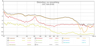

Contrary to the Vivanco, e.g. cheap JVC HA-S160, $20, have much higher distortion. I think it is clear that with headphones like this the sine test most probably would not pass. So it makes a basic difference which equipment is used.
