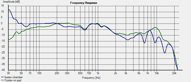

Yes I did, and I measured. It wasn't the active electronics, it's the headphones. Measuring my Fostex headphones shows they are down almost 10dB at 2K (relative to 1K) and that puts the distortion right at the edge of audibility. So I EQ'd them to a flatter response from 500 Hz to 5kHz. Now I can hear the H2.Did you ever consider your HDMI receiver was NOT sufficiently discriminating to hear such differences or is it your receiver that's at fault?
See results below. It was easy this time.

It was easy this time. With Grado SR80s, I might have got it right off. 🙂
This shows that FR of the playback is important in these tests. Now that my headphones are flatter, will I be able to tell the difference in the music files? I doubt it.

I see you don't state this but you used a Yamaha HT receiver via HDMI connection on the previous test with Fostex h/p & a Behringer UMC 204HD USB DAC here, presumably with USB with Grado h/p? Are you sure it is the change of h/p that's responsible for the discernible differences?
I did change sound cards, as seen in the log. I can test the Yamaha later. Same Fostex headphones, just with a flatter EQ.

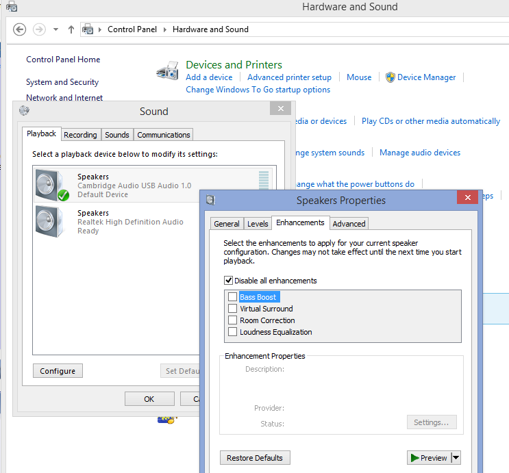

Wasapi plug-in for foobar must be downloaded
foobar2000: Components Repository - WASAPI output support
and installed to foobar. The sound card must enable wasapi and have the proper driver. Same applies to ASIO. Basic installation is usually only windows direct sound. Maybe the receiver even does not have an option of ASIO or WASAPI drivers.
What is WASAPI?
If your card does not support WASAPI or ASIO, please at least disable all enhancements in control panel. Otherwise windows would create dirty spectra.
OK, thanks. I figured I must be missing a plugin as I remembered seeing those option in a previous install. Don't know about the HDMI output, will see if it can be directed thru WASPI. My other soundcards have ASIO drivers.
