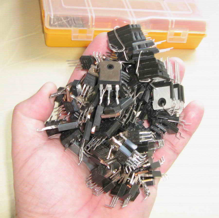

If I had a bunch of IRFP064 I would either sell them or use them in push-pull power supplies for 12V car amplifiers.
I have others... do not know what to make with them
A bunch of BUZ-11 (maybe 50 units)
A lot of IRF1405
Enormous quantity of FQP50N06
Some IRFP450 (this one seems to be famous)
Some FQA34N20
And IRF9530 (maybe 12 units)
Do you recognize some of those ones?

Re: I have others... do not know what to make with them
You can repair (or make) a lot of car audio amplifiers and 12V DC to 120/230V AC inverters with these parts 😀😀😀
You could do a 2x800W@4ohm class D amplifier with SMPS with those IRFP450 and FQA34N20 too, although this is quite challenging (even for me because these parts are a bit dated and don't perform as good as latest generation ones).

Thank you Lumanauw... the Aleph is executable
Eva
I am not able to produce Switching supplies...i am very stupid related those things.
When i hold Fets i feel they can bite me, i do not even know if they are "animal" or "vegetable"
Thank you, but i feel will be very hard to use those folks.... i am not addicted because i have not knowledge...or...i have not knowledge because not addicted to them...i believe into the second option.
I will search for local friens to make some negotiation with them..they can give me BGTs and i can supply them with Fets.

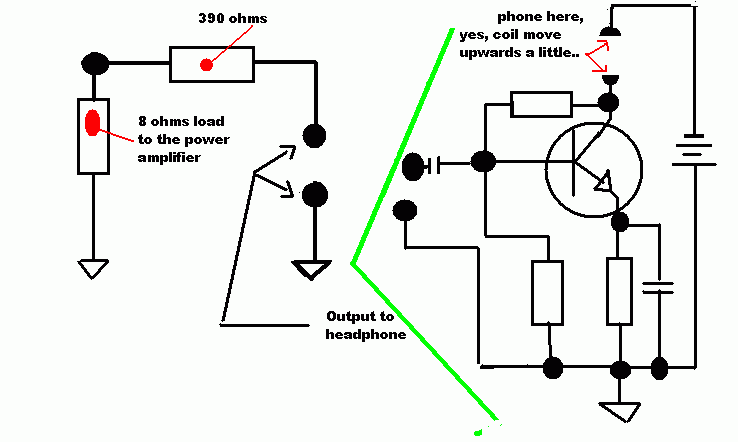

Negative dear nephew.... headphone i use coupled into the amplifier output... i make
it loaded by 8 ohms and them i pick a resistance in series with the headphone..only passive!.. nothing to create distortions....no amplifier to me.... i do not use them...no pre amplifier and no headphone amplifier.
But i thank you by the nice intention...but i am running out from more stages to kill my sonics.
One stage is all i want when needing some headphone low impedance buffer, or impedance adapting stage....but unfortunattelly do not produce high power....i mean...one transistor each channel only....class A and headphone in series with the colector...this is the best i could listen ever.
Was a 1976 Senheiser headphone that used microphone cartridges as drivers to sound... impedance was around 400 ohms...i have made an amplifier powered using 9 volts batteries, one BC109 each channel (low noise, general use..standard..alike 2SC945.... now a days 2SC1815) with the headphone coil in series with the colector, class A and sounding wonderfull...i could not listen better sound alike that one i have listened down the seventies...audio came from an Akai open reel... Demonstration tape, stereo demonstration, having trains, Russian Roulet and things alike.... headphone output from Akai into this single transistor stage.
I am still searching for that quality i have lost there.... no noise... the open reel had Dolby noise reduction.
Yeah..it is possible that listening again i perceive that thing awfull compared to now a days standards, but i doubt that, because we had ever the real sound as reference to evaluate fidelity.

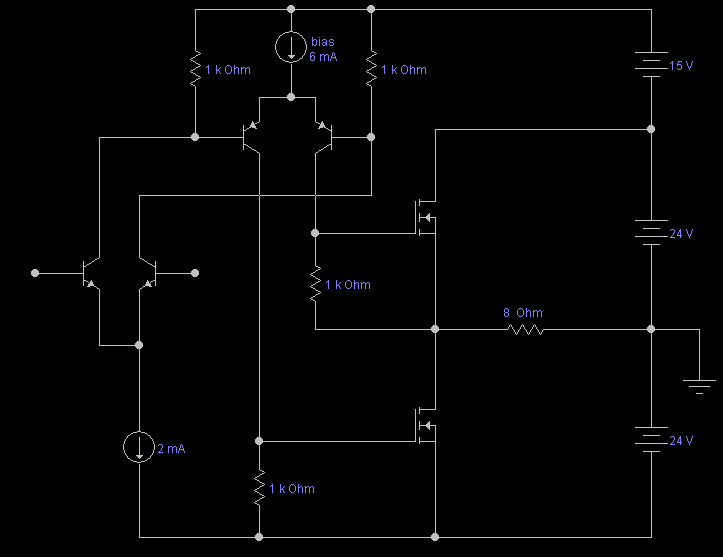

MOSFET may either operate as voltage controlled resistors or as voltage controlled current sources, it depends on the currents and voltages involved.
With some effort you could learn other technologies. We usually set our own limits.
Anyway, I'm going to propose you a simple N-channel MOSFET rail-to-rail output topology, see the attachment 😀
Thank you Eva.... maybe better to start new technology with simple things
24 plus 24 will produce some work to me.... i understand that you use to do to automobile and trucks,... so... 24 volts batteries are available there.
I will have to use power regulators to reduce the voltage...but i can do it... because i have them assembled.
Of course... if 36 volts would be better to me....i have wonderfull supply..with huge capacitance (40000uf each rail) to face class A units too.... and if needed.
The input and feedback, can you please complete those parts...i know they are optional..but what is your option?

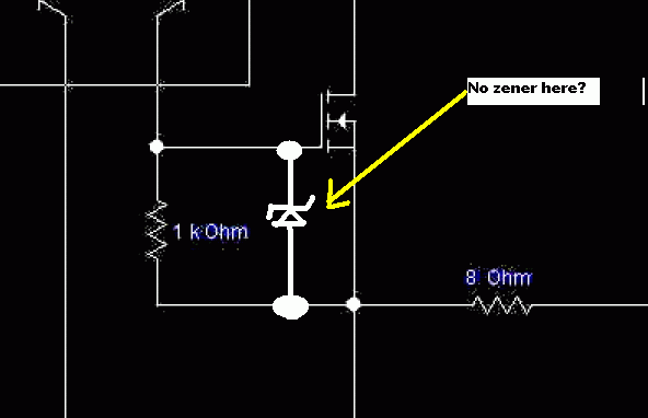

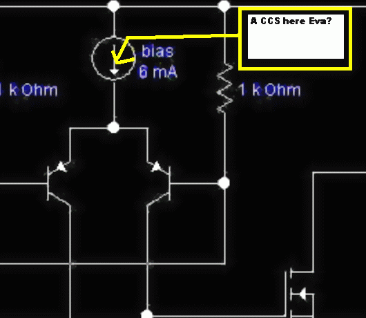

The schematic is purely conceptual, you should use whatever supply voltage that your transistors can handle, and you will have to add more parts (like the gate zeners) to get it working right. For example you could make low-part-count single-supply bridged amplifiers with all those low voltage high current MOSFETs.
The source with the "bias" label is actually an adjustable current source that is hand trimmed to set output bias current and is also controlled by heatsink temperature to compensate for changes in MOSFET Vgs "turn-on" threshold (similar to Vbe in bipolars).
It works like the Vbe multiplier in a traditional class AB emitter follower output stage. If heatsink becomes hotter, the current is reduced and Vgs becomes lower, and vice-versa. The proper slope has to be found by experimentation.
This may be achieved by coupling the current source main transistor (or diodes) to the heatsink very close to the output transistors, like a good old Vbe multiplier.
Vgs drift with themperature for HEXFETs is around -8mV/ºC but it changes depending on MOSFET model.
I can't give you much more help than this, I'm sorry but I'm really busy with projects.
Was already kind enougth..thank you Eva
It is registered into the thread, all data saved... i will study and simulate in advance to construct.
