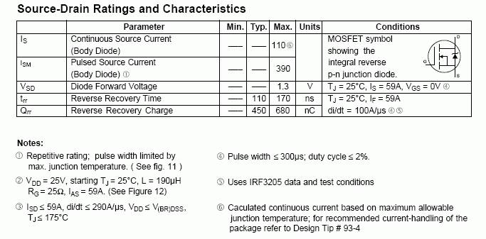

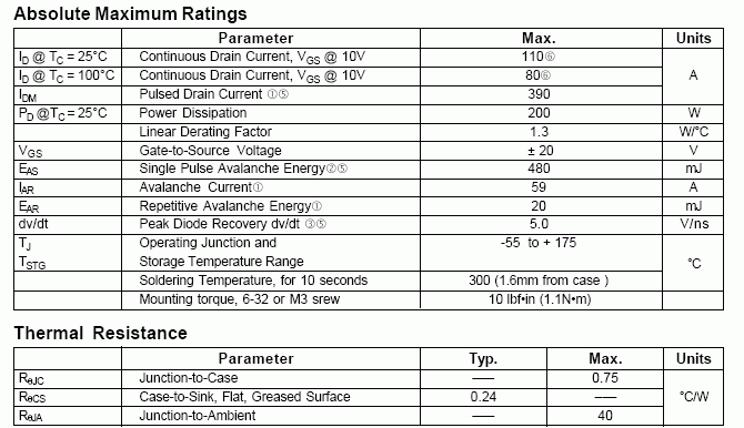

Was a gift from a forum friend, Dudainc... and now i want to put those ones to play
I have many... would like to use them into output, having transistors into the other stages.

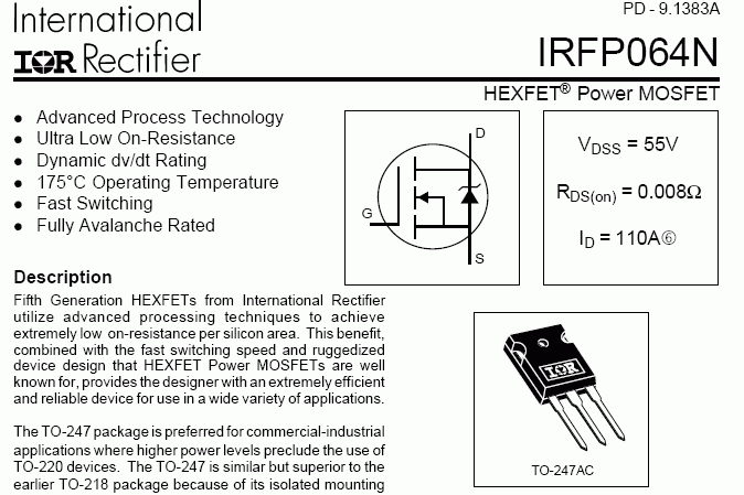

This MOSFET has really a lot of capacitance and needs a hard drive... and maybe it is quite non-linear at reasonable currents (note that the curves start in the 10A region) -- there are chances it will not be good for audio. But one would certainly need to try it, so go ahead...
I once used a somewhat similar monster, the IRFP2907, in a power supply (as a cap multiplier), where it perfomed well. No audio application, though.

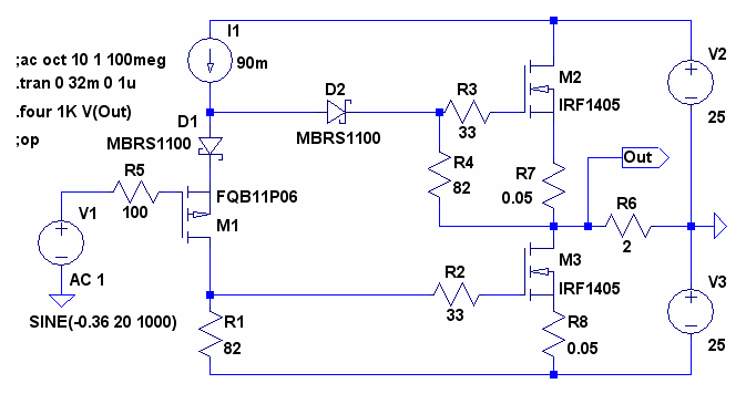

Hi Carlos,
my O/S configuration would work well with these devices. You can build a single 50V supply bridge amp, capable of 100W into 8 Ohm, 200W into 4 and happily delivering 400W into 2 Ohm load. If you only need it for a subwoofer, than it can be quite simple as you don't need a lot of speed. However it is also possible to build a good full-range amp with these devices. A simplified circuit I've simulated using somewhat similar size FETs (IRF1405) for the output, set for 600mA idle (15W dissipation on each transistor) shows about 0.07% THD at 1 kHz, 40V p-p into 4 Ohm and 0.1% into 2 Ohm.

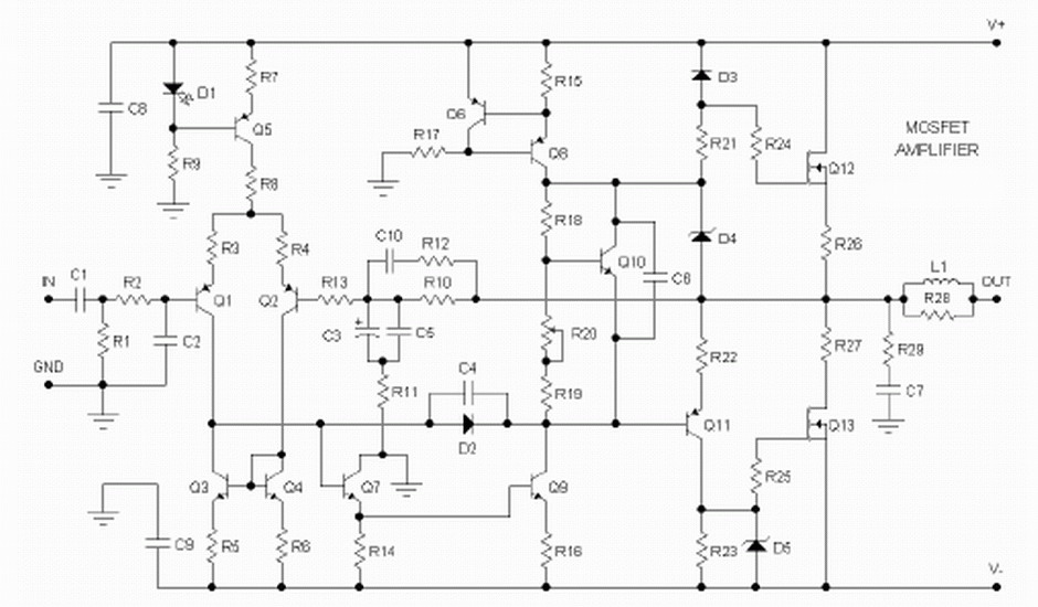

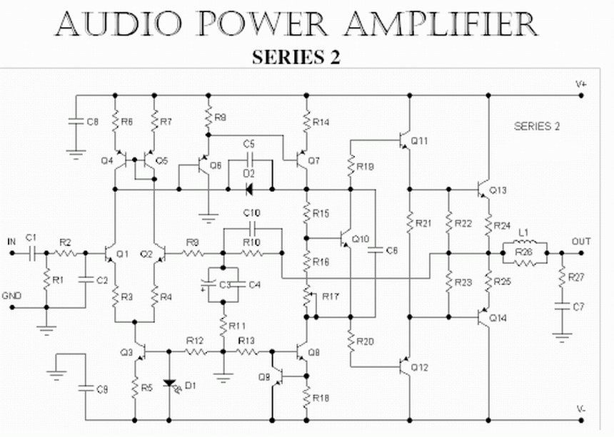

I don't know anything about its suitability to your FETs, Carlos, but this one suits your request for all-BJT front-end and has Quasi-complementary FET outputs. And is VERY well respected for its sound.
http://www.adam.com.au/cgpap/QuasiWeb/index.htm

Thank you Todd.... i have constructed quasi amplifiers..he is a good friend
and an excelent designer.
I would like to produce some different schematic...you know.... we love new things, different ideas, sligthly different schematics, to listen, to evaluate, to understand more, to learn more.
New ones are more pleasant than build, once again, some of Quasi amplifiers.... i made many amplifier from Quasi
I will build this one RAJ have just sent me.

> we love new things, different ideas, ....
Is that not also a quasi, a la Linsley Hoood Class A with the phase splitter ?
If you really want to build something different, try a circlotron.
Done it twice, love it to bits .....

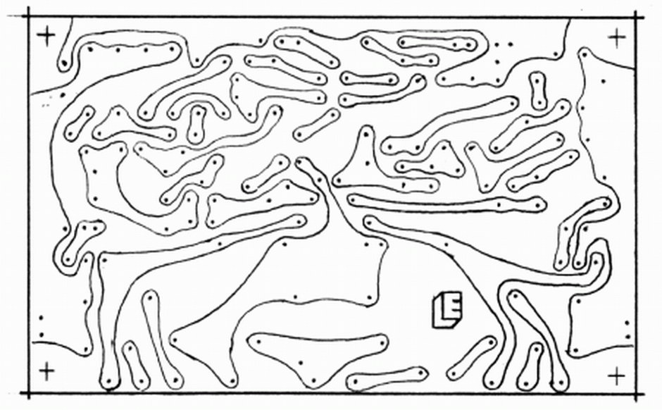

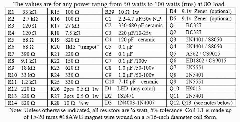

Here you have the board
I have not parts list for this one...if you are interested, search for RAJ into the forum and ask him by the part's list.
Raj will go to travel to Singapore today.... so...needing to find him, wait a couple of days when he wil be back home.
I will build the old version.... if approved, then i will update it
regards,
Carlos
