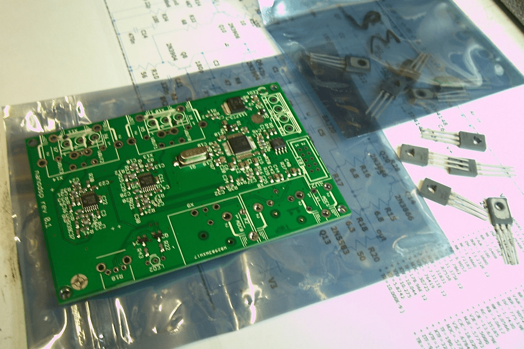

Today, I have received a nice little parcel:
Not only did it contain 5 pairs of BFQ, but a board named "nanoDSP" was also included.
Koen, you have some explaining to do!
Thanks a lot for generosity anyway.
Now, I will need to graft these racing beasts into my amplifier: due to their higher speed, the stabilization measures will probably have to be adapted

the nanodsp is a project I once did, I have a whole box of boards made, equally collecting dust like the BFQ's. pls give me yr email adress, and I send you the doc package how to built a project with that. for example 2CH XO balanced in balanced out with limiters and EQ etc. or stereo unbalanced XO 4ch out. there is room for rca in and out or XLR balanced in and out. 2 color led and volume control included.

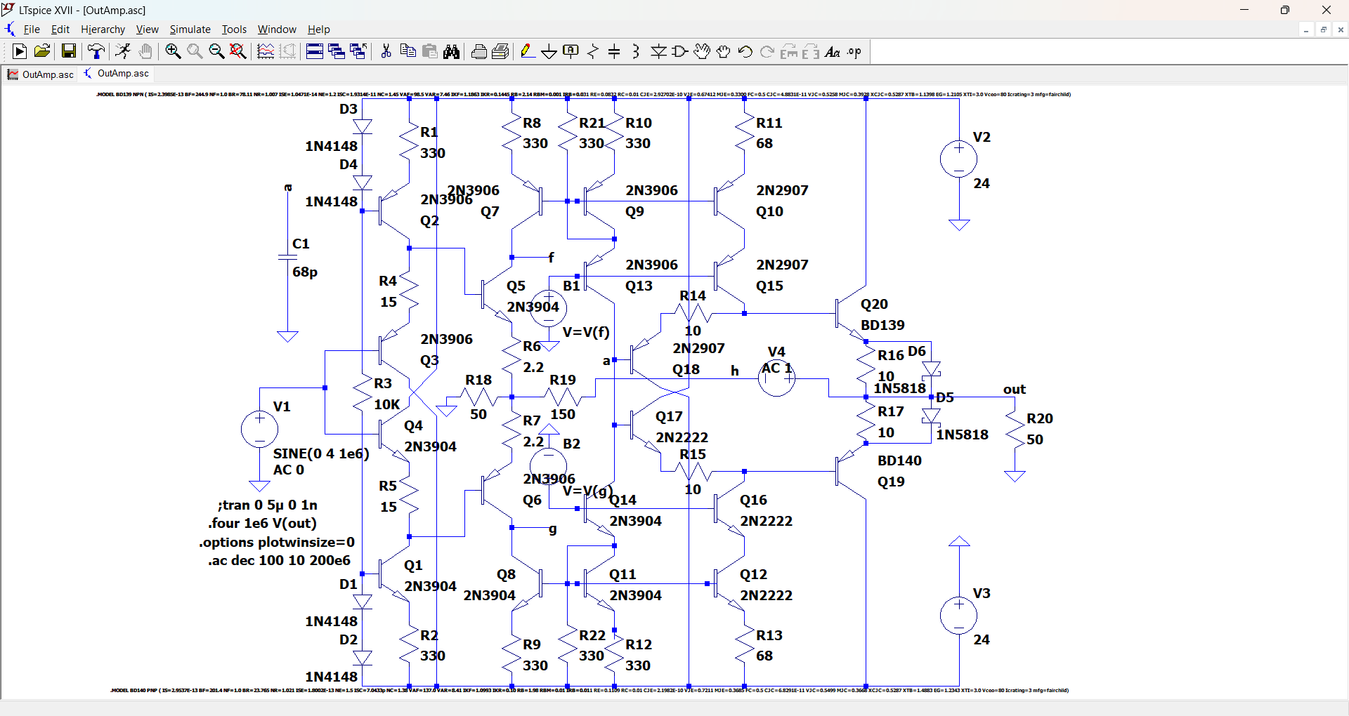

I haven't read the whole thread, but maybe underI am currently trying to design an amplifier for the output of a generator. It needs to work at up to 1MHz, and have a negligible distortion, ideally in the ppm range whilst delivering 30 to 40Vpp.
This is my first tentative:
The THD is ~0.01% and there are cheats: spice sources used as ideal buffers, because the base currents of the transistors are too large and too distorted. Additional transistors would be required.
There is also a nasty, unexplained peak in the frequency response, in the region of 200MHz.

Is the mentioned peak immediately in left of the falling edge near on ft of the whole amp stage ? In real life or while CAD simulation (e. g. ORCAD) ?
If the character of the frequency response is similar to those red line from attachment (consequence of not correct MM cartridge loading) then the oscillation potential (ring ring) around 200MHz is very great due not good phase margin - go to
https://skills.microchip.com/introduction-to-operational-amplifiers/691882
As long it is only by simulation some experiments with base stopper resistors could help.
If this peak is only in real life, PCB-layout isn't good enough, because some parasitic and unwanted inductors and capacities are occur. I recall to an article in ELRAD (German issue) concerning optimize PCB layouts for that kind of amplifiers. Unfortunately I don't know the associated issue (month/year) but I think late 80s or early 90s. Main feature here was, that the copper tracks of both voltage rails and GND rail was as close as possible (and not - as often to observe - pos. rail at the top edge and neg. rail at the bottom edge.
The problems are now solved, and they were mostly caused by local instabilities. Abandoning output-inclusive compensation was also a factor. The squarewave response had always been clean, even when VHF oscillations were superimposed.
There are now stoppers everywhere, even in the collectors of the transistors. Most are probably superfluous, but now that I have landed on a stable design, I do not want to tinker again: it is not a commercial design, and it doesn't need to be streamlined by pruning useless components.

Indeed, but it didn't do the trick all by itself: in sim, the amplifier remained stable with OIC, and on my prototype I tried the conventional compensation without the other mods, and it remained unstable
