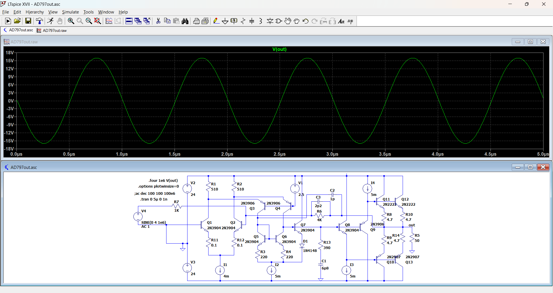

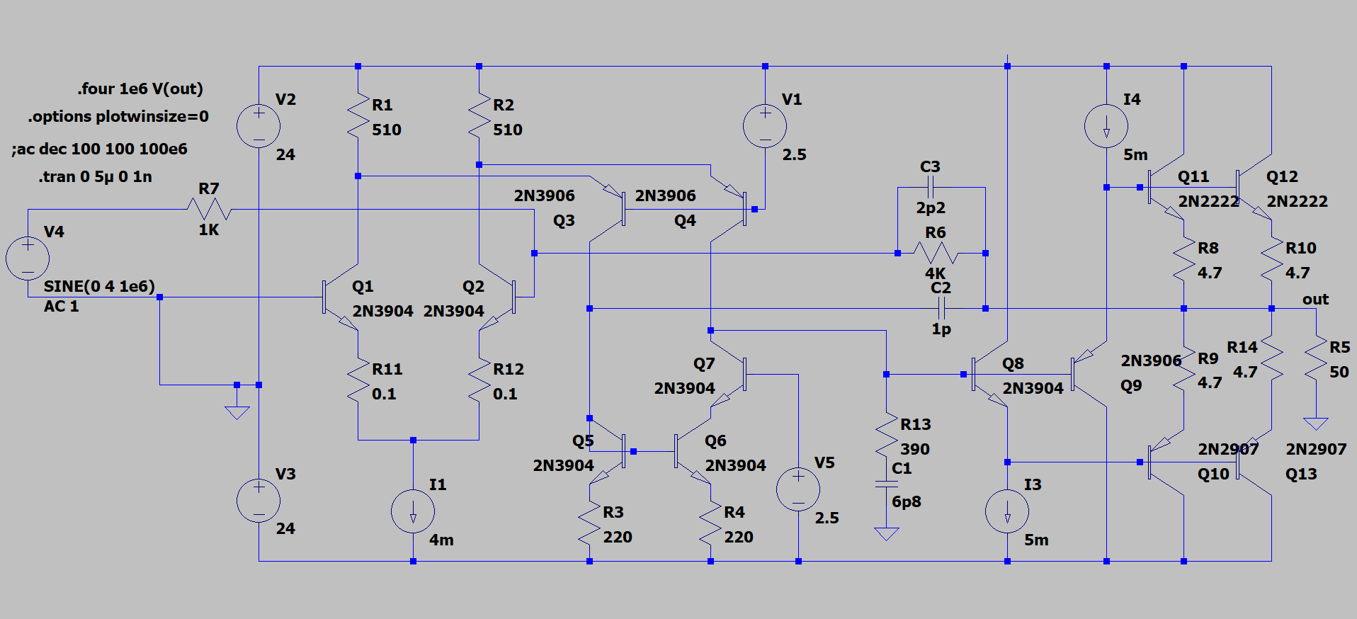

This is a first tentative, based on the AD797 topology. Components are mostly generic for the time being (sim).
It sort of works, but it is borderline regarding stability and slew-rate
Any comment?

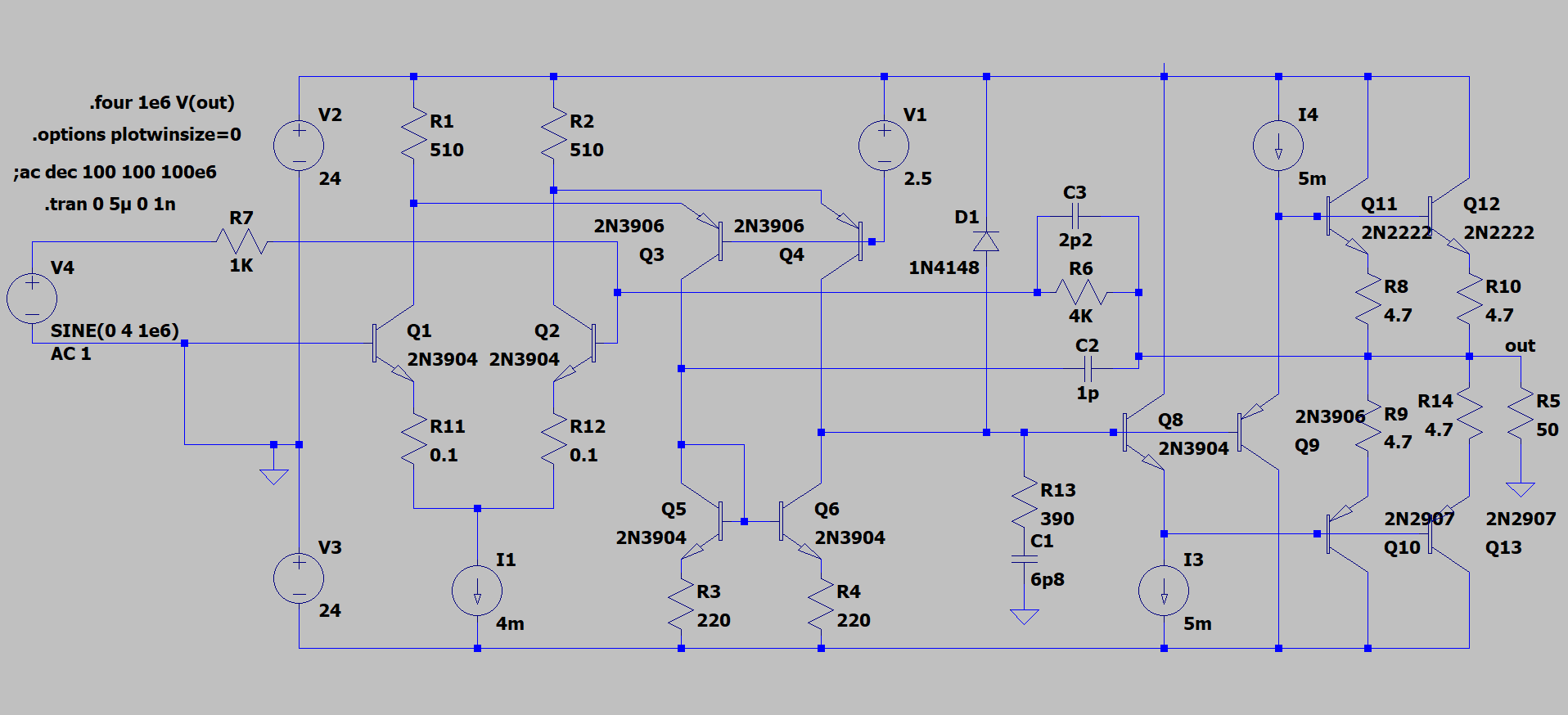

I don't understand what Q7+D1 are for, so I tried removing it. Initially, I left Q7 collector connected and the THD improved, but when I removed it completely, the THD is worse. I found that a 1p1 cap has a similar current value but undistorted, and the THD is not improved. Then I used a diode instead of the Q7 collector and the improvement is back. The diode current is obviously got a lot of 2nd harmonic distortion, which must be cancelling something else?
  • AD797not.asc
    AD797not.asc
Ya but the first transistor in the current mirror has a single diode voltage on the collector so sans the emitter diode they are "balanced". I would put another diode in series with the current mirror bases so that both current mirror transistors have two diode voltage on them. I know, I should test/ simulate the idea before I say anything. 😉 later maybe

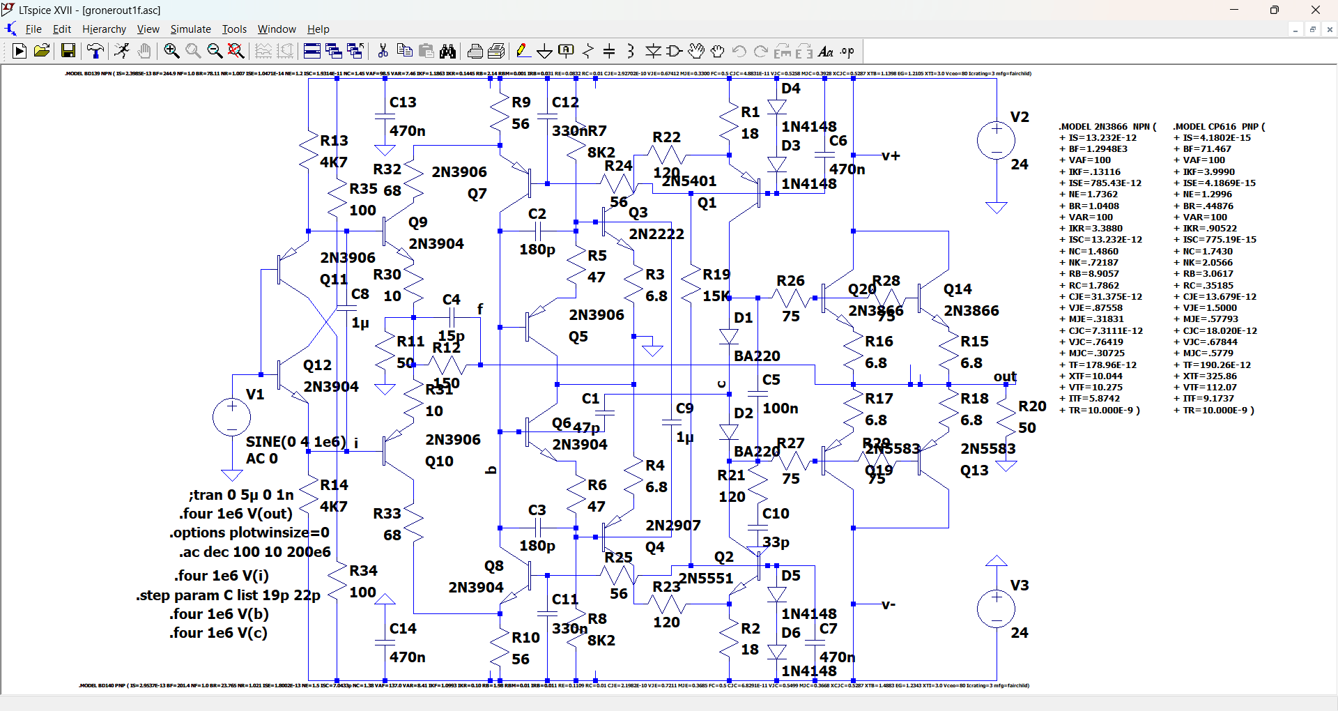

I finally managed to stabilize the amplifier, after adding layer upon layer of mods, stoppers, etc.
I don't know what exactly did it: stoppers, switching to non output inclusive compensation or other.
There are probably some mods that are totally irrelevant and others that collectively contribute to stability, but I am not going to investigate further as it would require to remove the mods one by one to determine which ones are really critical.
The stability is hard and strong: the squarewave response is immaculate, unlike the updated schematic:
A word about Q1 & Q2: the choice of 2N5551 and 2N5401 might seem strange, it would be more logical to use 2N2222 and 2N2907, but I noticed that the samples I had available (cheap Chinese types from Banggood) had half the collector capacitance of the Moto 2N's, and considering their location, it did matter.
As the dissipation was a bit excessive for TO92 devices, I designed a bespoke cooling clip to keep them safe
