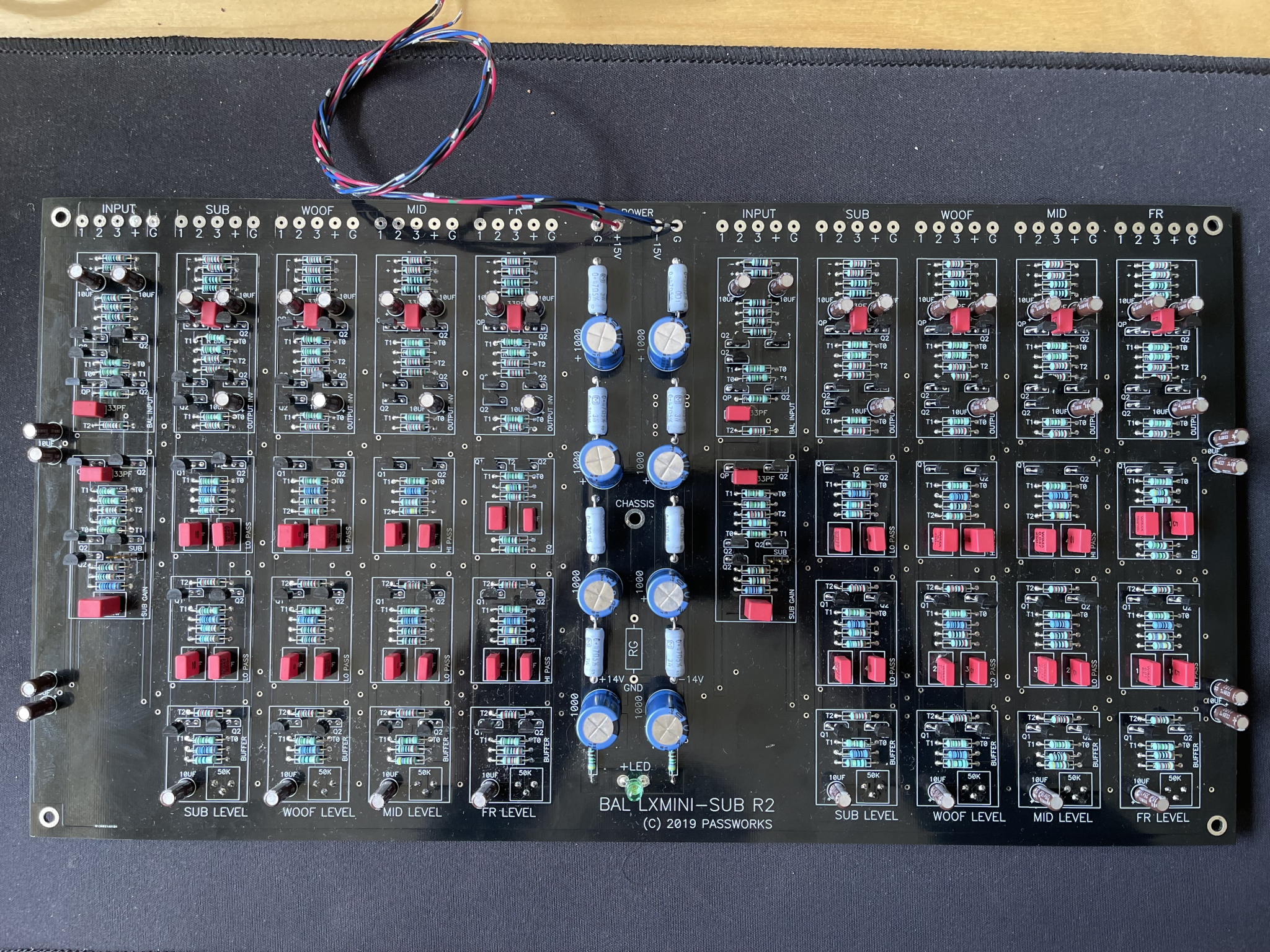

Need help in solving offset at T2 test points.
I purchased the matched JFETs and resistors from LinkWitz.store and completed assembling the board.
The voltages between the test points T0 and T1 show about 1.24v.
The voltage at T2 varies throughout the board. In the attached PDF, sections marked as BAL INPUT, OUTPUT INV, and SUB GAIN the voltage at point T2 varies between -100 mv to +200mv. In the sections marked as LO PASS, the voltage is around 2.4 volts; in all the other sections, the voltage is around 1.24 volts.
The SMPS output is +15.3v and -14.5v, after the power supply filter section where it is marked as - and + 14v, the voltages are +14.3 and -13.5 volts.
Frank confirmed the voltages at test point T1 look right and asked to check the component values for T2. I have measured all the resistors and checked the PCB a few times for dry solder, and shorts.
Any pointers would really help.
Hello @Nelson Pass, could you please suggest what could be wrong? I have been talking to Frank and he mentioned he never saw issues around T2 test points.
The interesting thing is, I am getting the exact incorrect voltage on both left and right at the positions I mentioned in my previous post. I have attached the picture of the assembled PCB.

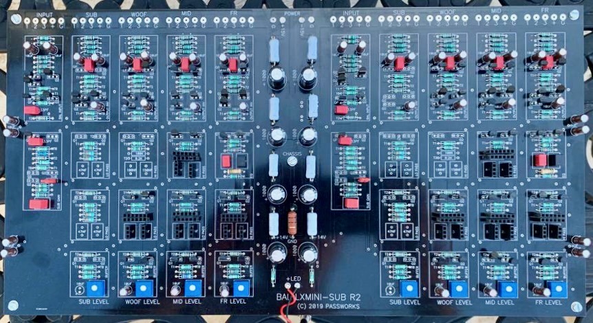

Hello Subbu and others -- I have attached a pic of my board. It's not a great pic and I can do close ups if needed. But the pic shows my overall progress thus far. I feel I am SO close, but need one bit of information to complete. Again I am adapting this crossover for use with my 3-way Spendors. So you can see in the pic the areas where I have mounted connectors so that I can easily change values of Cs and Rs to tweak crossover slopes if needed. I have determined the values of the Cs and Rs using the calculator that is online. The calculator identifies these as C1, C2, R1, R2 and which 'box' (i.e. MID Lo Pass or FR Hi Pass etc.) is known. The missing link is what positions within each box correspond to C1, C2, R1 and R2. Can anyone help?

You could take it upon yourself to trace out the circuit by examining the board and drawing the schematic. There are plenty of well documented and related crossover schematics that you can refer to for comparison. When you bought the board you made certain assumptions as to its applicability to your application. Rather than waiting for help that may or may not materialize, you could notch up your level of effort and figure it out.

Actually Frank contacted me and I gave him a response. The DC offset at T2 is not a real issue. The buffer circuits use a follower which has no Source resistor and those Jfets are run at currents lower than Idss, so they have a little offset which places a small DC bias on coupling caps. In the low pass filters this adds up but is not a significant issue as it is removed before the output.
Thank you for your inspiring character advice but I am a big boy and do have my big boy pants on. And have actually "taken upon myself" to reverse into a schematic by tracing the board. Not sure if you have even seen this board but I myself have never before "taken it upon myself" to try to trace a circuit this complex. And I have traced many a circuit in my long life (but I must admit never a fully balanced active preamp, usually tube amps, tube preamps or power supplies). So my bad, I will "notch up my effort" and I am sure if I can only overcome my character flaws all will be fine. No. Not really. You see, I did "notch up my effort" and still could not figure it out. So rather then banging their head against the wall, what to do? Smart people look for advice. Hence here we are. Oh and BTW I may be ignorant IRT this particular board, but I am not irresponsible, stupid or lazy.

In regards to what to do with the SUB & SUB Gain, don't do anything except not use them or get a SUB and use them. No harm will come either way.
As far as locating correct placement of components, in your case the low and high filter parts, I've already sent you the schematic for the filters, all you have to do is find the placement for C1 OR C2. Once you found one of them, the other is obvious. It will also make the placement for the resistors fall in your lap based on C1 and/or C2 location. By the way, every low pass and high pass filter parts location on the PCB is the same for every section (low, middle, high,SUB etc.).
As I hadn't heard from you since June, I figured you had this solved and were listening to music. You only have an hours worth of work to finish it, find a time when no one is around to bother you and go find WALDO (C1 or C2).

Knowing little about how commercial arrangements are made, you could be right, Nelson Pass does not have the information that would help, but he seemed to indicate that he does. I do know that Frank (at Linkwitz Audio) related some frustration that he could not get a schematic from Pass. And my board is prominently marked (C) 2019 Passworks. And I always thought that (C) indicates where the intellectual property is owned and resides.
Your info "...every low pass and high pass filter parts location on the PCB is the same for every section (low, middle, high, SUB etc.)" is very helpful. And thanks again for ALL your help and your encouragement. Hopefully my health issues will resolve. When they do I will persevere and will figure it out. Certainly not "waiting around" for Mr. Pass to follow thru as the presumptuous fellow above admonished me for doing. I know better, and actually have more important things to deal with.
