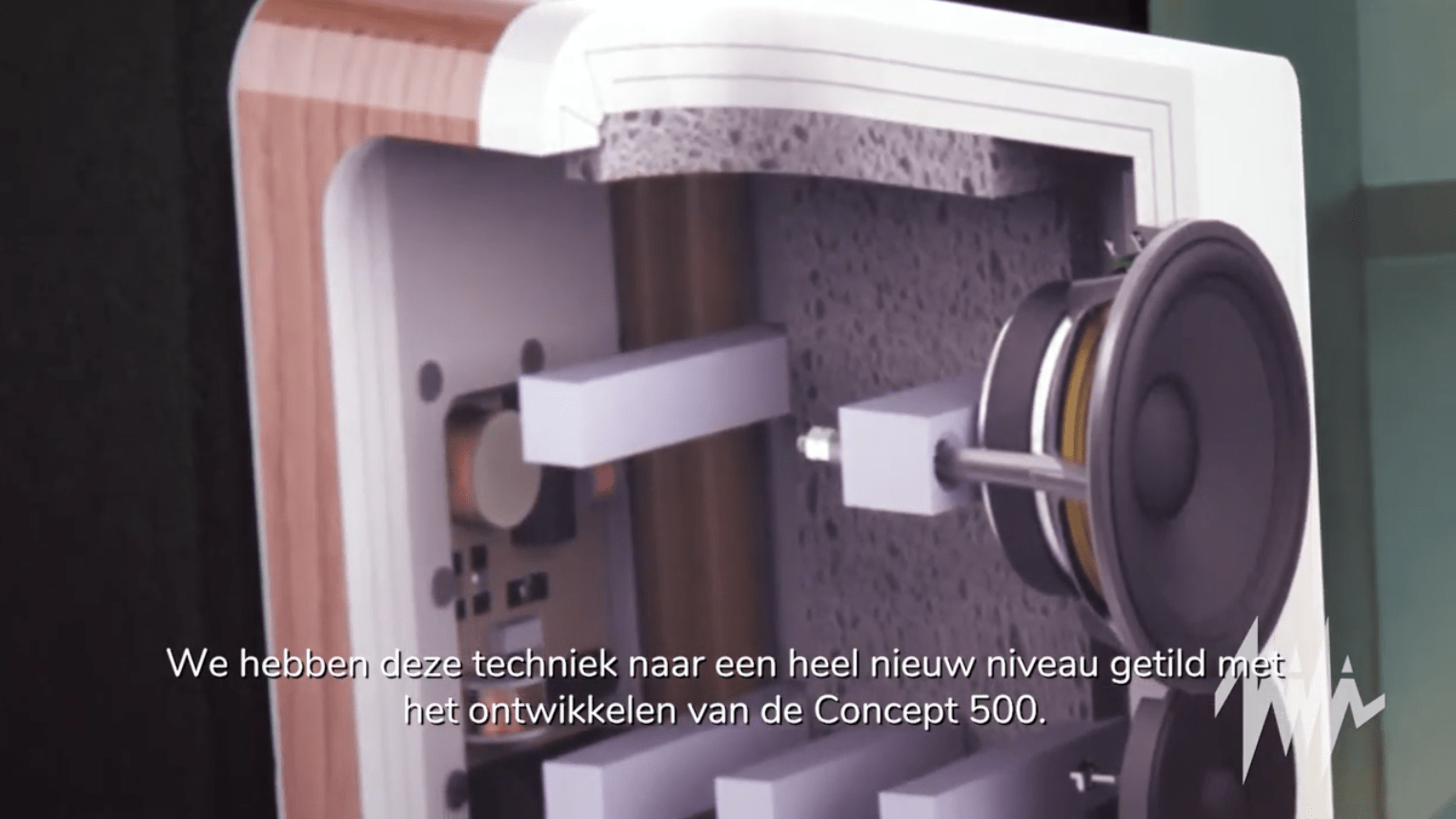

You already have three layers of damping: wooden something, bitumen and foam.
All three have different characteristics of damping.
If the bitumen is stuck to the cabinet, it will act as a brace.
There is little left to achieve here.
Furnishing foam, and duct insulation are made in different densities and materials, you can look them up and decide which is suitable.

ProAc's philosophy is not to use 'internal bracing' of the type you are considering.
By "extensively braced", I assume they are referring to the general construction (jointing etc.).
By the way impedance graphs looks like, very small appearing wrinkles at about 300/600Hz, might point to air resonances living there, so light volume filling with poly/wool wadding, while leaving original foam intact, could improve the sound a tiny bit.nah I’m just looking to make some incremental ‘ improvements’ if I can on a speaker I already like.
And each damps somethign different. The crap on the sides of the box damps the box walls (and lowers the potential resonance as well as broadening the Q), opposite of what bracing does. The foam damps the airspace.
The 2 are quite different tasks.
