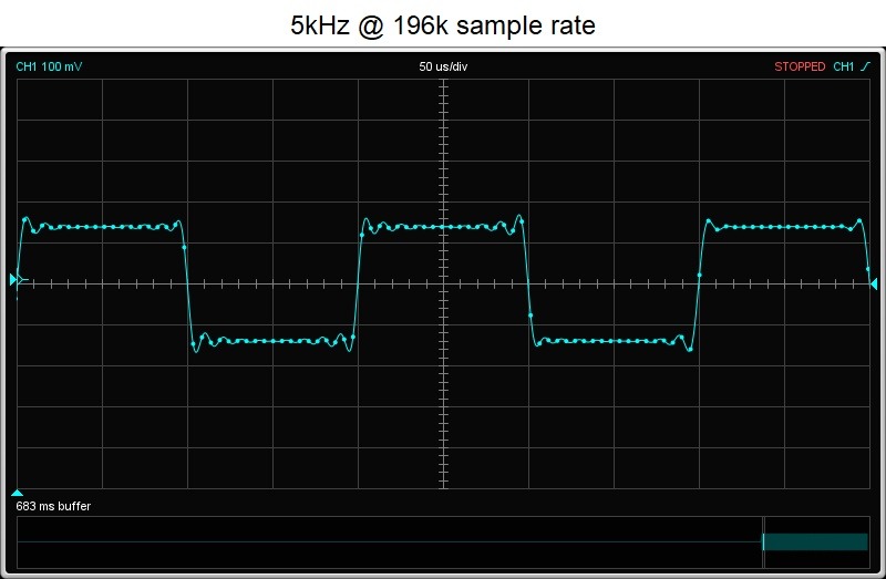

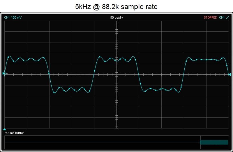

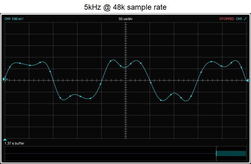

The bandwidth of the audio interface applied determines the reproduction of your 5kHz square wave. Your measurements clearly show the lowpass filter function of the measuring equipment I think. Try 192 or even 384 kHz, with appropriate analog circuitry.
Yes, the bandwidth or rather sample rate of the soundcard will limit reproduction.
Here's a 5kHz square wave taken at soundcard sample rates of 48k, 88.2k, and 196k. (as high as my soundcard goes (rme baby pro.)
5kHz  @ 48k sample rate.jpg 5kHz  @ 88.2k sample rate.jpg5kHz  @ 196k sample rate.jpg
Okay, that's the best my soundcard can do with the output from a 25mHz signal generator
I don't think a driver rolling off a 10kHz can produce any kind of even halfway looking 5kHz square wave.
