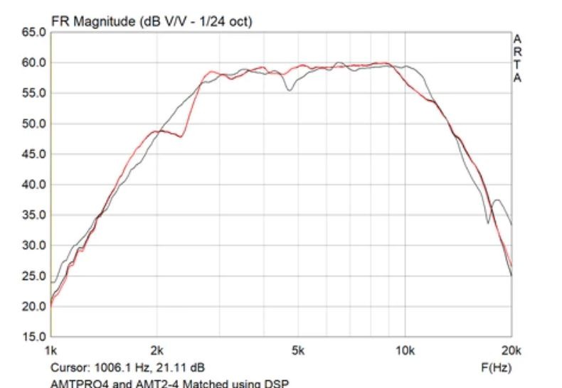

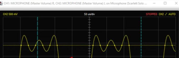

Hi Joseph, i really enjoy your blog posts, as you look for ways to dig deeper with measurements.It’s early in my testing and I don’t really have a test metric developed, if any. Regarding square wave, perhaps more sqaure looking? 🙂 I understand the bandwidth limitation is mostly affecting the square wave shape. But two drivers with matched responses should have identical square wave shapes no?
I'm not expert with square wave testing at all, but I've done enough of it to be pretty certain it's not a good test for drivers.
The sum of odd harmonics starting with the third, that comprise a square wave simply span too much of the frequency range to give decent results, for drivers which have limited bandwidth.
For example, the 5kHz square wave used in your blog, has sine components of 5, 15, 25, 35......kHz.
How many of those frequencies are the ribbons producing, especially given the magnitude response shown by Arta?
A couple of other things I've found about square waves in general.
They can only be produced well, when both magnitude and phase are flat for the square waves fundamental frequency, and also flat through the needed set of odd harmonics.
A square wave without at least the first two odd harmonics, 3rd & 5th, gets pretty worthless imo.
So ime, we can really only use square waves at about 1/5th of the highest frequency that the DUT is capable of....so for speakers, somewhere in the zipcode of 4KHz...
Which brings me to the square waves in your blog. To me they look like what I'd expect a good soundcard's output would measure, not the ribbons.
Looks like the soundcard is running an 88.2KHz sample rate, and you can see the 5KHz fundamental, and the first two harmonics.
(Hope you don't mind a couple of snips from your blog)
I think it takes flat mag and phase from 5kHz to 25KHz to make that.
So with the ribbons rapidly rolling off high end response, I think you had to be measuring the soundcards' output of REW's generator.
Hope this has helped 🙂
Your posts on distortion have sure helped me get going with those types of measurements...
The bandwidth of the audio interface applied determines the reproduction of your 5kHz square wave. Your measurements clearly show the lowpass filter function of the measuring equipment I think. Try 192 or even 384 kHz, with appropriate analog circuitry.It’s early in my testing and I don’t really have a test metric developed, if any. Regarding square wave, perhaps more sqaure looking? 🙂 I understand the bandwidth limitation is mostly affecting the square wave shape. But two drivers with matched responses should have identical square wave shapes no?
