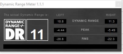

Any measurements of crest factor for organ music? whilst much popular music is compressed to death I can't see it being a problem for well recorded Organ in an acoustic setting (aka church/cathederal).
The heat sink for a 100 W Allen organ amp, 2 MJ802's, is 6" x 6" x 6" with a lot of fins. They expect to put out some serious power for a long time. Organ installers are warned not to use woofers designed for rock or disco PA; they don't have the heat rejection necessary even if the enclosure is ported to go down to 16 hz.
I am well aware that an Allen organ can fill a cathederal (Chichester used one in the 80s when I could still sing). However this has zip to do with domestic reproduction in a room not much bigger than an organ loft!
DR tool output is a poor substitute for accurate crest factor calculation, but I'll pull a file off my server tomorrow and see what it gives.
Most of my Organ music is on vinyl for the delicious irony. But I pulled off an album from the server, picked the loudest track and ran through the Foobar DR plugin. Sample of one so usual bag of salt, but this looks a lot less challenging than a large number of recordings from an average power perspective.

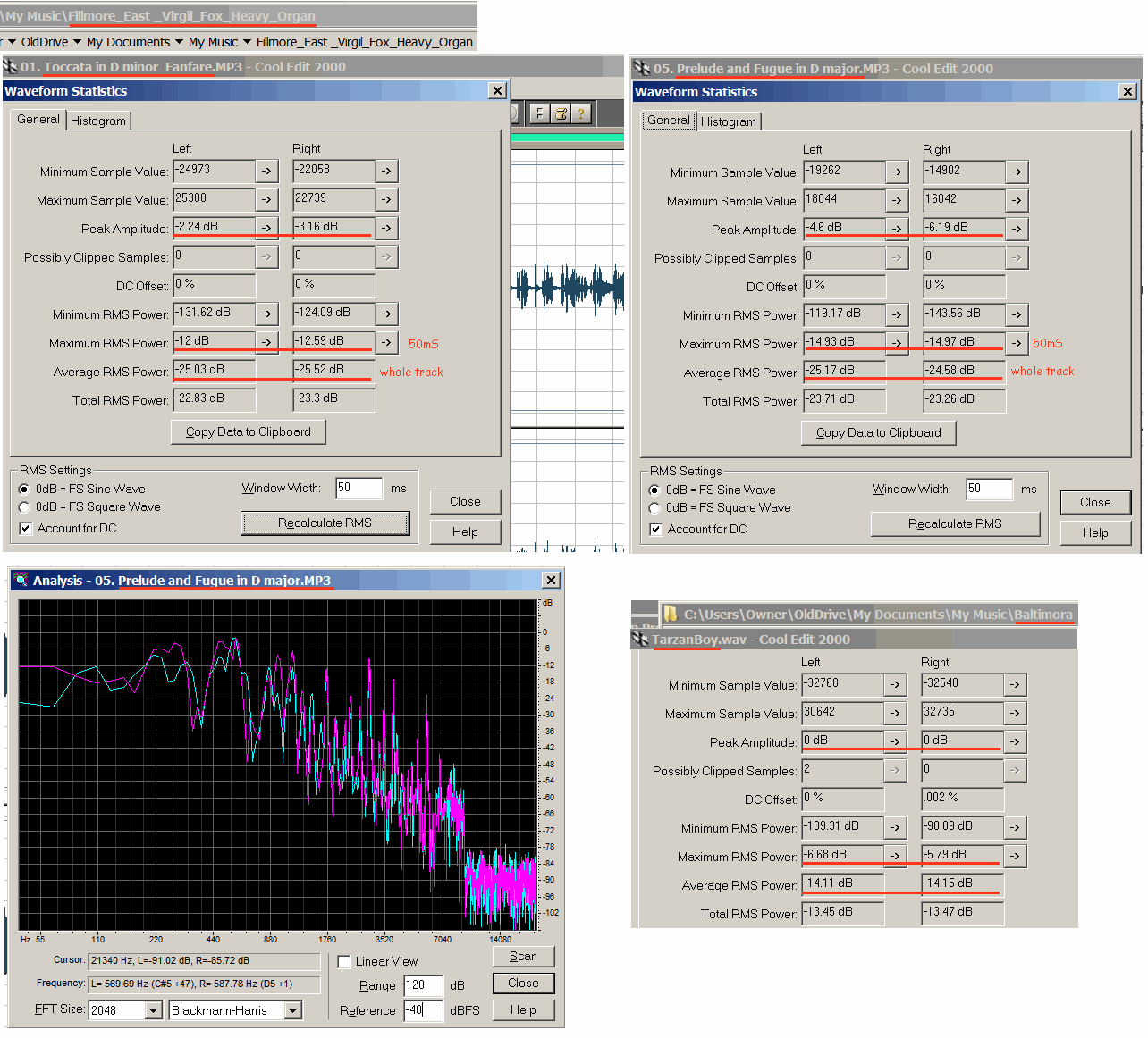

I can't find that heavy-pedal new-organ track. So I turned to Virgil Fox' Filmore recordings. Peak, 50mS RMS, and track-average. For contrast I held my nose (and muted my speakers) and analyzed Tarzan Boy by Baltimora, which was a fair Pop hit in many lands.
Even allowing for 2dB-6dB unused headroom on the 1970s Fox tracks, it seems clear that the Pop track has much higher average power.
