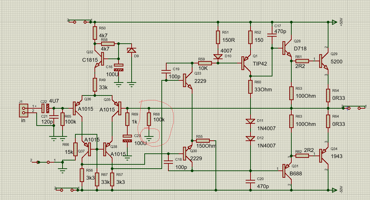

Hello, good night, master, when I connect R68 to ground, not to the output, all frequencies before 20kz remain at 0 Db, so I did not change the R68 resistor.
The test results that I can understand and do are already above.
According to the topology and the test results I have done, I have not found a significant problem for now (of course, since there are not every component in the proteus program I use, I tried to test it with components with approximate values.

...when I connect R68 to ground, not to the output, all frequencies before 20kz remain at 0 Db...
I referred to R68 in #15, also known as R7 (68k) in the OP, or R25 (100k) in #17.
The feedback resistor not connected to the output, but to ground to make it an open loop amplifier.
Attenuate the input signal with the feedback factor (open loop gain / closed loop gain) to get approximately the same output voltages.
THIS WAY GAIN 0DB UP TO 20KZ!!!!
Disconnect R68 / R69 / Q35 from the output altogether: no feedback!
I estimate the open loop gain at 16000x (very roughly), so the attenuation should be 16000/68 (#1!) = 235x.
Given a supply of +/-50Vdc, max output is (100/3=) 33Vac -> max input signal is 33 / 235 = 140mVac.
Start with 10mVac, see what it does at 100mVac if no clipping occurs.
Post the open loop gain Bode plot (gain & phase!).

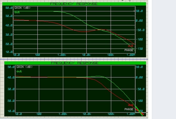

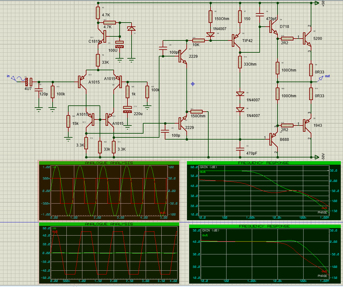

here are the new results, the top two graphs belong to the new drawing
before the bottom two graphic changes
but now I have the opportunity to test live by applying this change on the amp that I actively use.
there is no device like an oscilloscope so I will have tested it according to my own ear
In the upper Bode plot the open loop turn over is at 2kHz, but more important the pole around 30kHz which causes the peaking in the closed loop!
I suspect the first stage differential here - a RC between the collector legs might supress it (4k7/100p).
Phase is -130° and gain is +6dB at 1MHz, just nearing instability even at a -20dB/decade slope.
Also seen in the closed loop where the phase is -90°/decade from 70kHz onwards.
With a gain of 16dB at 1MHz (same phase), there might occur oscillation at 2MHz.

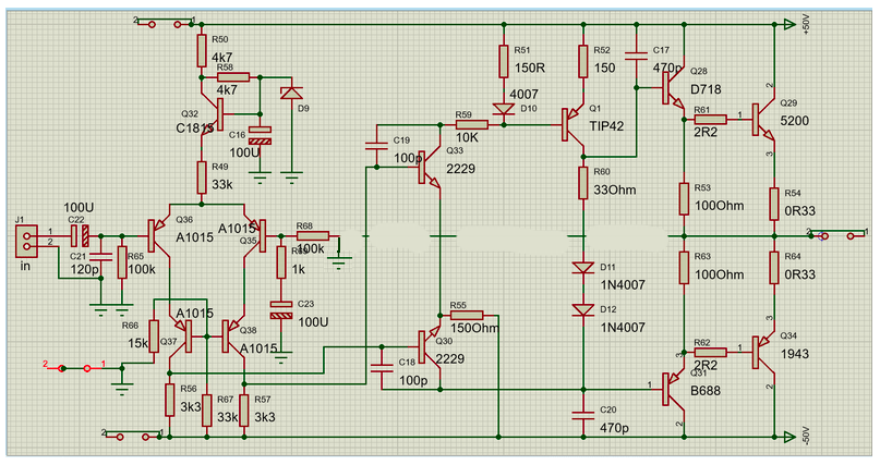

Taking a step back, I think there is an error in how the bias for the input transistors is drawn. I’m guessing the intention is to use Q32 as a capacitance multiplier. In this case, R50 should be between the supply and the zener, R58 should be between the zener and Q32 base. Q32 collector should be connected to the supply. (all references are for the schematic in post 15). I think what you have at the moment will work as a relaxation oscillator, giving the ‘Bo-bo-Bo’result you report With the built amplifier.
It appears to me that the circuit around D9-Q32 acts as a voltage regulator to ensure a very constant current through R49 (33k). Hence my remark in #16.

Current source (R49, 33k) from a regulated supply is very unusual, maybe not neccessary. Curious and unique though.
Cascode with R66-R67 can inject ripple from the negative rail - a current source from the rail will prevent that.
There is no HF compensation in the first stage - it might oscillate.
C18, C19 are miller cap's for Q30, Q33, but is this the right way / the proper values? The BJT's are on the edge.
Q30 is the counter for Q1, but very different. Is Q1 fit for the supply voltage? See remarks #3.
Bias setting with D11, D12 and R60 is very simple, but not very reliable, and with temperature drifting Q29-Q34 will drift too.
The VAS must run on 42mA at least to hop over class B setting, which is very high.
I doubt the values of C17 and C20 - calculations or proof needed.
Add a resistor of >100k on the connector side of C22 to prevent pops when connecting a source.
Zobel network.
HF compensation over R68.
Add values of node voltages and collector currents from the simulations to the circuit diagram for better understanding.
Run a dc analysis injected on the base of Q36 and see if things remain stable.
Run a ac analysis from sub frequency up to 10MHz, a Bode plot (dB and phase) and absolute voltages and currents if all values fits the specs of the components.
Run an ac open loop gain analysis (R68 not connected to the output but to ground), with reduced level (obvious) and observe the behaviour of the amp, especially the higher frequencies. A Bode plot shows hidden zero's and most important hidden poles!
Run if possible a transient analysis.
Run a dc supply start-up & shut-down analysis - is the amp stable during these transits or is destruction looming
Do a power supply analysis - what is needed (voltage, current, caps, bleeders, bridge current peaks, transformer performance, mains filtering).
Do a PSRR analysis - what amount of supply ripple will be injected where and how much and how to reduce it.
Make a plan for a build, wiring, component placing, grounding, safety, ventilation & heat sinks, operability, transportablity, EMC behaviour.
Just to address a few.
