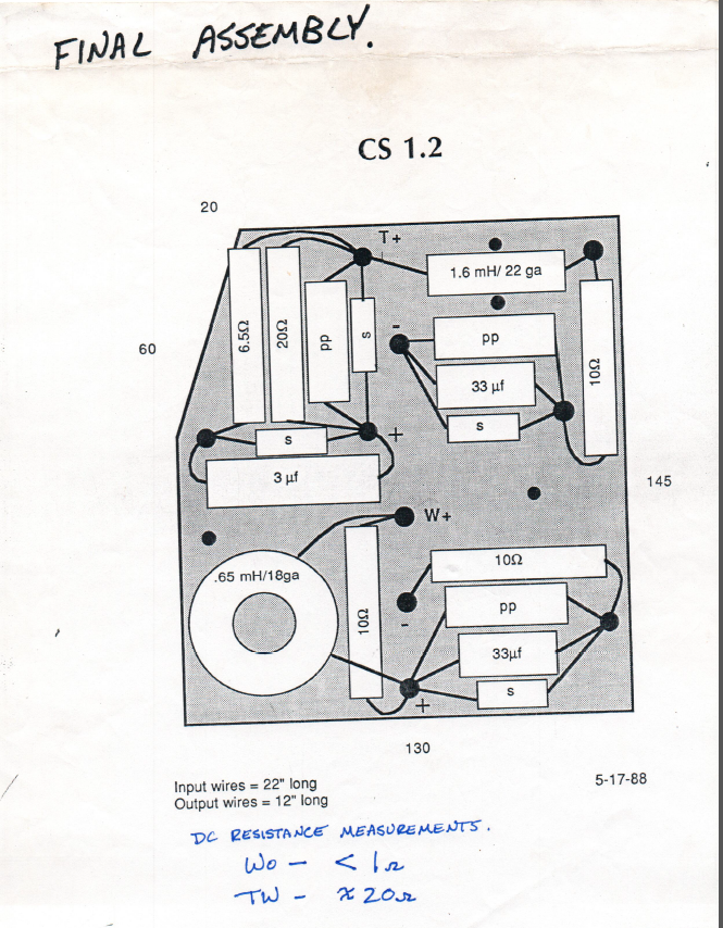

I contacted Thiel and they sent me the crossover layout!
They even keep track of things like wire length -- awesome.

Cascaded Bypass (Capacitors) have nothing to do with anything important here! A red herring, for sure. Let's focus on the important stuff. 🙄

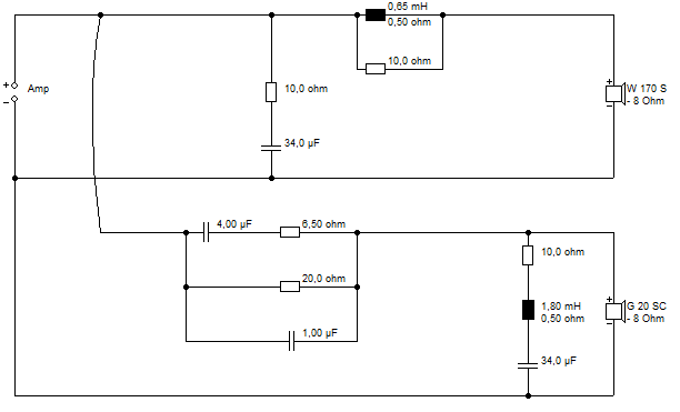

This is a very old speaker with an early metal dome SEAS tweeter. It also has a Vifa P17WJ polycone with copper damping rings and vented polepiece. Very like the famous old Vifa P13WH in fact.
The bass crossover uses impedance correction (10R + 34uF) on the reflex woofer. The 0.65mH coil and parallel 10R resistor apply about 5dB bafflestep around 700Hz. But the woofer is essentially free-running, and relies on its natural 4kHz rolloff to behave.
The tweeter filter is a bit odd altogether. The Fs of the tweeter is slightly notched by the LCR at 650Hz. It then gets a fairly unsurprising first order filter @ 4uF and 6.5R. The 1uF lifts the overall tweeter response about 2dB. The 20R is very odd, even wrong, and I don't know why it is there at all. It lets a lot of bass into the tweeter.
The crossover can be improved IMO. I'd also look into replacing the SEAS tweeter with a new one if it is a ferrofluid design, which has possibly dried out.

The 20R in the tweeter circuit is very perplexing, but that
doesn't mean its wrong. I'm guessing its lowest value
they thought they could get away with chasing the
6dB/octave acoustic goal, though TBH I don't like it.
FWIW the whole circuit implies messing about with
the tweeters bass rolloff, so under no circumstances
change the tweeter model, in an area where the
distortion is, to put it mildly, not that great,
and tweeter responses vary a lot.
I don't really agree with the principles used in the 1.2,
but for sure I agree with don't change it. If you don't
like them, sell them as original and move on.
The only caps worth changing are the electrolytics.*
rgds, sreten.

That 20R is just plain wrong IMO. It aligns phase better at very low bass levels, but that's no excuse for poor design which will cause distortion or risk physical damage. Removing it will not change treble levels significantly.
With a transistor amplifier, the bass impedance correction is an unnecessary waste of power too.
This sort of design is actually well documented, cf version 3:
18W-8434G00
I suppose it's a LR2 at heart. I have some misgivings about tweeter phase in the Thiel design too. I'd think negative polarity.

The 20R is right and wrong. I don't like it, and think its wrong.
Putting my engineers hat on, its plain wrong and totally stupid.
Arguably add a series cap to it (33uF ?) might work, but the
effect might be so measuredly meaningless not to bother.
rgds, sreten.

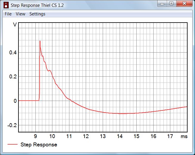

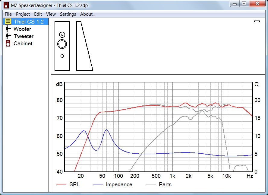

I rather would say it's a classic first order design (-3 dB and 90° phase shift at the crossover point), optimized for a perfect step response. 🙂
Classic "Mickey Mouse" first order design IMO. 😀
Good at step response, lousy at everything else that makes a good speaker. 🙄
It distorts. HORRIBLY. It's a LGWAG speaker.
