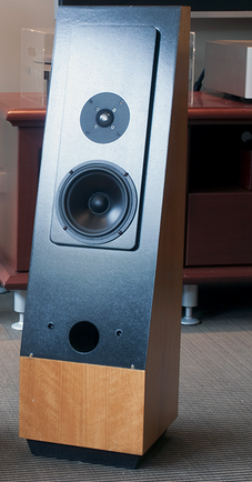

I have a pair of Thiel CS1.2's that I love but I'm always looking for ways to make what I have better.
They seem to have Vifa P17 woofers, 25mm Seas Aluminum dome tweeters, and complex crossovers that has polypropylenes at least paralleled anyplace there is an electrolytic cap. The cabinets are amazing and I seriously doubt they could be improved.
Would changing the crossover to polypropylene only give a noticible benefit? Is there a better woofer or tweeter I could use? Googling for modified CS1.2s comes up with nothing.

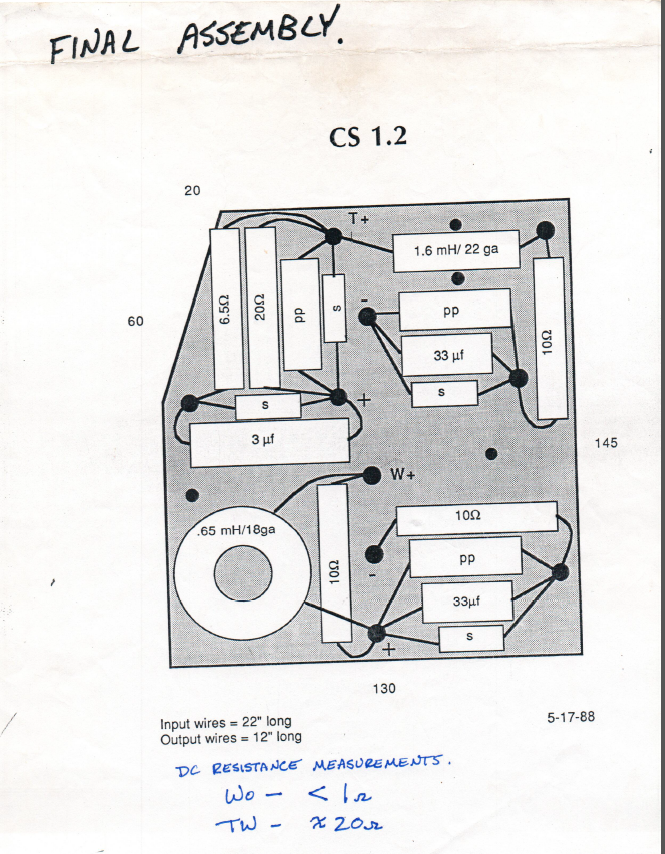

EDIT: I talked to Thiel and got the layout!

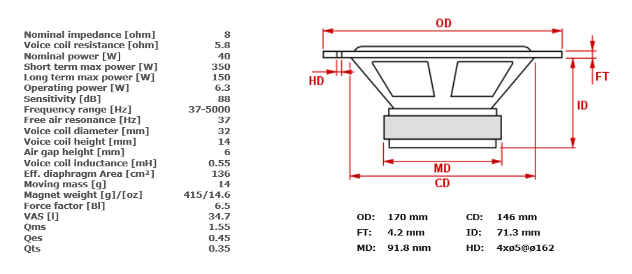

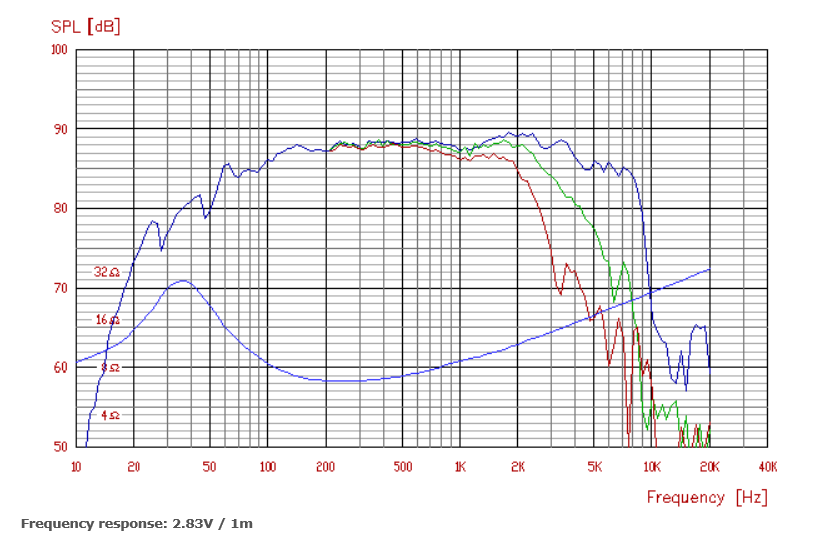

I'd need to see the crossover schematic to actually suggest anything. But that Vifa P17WJ-00-08 is a lovely flat polycone woofer. And a SEAS Metal Tweeter is not too shabby.
It's time aligned, you see. Which is good. Probably hard to improve if the designer has got it right. Losing ferrite core coils, and using polypropylene capacitors with some added resistance if electrolytic aged non-polars were originally fitted remains a possibility.

I wouldn't look for miracles here. But a time-aligned 6" low inductance polycone with copper rings two way is potentially a very nice speaker, albeit with some bass limitations.

I'll try and take a picture of the crossover for you

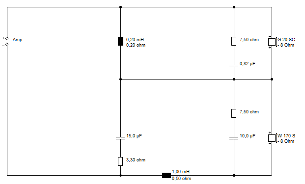

A picture would be good, but some values and a schematic and the polarities of the drivers would help a lot more. This is evidently one of those 6dB/octave Mickey Mouse designs: Thiel CS1.2 loudspeaker Phase Coherence | Stereophile.com

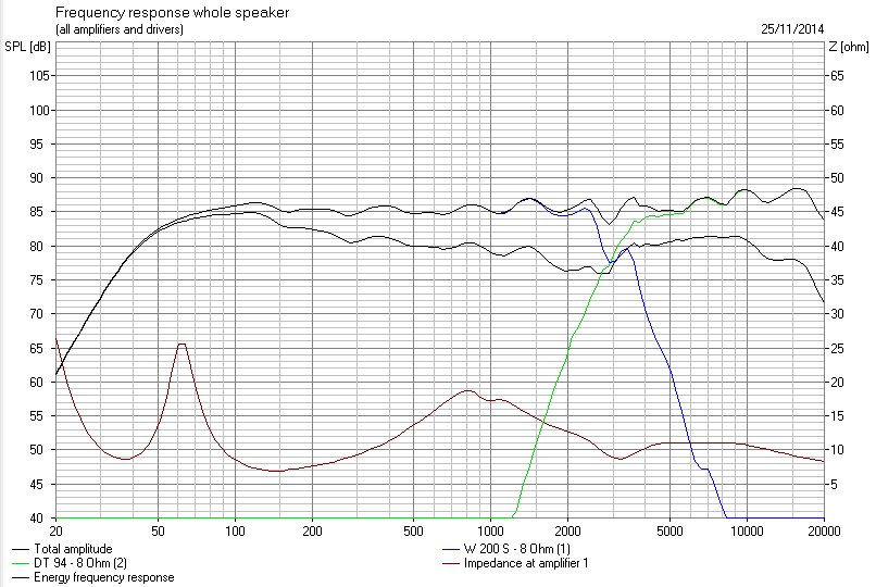

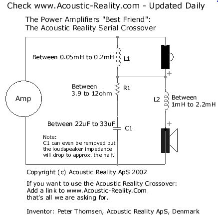

A one-trick pony with good phase alignment and good impulse response, and not much else going for it, unless you like cone breakup and tweeter distortion! It has simplistic series crossover written all over it. Those can be improved a lot IMO. Most of these types of design were based on the "Acoustic Reality" crossover, which led a lot of people up the garden path! :eek:
BTW, don't read too much into the sim on frequency response. A paper bass is a different animal from a polycone.

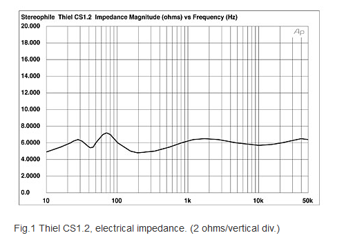

Thiel employ 1st order filters, but I've never seen a simplistic example from them, let alone an AR type. To the best of my knowledge, they're parallel designs with extensive impedance correction & multiple notches where appropriate to ensure a decently flat response. The attached image for instance shows the 1st order filter for the CS6 -not exactly a minimalist cap & coil. ;) In the measurements page of the Stereophile review of you link to, John Atkinson provides the following remarks:
-'it is noteworthy how little change there is for each speaker... I would conjecture that Jim Thiel has used some form of conjugate load system in his crossover designs to give such a flat curve with frequency.' No news there, standard practice for Thiel.
-'the in-room response is one of the flattest I have measured'. It's not half bad.
So they are evidently doing a fair bit right. Granted, 1st order means limited power-handling & off-axis response -that's the trade off. Not to all tastes to be sure, but it's not without merit either. They're one of the few places where you can 'see' a 1st order filter implemented 'properly'.

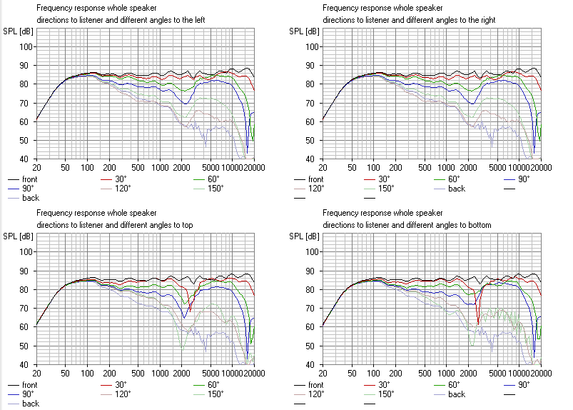

How it works, is even order (LR2 and LR4) filters give a very flat frequency response on the horizontal axis. Unfortunately it all goes "tits up" above and below axis. What this means is if you are listening down the hallway or in the back of the room is there is a spooky loss of energy at crossover. It sounds a bit odd.
When you use a odd order crossover correctly, with all the oddities of their 90 degree phase alignment, it actually sounds quite realistic. In general, I am more interested in the 18dB slopes of third order Butterworth. Perhaps this leads to third order MTTM designs. Time will tell. :)
