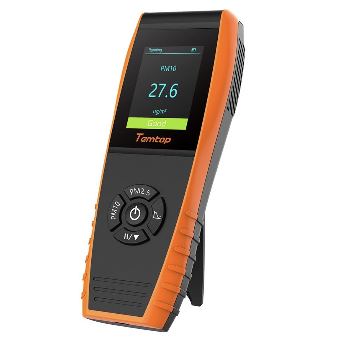

BTW I recently purchased a device to measure particles in the air. After some 30mins of soldering in my workshop it displays numbers of 600 or 700 and alerts with strong warning messages. Normally it reads way below 20 where I live.
  • temtop-p600-handheld-pm25-pm10-air-quality-monitor-with-histogramtemtop-357243.jpg
