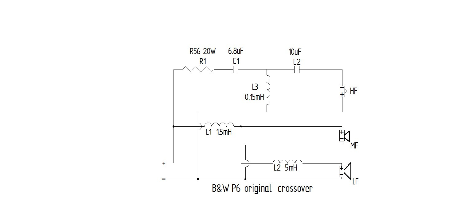

I'd like to know the actual impedance of drivers I have but don't own or want to buy a microhpone, signal generator or sound card. So are there any calculators or crossover formulas online that can solve for driver impedance based on inputs of uF, mH and fc? And if so would results be meaningful?

Are you saying you know the crossover component values and you want to work out the driver impedance they were designed for?
Yes. I know the uF, mH and Hz in the filters for each driver in a 3 way speaker.Are you saying you know the crossover component values and you want to work out the driver impedance they were designed for?

I wouldn't think what driver it is is important and the maker doesn't provide driver impedances at crossover frequencies. The bottom line is I really like the sound of the speakers and just want to learn the impedance of the drivers at their crossover frequencies. The maker's spec. sheet just says 8ohms (minimum3.5ohms)
I will measure impedance with my meter but the maker's document just says 8ohms (minumum 3.5 ohms).Use your multimeter and measure resistance. We can tell you if they're 8 ohm or 4 ohm,
orIt won't be easy but we can make a guess if you tell us the values and the way they are connected.
XO is 150Hx and 3000Hz

The impedance is a complex valued quantity (amplitude and phase, combined into one number). For a loudspeaker as seen from its input terminals, or even just a driver alone, the impedance varies A LOT with frequency. You cannot just get one number for it, and you cannot back calculate it with any accuracy from the crossover diagram.
What I tried to explain to you before is that if you know a bunch of parameters for a DRIVER you can calculate ITS impedance as long as those parameters are very accurate and you know some things about enclosure that the driver is used in.
So you asked "are there any calculators or crossover formulas online that can solve for driver impedance based on inputs of uF, mH and fc" and the answer is no, not what you are envisioning.
1st order, L = ( 0.159 × Z ) / fx, where L = inductance of the coil in Henrys; fx = crossover frequency in hertz; Z = (actual) impedance of the speaker in ohms
re-arrange formula to solve for Z

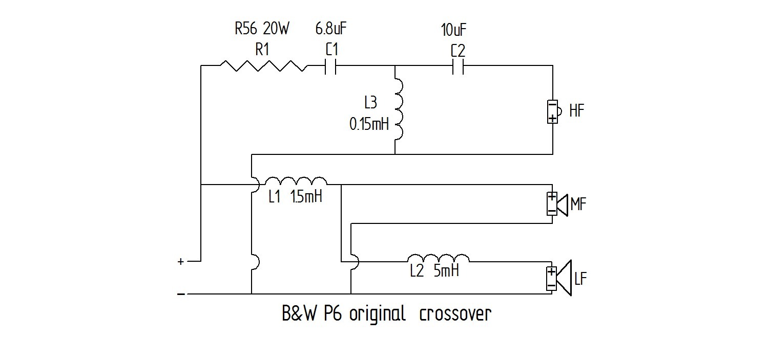

The mid and woofer aren't really crossed. They are working together doing a kind of baffle step compensation. Based on assuming the mid is 8 ohms, it appears that it might be down a few more dB than wanted at the cross, which suggests it is more than 8 ohms there.. unless there is an upturn in the response. What size is this mid?
The tweeter also has some peaking relative to 8 ohms which suggests it is less then 8 ohms near the cross, or falls in response or is being EQed etc.
