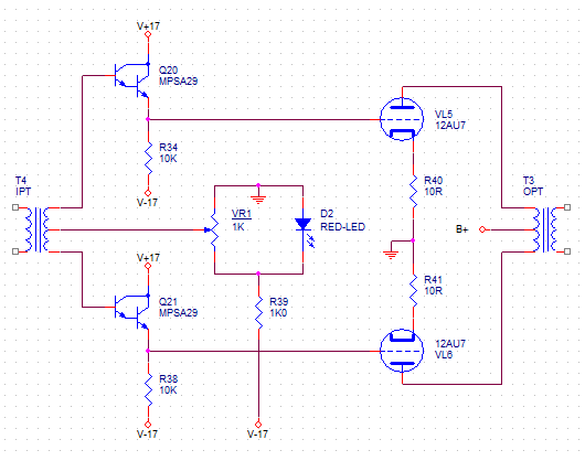

Its asking a lot from such cheap transformers to give a 4:1 voltage step up and drive a valve into positive grid territory. Unfortunately I would predict a fairly disappointing result.

Yes, DC grid current flowing in the secondary (that also has 4x more turns) is likely to be the first limiting factor even if one uses a proper OP-amp to drive the low input impedance.
These tiny signal transformers don't have a proper gap. They can only rely on a slight mismatching of E and I lamitations which can only guarantee imuunity to very small DC currents. In theory output power could be even more than 1W, in practice it will be a small fraction and limited by input transformer saturation which will produce a really nasty sound.
280-290V supply and 470R common cathode resistor for the 12AU7 to stay away from grid current is the simple solution....

Why don't you bias each triode of the 12AU7 with a DC coupled source follower and forget about re-gapping transformers without info about the windings, CCS, OP-amp etc.?
It only costs a couple of FETs, few resistors & caps and tap on the secondary HV winding. From the tap you make a voltage doubler and then filter the dual supply for the source follower....
There are many things one can do but it seems to me that the OP is not experienced because he is asking for an alternative design. So a simple circuit that more or less works is the best start IMHO.
290V supply and 470R common cathode resistor + input transformer is one. Alternative solution: same output stage with self-bias resistor and the ECC88 as voltage amp + concertina and he doesn't need any preamplifier.
They are really the simple, class A and should get about 1W. Not bad as a start.
If one starts with something more complicated that is not able to manage and it doesn't work (doesn't sound good) I think he will lose interest...

I think 45's suggestion is entirely more sensible. Keeping the valve away from any grid current will make it more versatile since just about any preamp will be able to drive it well. The higher voltage requirement is not an issue since a very cheap power supply can be built using DC-DC boosters (especially at this current).

Except that not running it in A2 rather obviates the whole effort of having an IT transformer, and limits the max power even further...
Agree on the bias thing, fwiw... it's certainly a way to go.
I'm afraid that's a bit beyond me, but I understand parts of it, I think. Are you saying that based on the schematic shown, the amplifier cannot function?
I suspect there is an error in the schematic. There should be no connection from the cathodes to the transformer. The centre tap of the transformer should go to 0V. Apart from the use of diodes, this is a very common topology in old professional audio designs from the 1940s.

I suspect it is a design flaw rather than an error i.e. it is a deliberate error. To get much output from a P-P 12AU7 you need to run it in Class A2 with little or no grid bias.
That's exactly the topology of original design linked in post #1. The center tap is connected to the cathode and not ground according to its designer.
