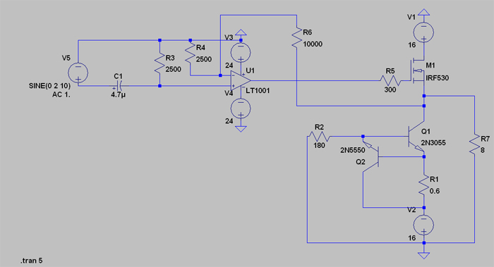

Point noted there and i think i will use OPA2134 instead of AD826.
Here is the redrawn schematic. Hope its stable now.
happyboy said:Here is the redrawn schematic.
Q2 is upside down. It may even work but rather badly 🙂
Cheers
Alex
Cheers
Alex
Yikes! No wonder there was alot of distortion if i biased that thing below 1.4A. Now i can bias it at 1.2A and still make it work properly.

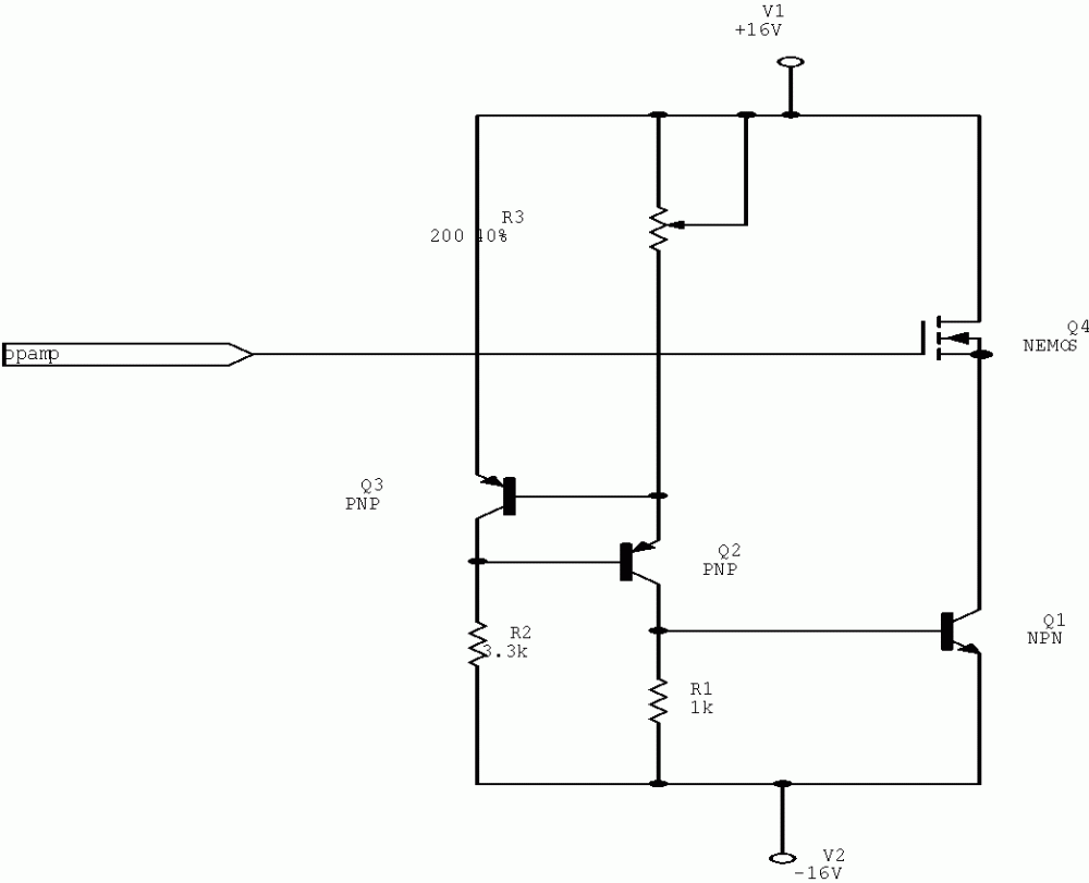

jerluwoo said:This will give you better way to adjust your current so you can remove the resistor out of the output.
Hi Jerluwoo,

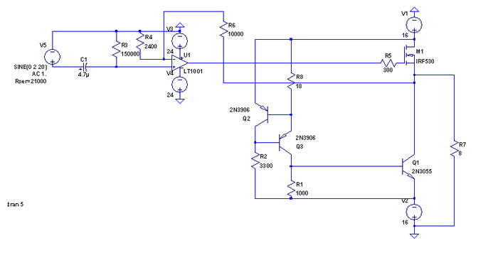

Thanks for your help. Here is the schematic that i redrawn. Is using 2N3906 for the PNP transistors alright?
Thanks!
happyboy said:Here is the schematic that i redrawn.
I would strongly advise against this circuit. It would be thermally unstable in practice - almost as much as you original one. Stay with a proper two-transistor CCS as discussed earlier.
Cheers
Alex
Cheers
Alex
Hmm okay. But i would like to ask something, its not about being biased to each other but more of me wanting to know more. Why is that the biasing circuit proposed by Jerluwoo unstable?
happyboy said:Why is that the biasing circuit proposed by Jerluwoo unstable?
Because it relies on feeding a BJT with a constant base current. The collector current would be equal base current times the beta of the transistor. All would be fine in a simulator where the beta is a constant value. However in real life beta is strongly dependant on temperature, moreover it usually increases when transistor is heating up - so there is a positive feedback as increase in current would increase the power dissipation and the current of CCS would vary greatly. Worst still, the temperature of the device would vary with signal and so would current. On top of all this the dynamic output impedance of such CCS would be fairly low as the beta varies with collector voltage too.
These are the same reasons why I did advise you against your original CCS circuit - there was just a resistor to set the base current, however the resulting problems would be almost the same I've described.
Cheers
Alex
The last circuit has two problems.
The 18r (R8) sets the constant current through the right hand side of the transistor pair. The current is 0.6V/18r=33.3mA.
Pass this current through the 1k0 (R1) lower leg load and you have 33.3V applied to the base emitter junction of the lower transistor. It does not work.
The opamp now has 1k9 on it's inverting input and 150k on it's non-inverting input.
The resulting output offset will cause asymetric clipping of high level signals and an increased level of distortion at higher signal levels well short of clipping.
AndrewT said:Hi,
Andrew,
I have to disagree 🙂 . In a first part the BE junction of the lower transistor is forward biased by this current, so it is OK, it will work but would be unstable with temperature etc. In a second part - happyboy has stated that he would use OPA2134 which has JFET inputs, very low input currents and would not produce any significant offset because of the resistor imbalance.
Cheers
Alex
The wonderful thing about class a outputs is that once they reach full idle temperature they drift very little. I have used this method on countless little amp circuits and litterally tortured them without any problems.
jerluwoo said:The wonderful thing about class a outputs is that once they reach full idle temperature they drift very little. I have used this method on countless little amp circuits and litterally tortured them without any problems.
The wonderful thing about electronics is that you can build better circuits by understanding how they work 🙂 . You can get away with many things - it doesn't mean you should.
Cheers
Alex
AndrewT said:Hi,
could someone explain the operation of q1 when 33V appears across the BE junction.
These 33V would never appear there, so it's OK 🙂 . As the current from CCS would bias BE junction forward all you may get there is about 0.7V - unless there is no sufficient heatsink for this transistor and it eventually blows up... .
