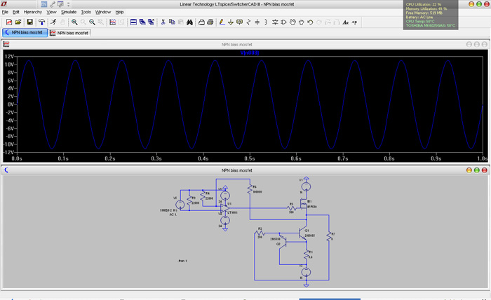

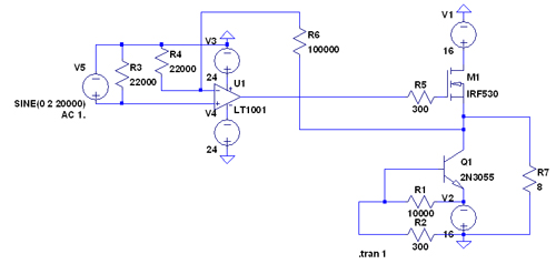

hi x-pro, thanks for your reply. I redrew the scematic in LTspice and simulated it. It works well but then it must be biased above 1.4A if not the some parts of the bottom half of the wave will be clipped off. Any idea why?
Also, must the 2N5550 be mounted together with the 2N3055 on the same heatsink? Cause its a TO-92 Package type.

I must be thick. I find trying to read that schematic with the voltage sources in unusual locatons very difficult to read.
You have posted a DC coupled amplifier.
The source resistance on the inverting input is 22k//100k=18k
the non-inverting sees 22k//0k0=0k0.!!!
That will guarantee an output offset.
The pre-amp or source that you finally connect instead of the idealised voltage source will controll the output offset by substituting a different source resistance. If it is DC blocked the non-inverting source resistance changes to 22k. oops the output offset has gone (unless you had zeroed it with a shorted input).
Do you plan to use a DC coupled pre-amp with a DC servo?

happyboy said:hi x-pro, thanks for your reply. I redrew the scematic in LTspice and simulated it. It works well but then it must be biased above 1.4A if not the some parts of the bottom half of the wave will be clipped off. Any idea why?
You may change the CCS current by changing the value of R1 on the diagram (i.e. 0.4 Ohm for 1.5A) and if you need substantially more current, reducing R2 value. 2N5550 can be replaced by something like BD139 - however it dissipates less than 100mW and doesn't really need a heatsink.

Hi Andrew,
I am kind of lost when u mentioned about the output offset. Could you enlighten me further?
The simulation says that it would work without any DC offset so im kind of confused.
I plan to connect this directly to a CDP through a passive preamp.
Thanks!

AndrewT said:The source resistance on the inverting input is 22k//100k=18k
Hi Andrew,
the schematics is somewhat unusually drawn, however there is nothing wrong with it (IMHO) with the exception of the CCS. The offset due to the resistor imbalance on the inputs depends on the input currents of the opamp. For LT1001 in is only few nA and there is nothing to worry about - maximum offset it could create on the output would be less than 1mV anyway. For some opamps with >0.1uA of the input current that could be a problem, thought.

Sorry for the misconception, but the LT1001 is just there for me to do simulations. I intend to use AD826 in the final thing. Would it be a problem with the 826?
no. max is 18 volts. In the finaly thing both the opamp and the output stage would run on +/- 16V.

Yes, it would be a problem. AD826 has very high input currents (as do many fast opamps) - upto 10 uA ! In your circuit it would introduce far too much offset. Easy way of getting rid of it without changing opamp or circuit would be to put a coupling capacitor (say 10uF) on the input before R3 and reducing R3 to 18K to balance DC resistance as seen by the inputs.
However I would be careful in using AD826 or similar opamp in a circuit like this. Fast opamps do require much attention to details, including power supply arrangement, layout, feedback resistor values etc. In your circuit 100K and 22K in the FB chain is far too high resistance for AD826.
I would use for example OPA134 to start with in a circuit like this and with little experience of fast opamps.

Hmm in that case i think i will just use a NE5532 Opamp. Am i right to say that it will not have much DC offset cause the input current is 200nA?

If you will use a capacitor on the input and change R3 to 18K the offset wouldn't be a problem. To calculate the additional input offset due to input currents you need to multiply input ("bias") current of the opamp to the DC resistance connected to it. In your case 18K*200nA=3.6mV. To reduce the output offset you should make sure that the offsets on both inputs are the same, in this case the output offset (excluding the initial offset of the opamp itself) should be 0. Any difference would be amplified by the gain of the circuit - in your circuit it is about 6. Even if your non-inverting input is grounded the output offset due to the input current would be around 3.6*6=21.6mV which is acceptable for a power amplifier output.
However I would advise you to use the input capacitor as you may have some DC offset coming from your source - this would be amplified accordingly and may become dangerously high for the speaker.
