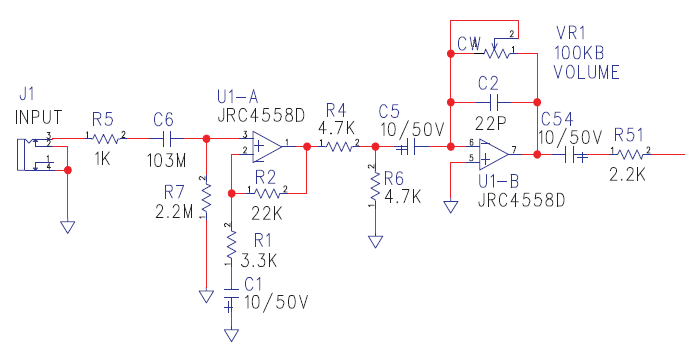

This is the input of a small Epiphone practice amp. Two things here I don't quite understand:
1. I'm trying to figure out the gain of U1-A. The formula is simple enough if C1 wasn't there. G=1+(Rf/Rin), which is 1+(22K/3K3) = 7.67. But I'm not sure how C1 (10uf) figures in there.
2. This is the part that's really messing with me. If you look at the volume control, (VR1), when it's turned down, it shorts out pin 6 to pin 7. I would think that that would put U1-B into unity gain. The output of U1-A is divided in half by R4/R6, and then whatever voltage is at pin 6 would have to appear at pin 7 by virtue of being a dead short. That signal would then go into the amp section.
But it doesn't. VR-1 is the volume control that kills the signal completely. There is no other level control downstream of R51. I just don't understand how that is happening, except that maybe my understanding of electronics isn't where I thought it was.
I'd appreciate any help in understanding these two issues.
You need to look at a cap and guess if it shaves the bass, the treble, or neither (within the Audio Band).
10uFd with 1K resistor is "full bass" (17Hz). Higher resistor passes deeper bass. 10u and 3K is 6Hz. FAR below guitar band. So the 10uFd "is a Short" for all audio purpose.
Where does that leave you?
R6 is interesting because a clear analysis says it falls out of the gain equation. You have to look at OVERLOAD action to see why it is needed. Output of opamp A could slam input of opamp B so close to its rails that it gets ugly/nasty and not in a "groovy way". With R4:R6 the summing junction, "virtual ground", will not go to half-rail even when opamp B "virtual ground" has crapped-out.
PRR beat me to it 🙂
C1 has low reactance within the audio band and so may be considered a short circuit for audio. So your gain equation holds up for such AC signals.
As frequency falls the reactance of the cap becomes dominant and has the effect of rolling the gain off all the way to unity at DC.
The cap also stops the opamp amplifying its own DC offset errors as the voltage gain of the stage is unity at DC.
Also don't forget the input coupling cap. That also blocks DC and also adds a low frequency roll off as its reactance combines with the 2.2 meg resistor to form a high pass filter.
The active volume control is just an inverting stage where the feedback resistor is brought all the way to zero ohms.
R4 is the missing link for you understanding how it works. The gain is - (VR1/R4) the minus denoting an inversion of signal. So 100k and 4k7 gives a max gain of -21.2 numerically. With VR1 at zero ohms the gain is also zero.
C5 does the same thing... block DC. We don't want to be amplifying that.
R6 increases the 'noise gain' of the stage but has no effect on the gain calculation in real terms. It is not a divider (once the opamp is in circuit) although it might look like that at first glance.
It is a technique that can be used to aid stability although I'm not really sure why it was felt necessary tbh given the choice of opamp... however 🙂
No, this is an inverting stage, it's only non-inverting stages that are limited to unity gain. The output can send any amount of current to cancel the input signal getting to pin 6, without needing any output voltage to do it, as its shorted to it.
The voltage at pin 6 is zero as its an inverting stage so the inverting input is at virtual ground.
