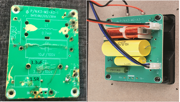

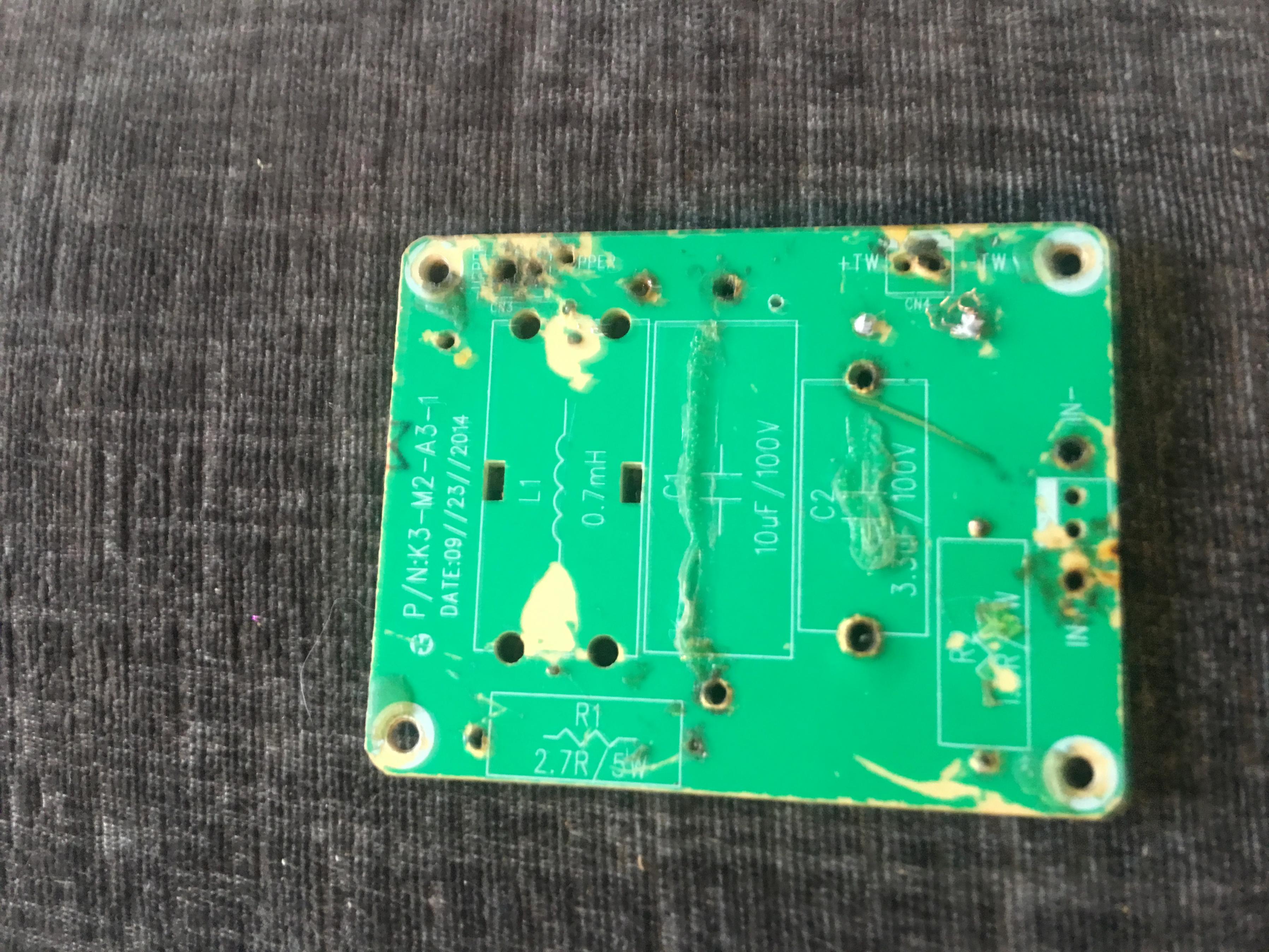

Ok I have contacted Epos. But they do not keep spare xover pcb boards. I have completely messed up the original boards. I was looking for some help to do the xover. With wood and the components. But I don’t know what goes with what. How it should be laid out. What joins with what. Many thanks lee
as always, why not start by showing us some pics of the crossovers. front and back.
maybe someone will take pity on you and kindly draw up the schematic.

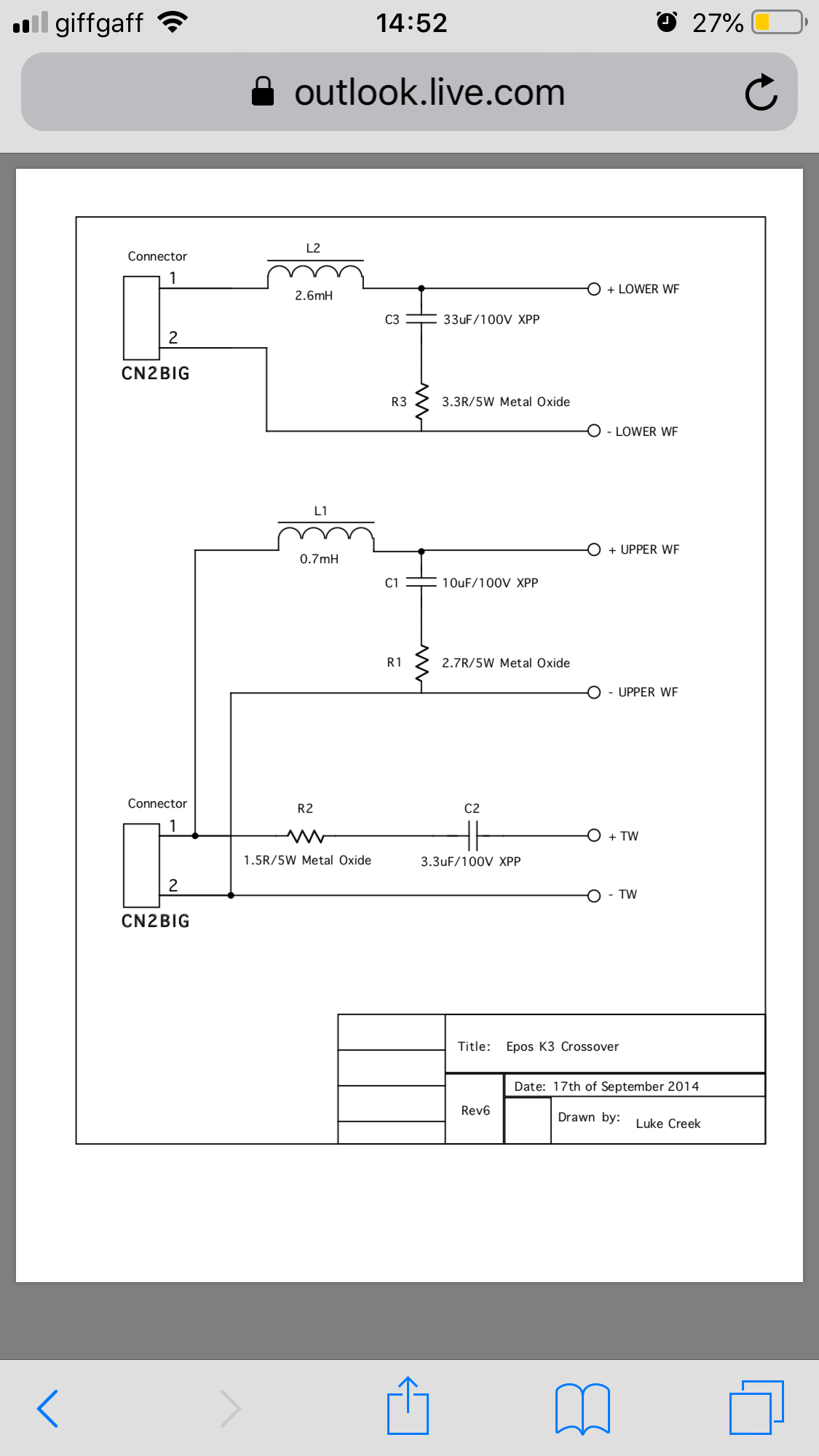

this is the diagram Epos have kindly just sent meOkay, so we've got the component values. That's a start.

Great, now you need only populate the boards with parts. Have you got a second one, the one for the lower woofer?
Thank you yes I do have a second crossover in the speakers I have not touched them that’s why it’s still working lol. I have all the part from the main board. I just don’t understand what goes here and there many thanks lee
Can you read the circuit diagram?

what's with needing the board, foil damaged?
if the parts are ok you can wire them point to point or use an old terminal strip or even some copper nails into a thin board to assemble the x-overs.

Thank you. But where do I start point to point. I know I should off not touched if I never knew how to do it but me be me. Have royally messed up. Many thanks lee
