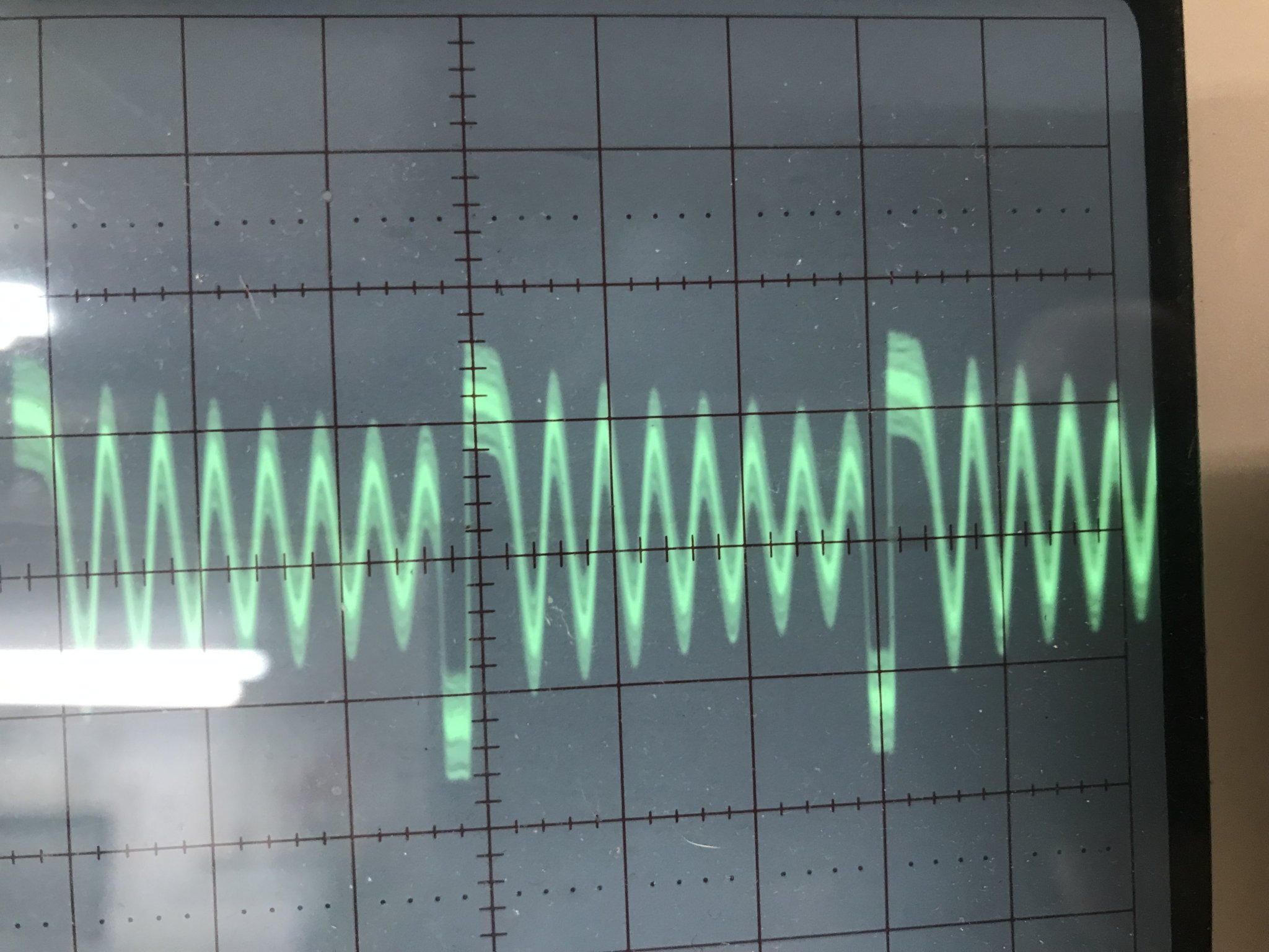

Would it be possible to use a scope to find out the switching frequency?
Yes, approximately. Put the scope probe near the transformer of the SMPS while it's running. Adjust the vertical sensitivity and the horizontal time base so you can measure the period of one cycle. The frequency is the reciprocal of the period. You don't need a direct electrical connection as the probe will pick up the stray magnetic field. It's not going to be a clean signal but you should be able to see a major repetitive pattern. And of course be careful, as there are high voltages present in a SMPS, even for a while after it's turned off. The attached photo is from a plastic brick SMPS, in the case. 5uS/div x 3 div = 15 uS/cycle or F = 66.7 KHz

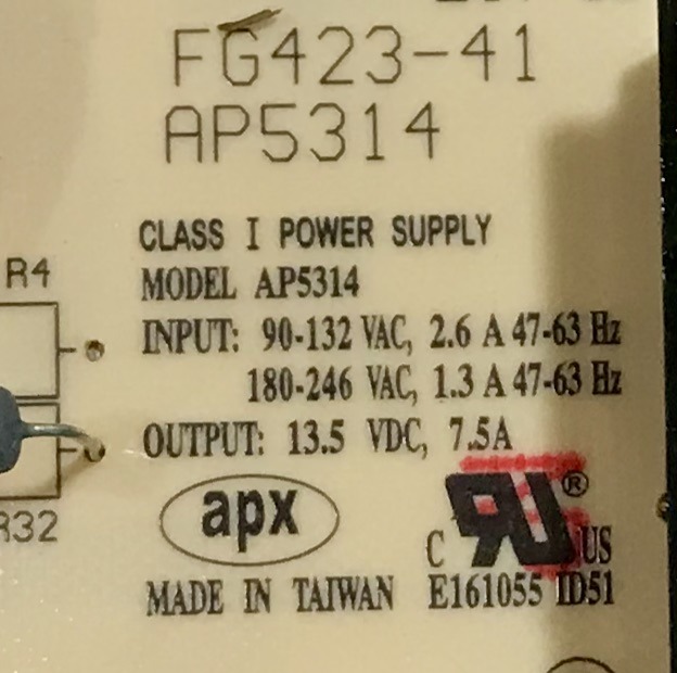

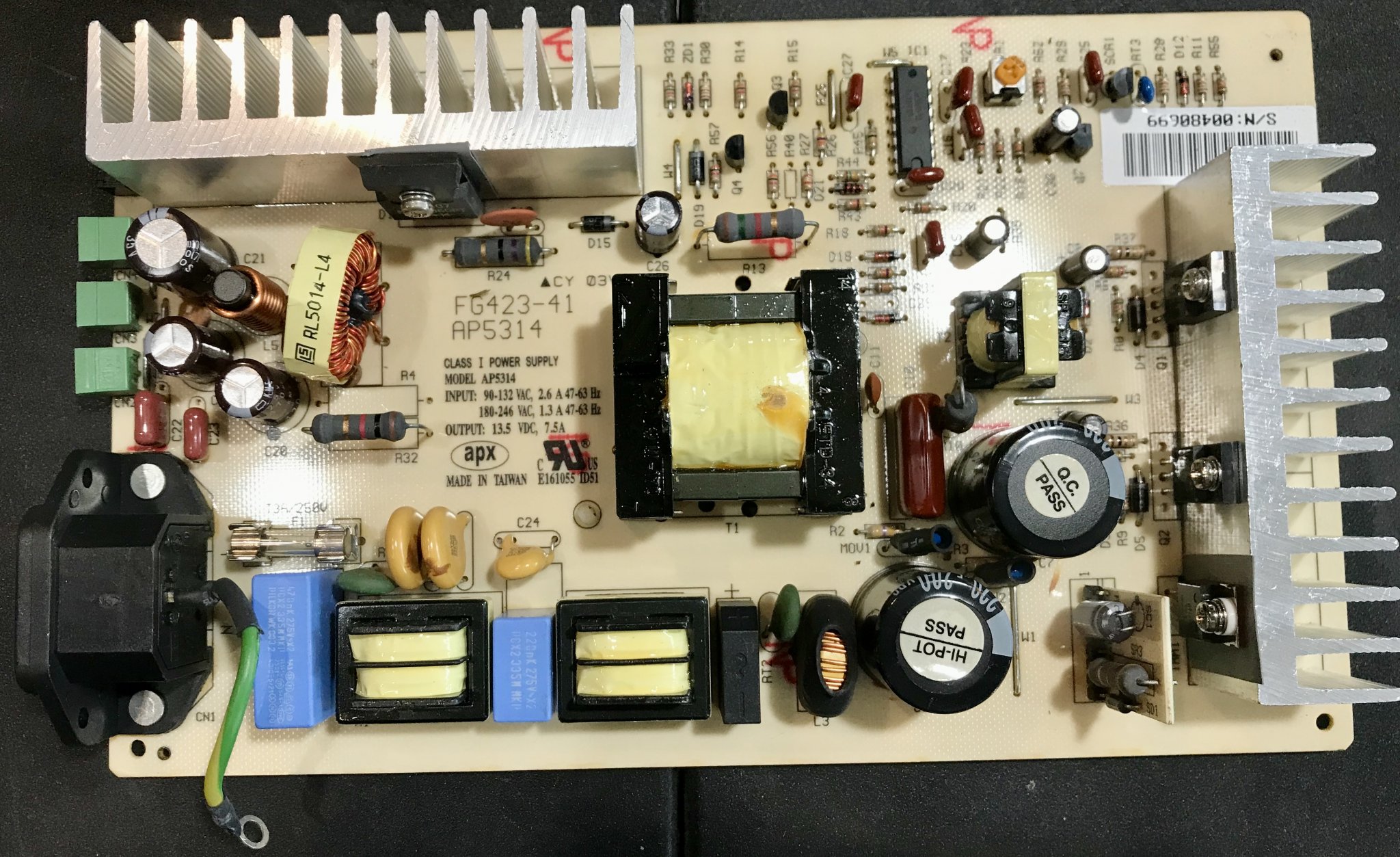

I came across several of these DC power supplies while I was looking around my pile of spare electronics.
Being ignorant, how do these look for supplying a clean low ripple DC power for a good DAC or small amp requiring good 10-15v? They're measuring 13.3V output and would be outboard of the DAC in its own enclosure. I think I also have one of these (bigger, same design) that is 24V/5A. Are these linear power supplies?
Reactions: naadbrahma
This is a switch mode power supply. They are usually well regulated meaning the output voltage is constant with a variable load. It will have some switching noise on the output which may affect your project. Just give it a try.
There may also be a data sheet online if you search by the model number. That should have specs for the noise, ripple, etc.
