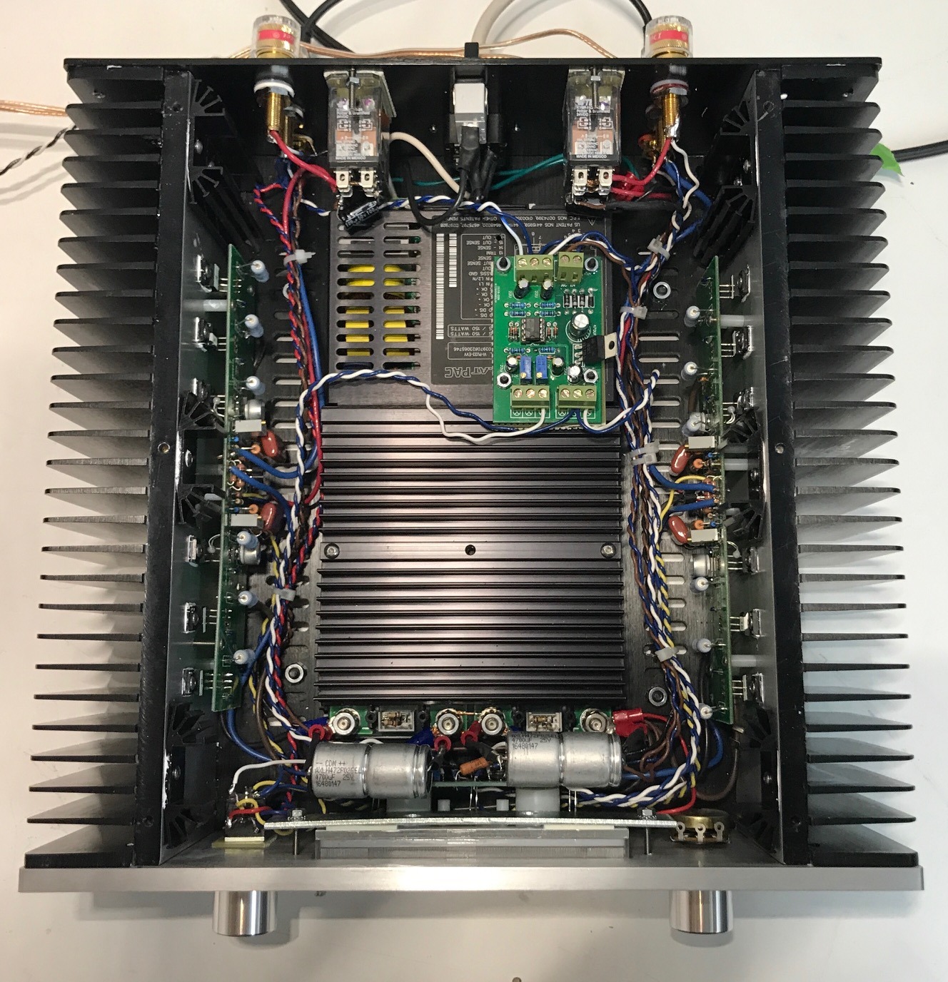

I built the Juma F5 2sk2013/2sj313 with dual output switcher a while back. Worked out great! I was also a little worried about what happened if one rail failed, so added a bit of speaker protection. The speakers outputs had relays whereby both rails had to be up in order to turn on the relays. Seemed good enough for worst case failure.
In terms of using two separate supplies for +/- I suppose beat frequencies is possible. Probably less likely if you get a dual voltage output on the same unit. That’s what I had.

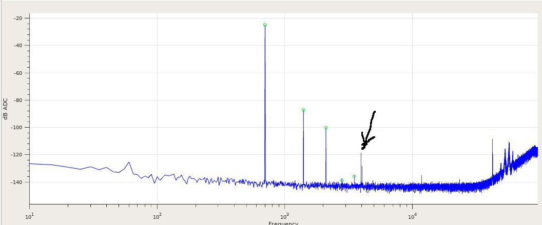

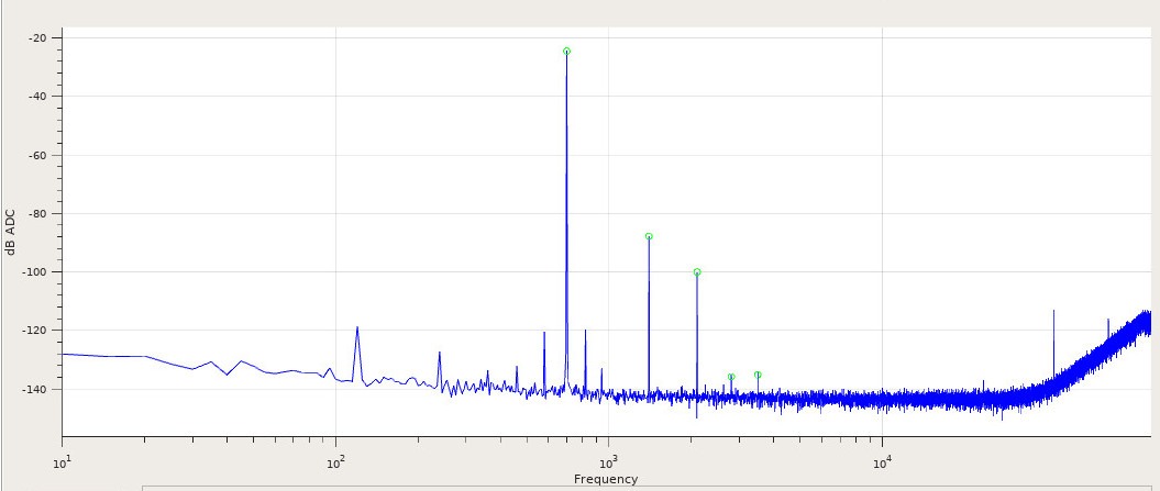

I recently did an experiment with a F7-like amplifier using a pair of Mean Well IRM-90-24ST power modules for one of the stereo channels. There was definitely some kind of beat frequencies visible in the output spectrum, but the level was about 100dB below 1 Watt (about 3uV rms) at a frequencies near 4kHz shown in the first image below. The spectrum was for a 1kHz input with a 4V peak output into 8 Ohms (1 Watt). The beat frequencies did not change when the fundamental frequency was changed, suggesting that the beat frequencies were between the SMPS switching frequencies and not the spectrum analyzer test frequency.
Channel with SMPS supplies:
Channel with linear power supply:
The problem here could have been the use of two switching supplies, running at two close, but dissimilar, frequencies.
