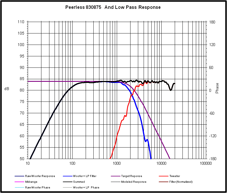

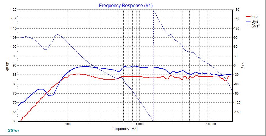

So here's the direct comparison between the Continuum and the LM-1. Again, I note that the differences may be only due to measurement technique, except for the sensitivity which is due to the drivers, and bass extension.

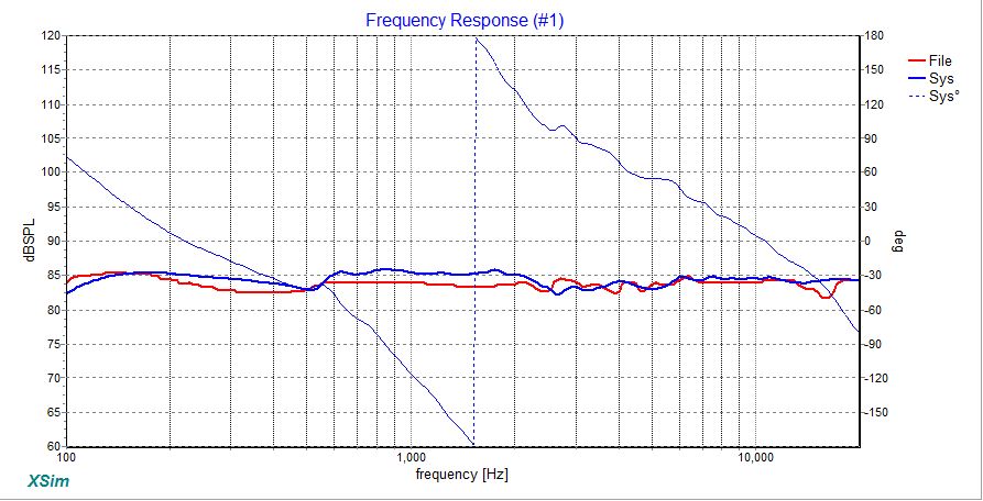

But let's assume those differences are real. If you adjust R1 as discussed in the blog, and also change the levels in the graph so the two speakers line up, you get this:
Except in the bass extension, with the change in R1 there is no difference in the two speakers. Having actually listened to the LM-1 (which is plenty bright), I'm pretty sure the differences in the first chart are not real (unless Bagby and others are deaf above 2kHz), but if they were the model says we would get to a nearly identical mid bass to treble performance by switching a resistor. Any claims of the LM-1 being less smooth or in any way deficient in the frequency domain are meaningless horse hockey.
So, here is the double standard. Kileau or whatever, wants to complain that I did a technical comparison without hearing the Continuum (which I make clear in my blog) but wants to compare our two speakers without hearing them.
Based on these two FR plots alone, I'd say there's no meaningful difference and only a side by side comparison would be able to tell, and it would be purely a matter of personal taste which was better. Anyone who claims otherwise has been reading too many reviews.

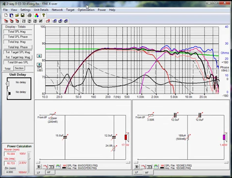

Google for "FINE X Over demo" and you will notice that in the demo of the software Peter Larsen uses a tiled response goal.

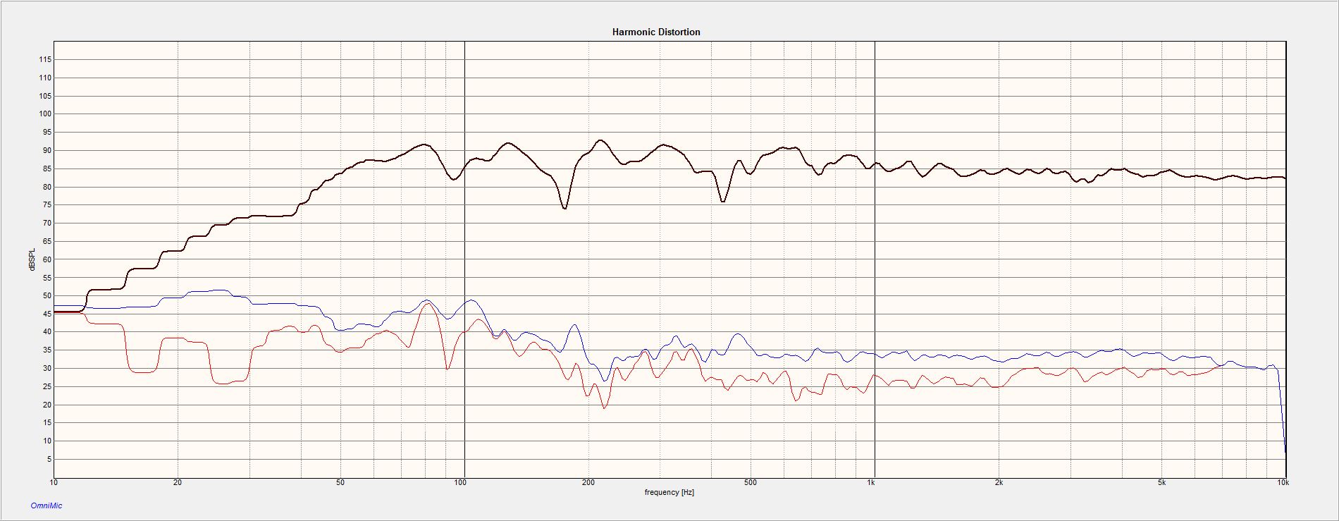

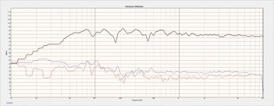

For the LM-1C I did measure distortion at 1 watt. The 1C crossover slopes are a little steeper, and crossover point just a hair lower but please take a look at the 2nd and 3rd order HD plots (OmniMic's DB scales here are questionable). Above 800 Hz 2nd and 3rd order distortion measurements were under 0.35%
There's no 5 kHz breakup filter here either. In the LM-1 that breakup mode was only about 5dB above the rest of the woofer level, and 22 dB down after filtering. There's absolutely no evidence of it in the FR or distortion plots, and no evidence at all of the tweeter being crossed over too low. As was mentioned, adding a notch filter would destroy a heaven-sent phase matching that I am not about to mess with. Having a very simple crossover was a design goal, and I've no reason to alter that. A second order symmetrical crossover plus Zobel and a tweeter resistor is pretty damn simple in my opinion.
By measuring the drivers in place I avoid the issue of doing separate BSC calculations. As is usual for me, I took far field measurements with the drivers in place and then spliced in the near field woofer measurements to smooth out the woofer plot. This data then fed into XSim before I began the crossover design. Any baffle step issues were baked into my woofer measurements from the start. The truth of this is not in the schematic but in the FR plot. If I had messed that up you'd see it. What BSC was needed is essentially achieved by L2 and it's DCR.
Neither the center channel nor the LM-1 show any audible issues claimed by arm-chair experts, but I'm still tweaking the tweeter level on the LM-1. My original recommendation was too high a tweeter level.

Anyone can Google for "FINE X Over demo", but there are good as well as misinformation all over.
I don't understand your point.
My point was to show that the technique was popular not only around amateur builders like me but also around experts like Peter Larsen. But I follow the technique not because I read/hear about it, but because I know exactly what it does (adds/subtracts) to sound.
I'm interested to know what misinformation is in there?
