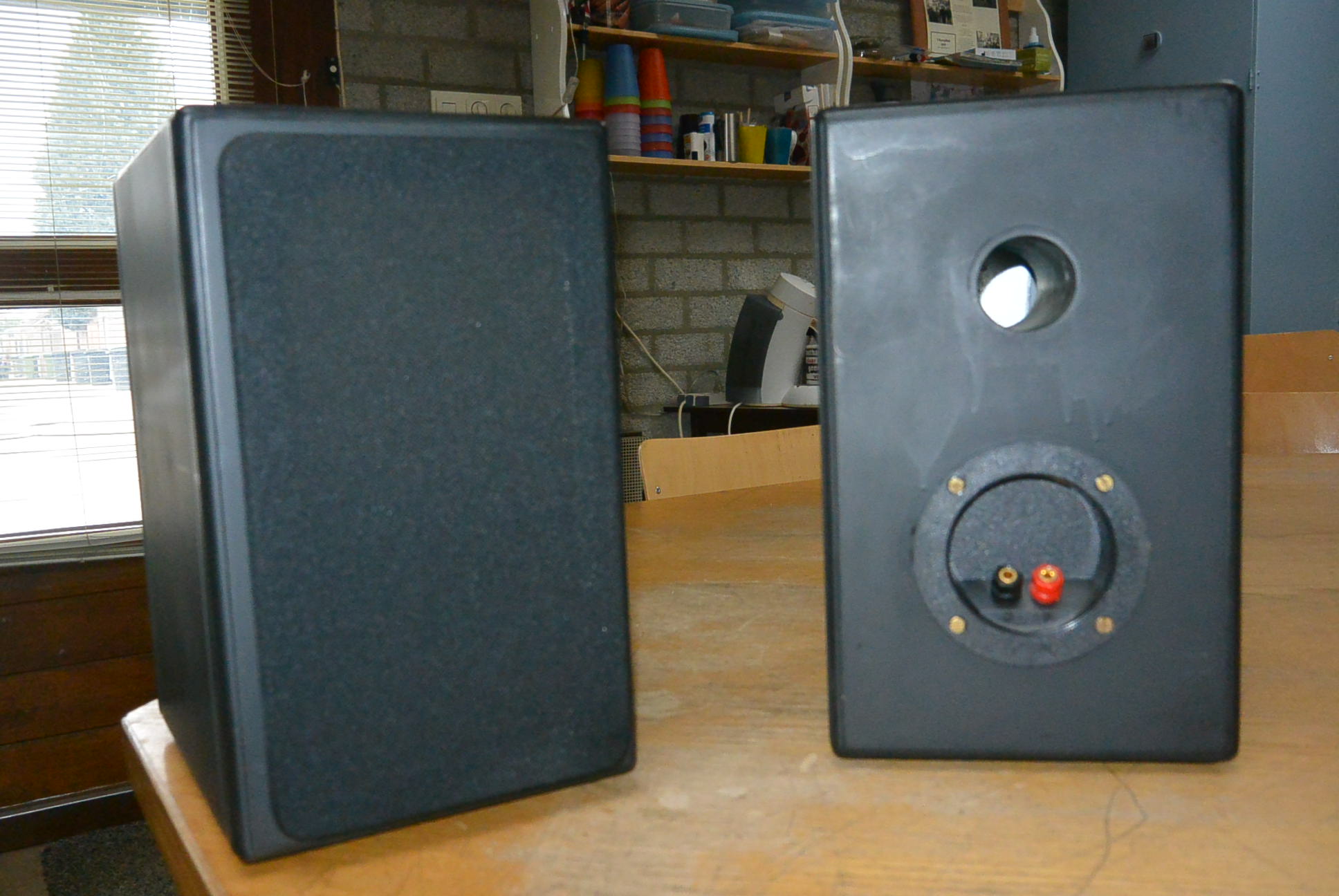

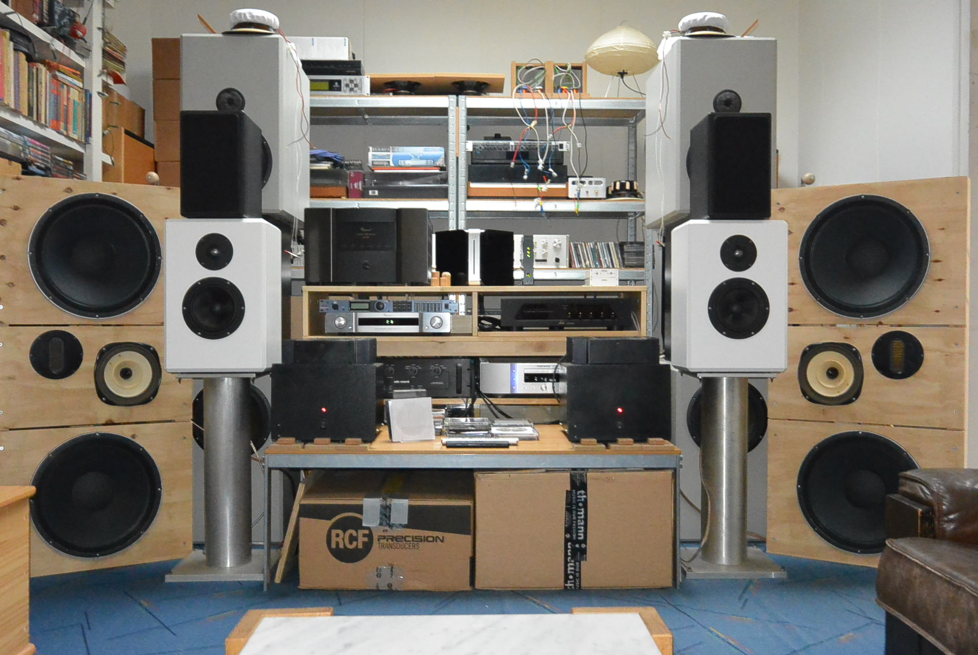

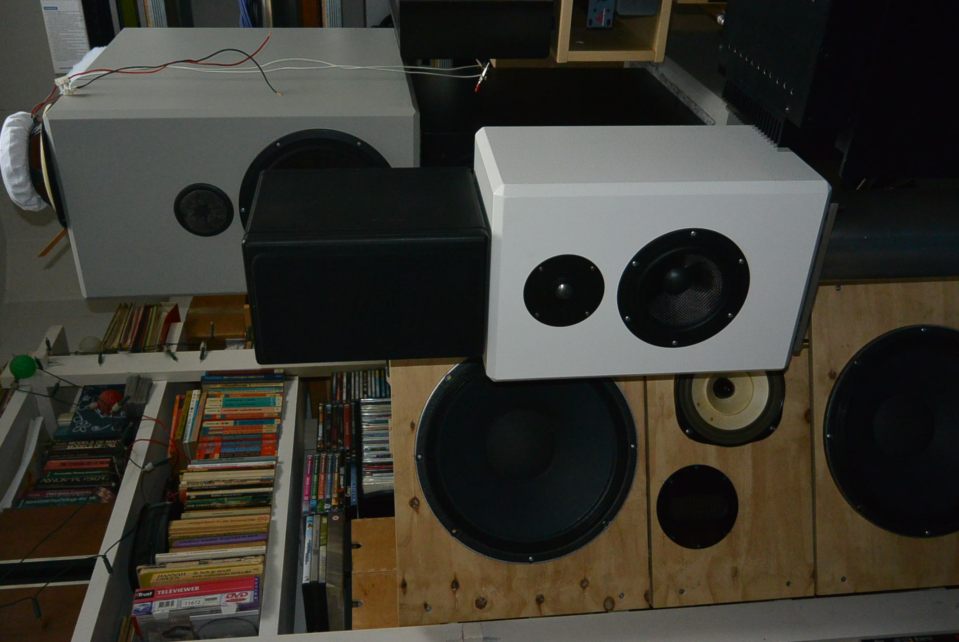

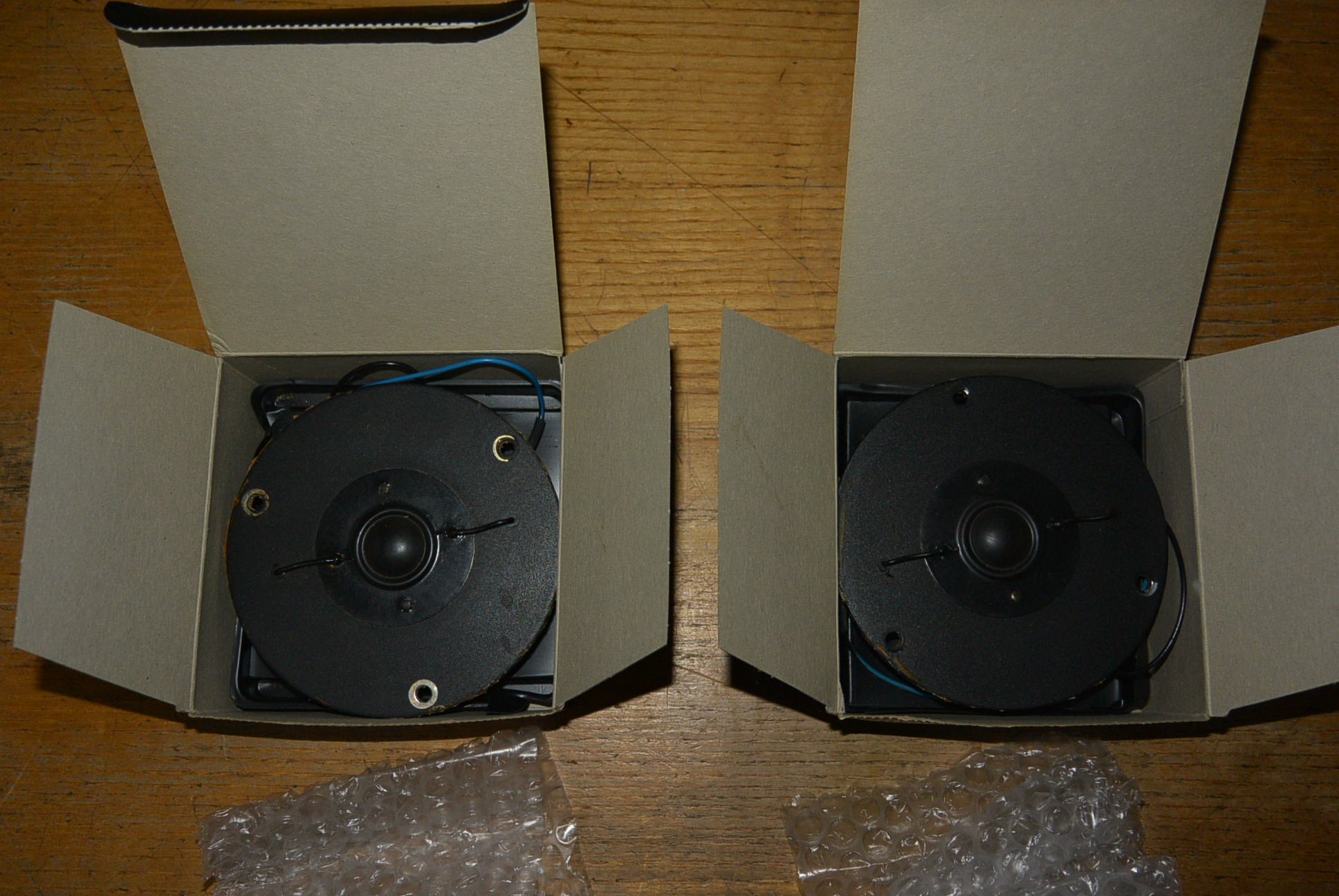

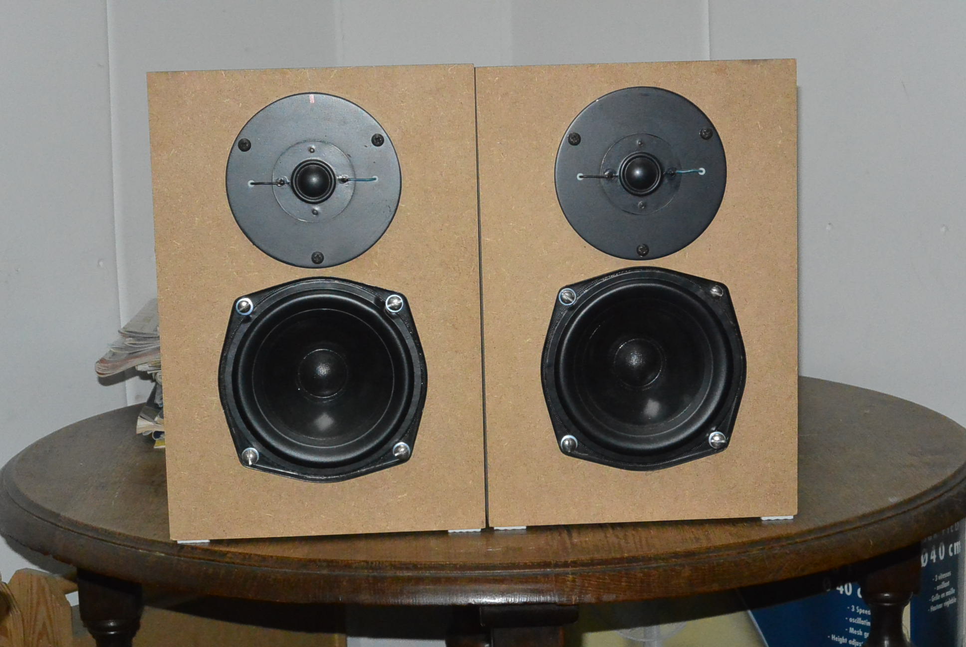

So did a second setup in the cabinets I had.
B110b (1057) in 6,7L BR.
They had Audax tweeters , so I changed for T27.
Did an intuitive SCS XO (same setup as the Krill) .
Final adjust by ear.
Last evening 3 hours listening and comparing with 2 audiophile guests.
We all agreed that the SCS XO is more engaging 🙂 and beats the KEF XO.
It's always nice to have some stock parts.
Next step for me will be :
The Bass from the first set with SCS XO 🙂
I'll keep the updates coming , if people are interested ?
sinc. Leon.

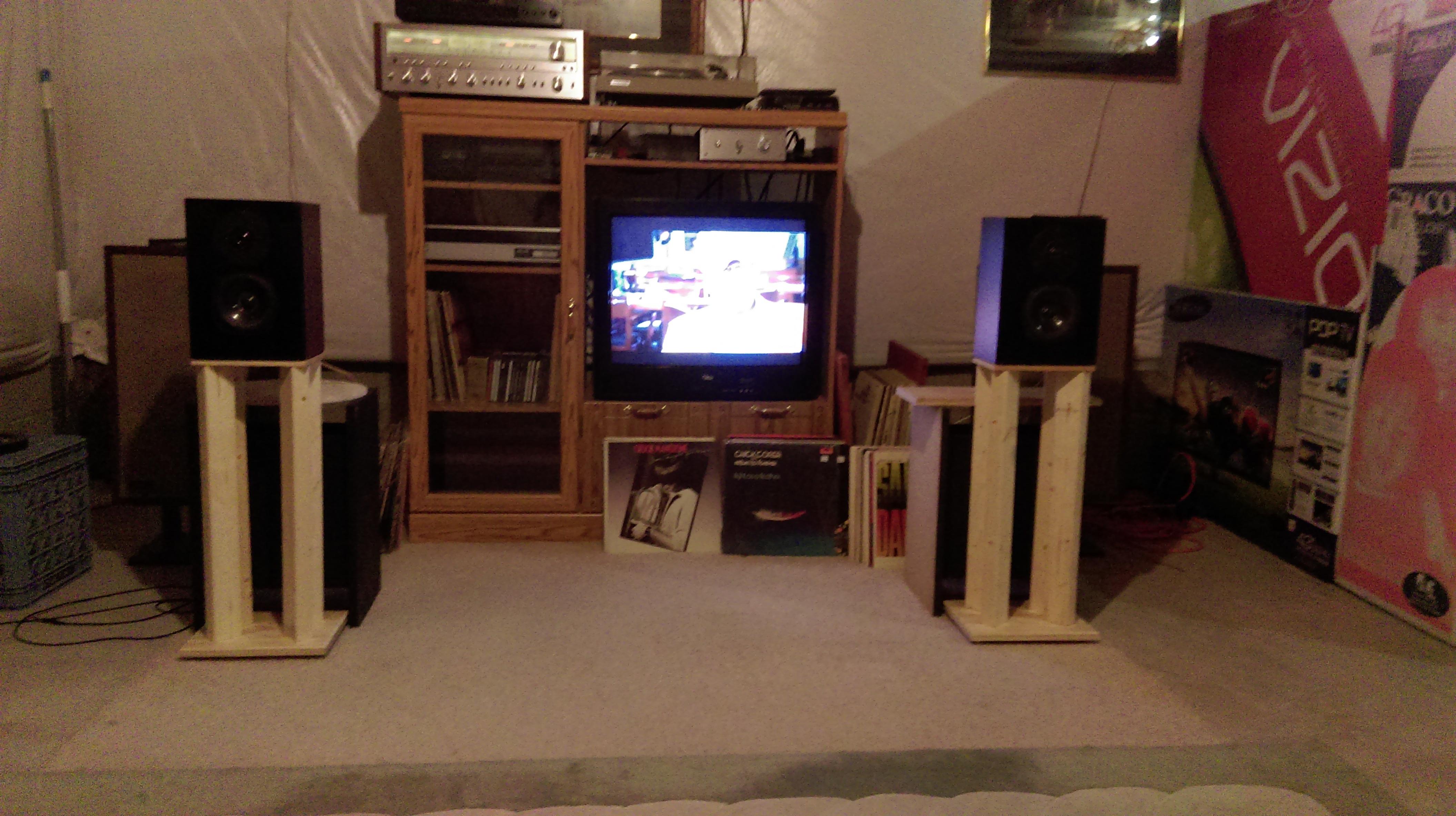

Hi all. Here are a few pictures. These came out real nice and sound terrific (really good on my restored SX-1250 surprisingly enough). Still need to paint the stands (they are 24 inches high).
My workaround for the dividing network that was burning off low frequency power was to put an 8.2 ohm resister in series with the tweeter filter. This was done by experimentation in order to get the levels correct (I left them a little on the bright side but that will be toned down by my Rowland Model 1 as it is dark). As it turns out after that change both the low and high pass are around 15 ohms nominal.

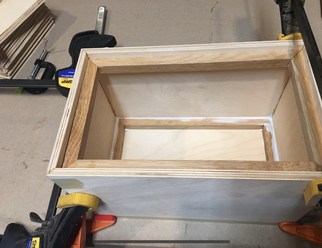

The box construction is coming along well:
881086d1601783669-rst28f-dc130a-foamcore-homage-ls3-5a-bbc95fbf-b607-4965-b986-178b97b3a865-jpeg

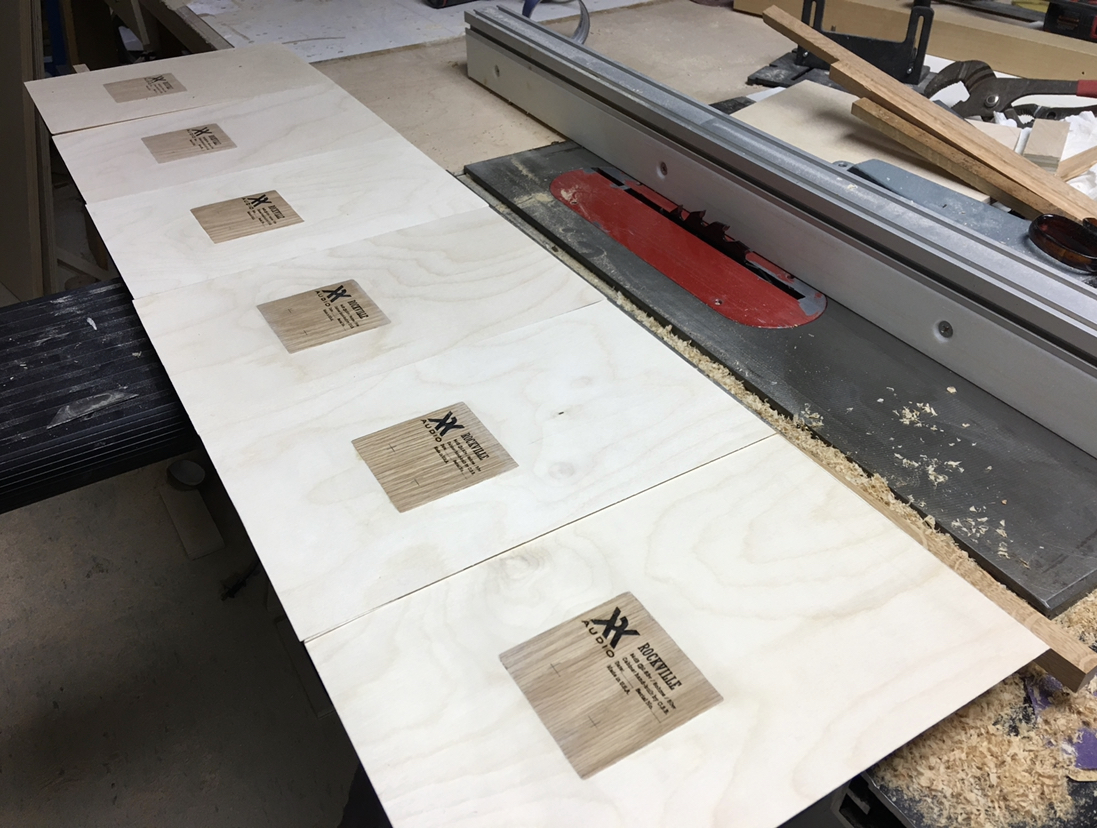

Back panels with inlaid white oak used on battens recovered from a Civil War barn near Rockville, Maryland:
880821d1601722487-rst28f-dc130a-foamcore-homage-ls3-5a-ad82ebe5-139c-4930-a4d1-5063d4d886d1-jpeg
Battens are framed mitered and framed outside and glued to panels with latex caulking for CLD type damping. Corners of battens are affixed to panels with PL Premium for strength and robustness. Front is 12mm BB ply to give room for flush rebates, all other panels are 9mm, and all mitered corner construction held together with PL Premium.
The baffle cutouts will be the last step and will be done this week.
