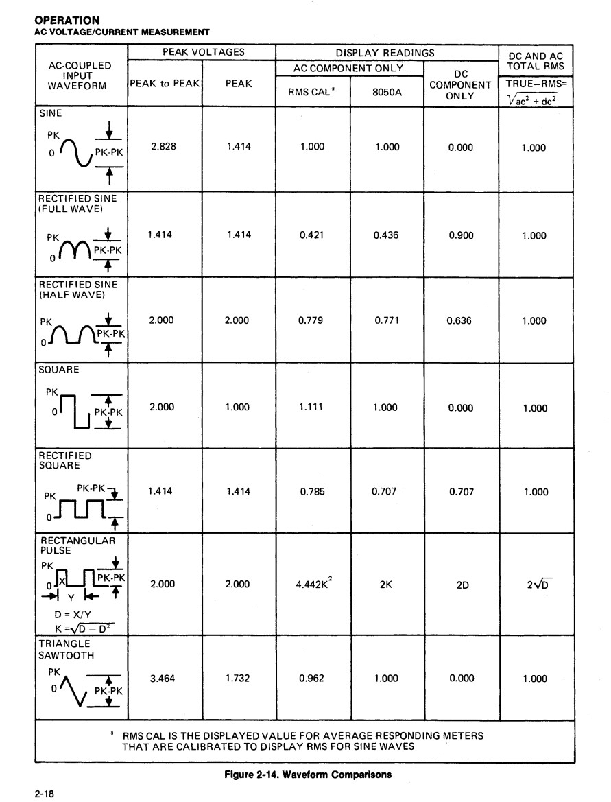

Can my DMM measure ripple?
Maybe on Vulcan, but here they typically block DC. What you get is the RMS value of the AC component of the waveform only. A clue is when you see the AC bandwidth specified with a low frequency of 40 Hz or so. Attached is a page from the old 8050a TRMS meter, back when they put such things in the manual. Note the difference between readings and the last calculated column for half rectified waveforms.

An RMS result must include any DC
Both are valid. If you will make sound, a DC-blocked reading is appropriate. But an odd but real-world problem is heating tube heaters with rectified (full or half-sine) AC. While very nasty, sometimes it is expedient for simple 115VAC line-power instruments. But what is the heating value? Both the AC and the DC matter. The math is hard to keep straight. As recently as the 1970s it was wise to check the answer with a #47 pilot light on both a 6V battery and (a fraction of) the rectified AC, going for equal brightness.

I suspect all true-RMS multimeters on the planet Vulcan by default measure RMS levels without blocking DC. Logically, the root of the mean of the square of 9 is simply 9.
Most high-end multimeters (that means a good number of true RMS ones) have the provision to be configured to measure the complete RMS value, including DC. That's the case with my huge, late seventies Datron, and at work even my handheld Fluke 83 could also be configured that way. The default setting is always DC-ignore though.
That said, I completely agree with Conrad: true RMS capability is rarely needed in real life, and it can be misleading: for many people, if you make the product of the RMS voltage with the RMS current into a load, you get the so-called "RMS power" (which can be calculated theoretically but has little physical relevance). What those people mean is in fact the average power, which is the result of calculations on RMS values, but making a scalar operation on just the magnitude of the variables only yields the right (average) result for a purely resistive, linear load.
In many cases, the average value has more sense and usefulness: saturation in transformers and inductive components is governed by the average voltage, not the RMS one.
The current output of a capacitive supply is also determined by the average value. This is why my home-made instruments have the ability to measure both (with the average value displayed as RMS, as in old-style instruments)

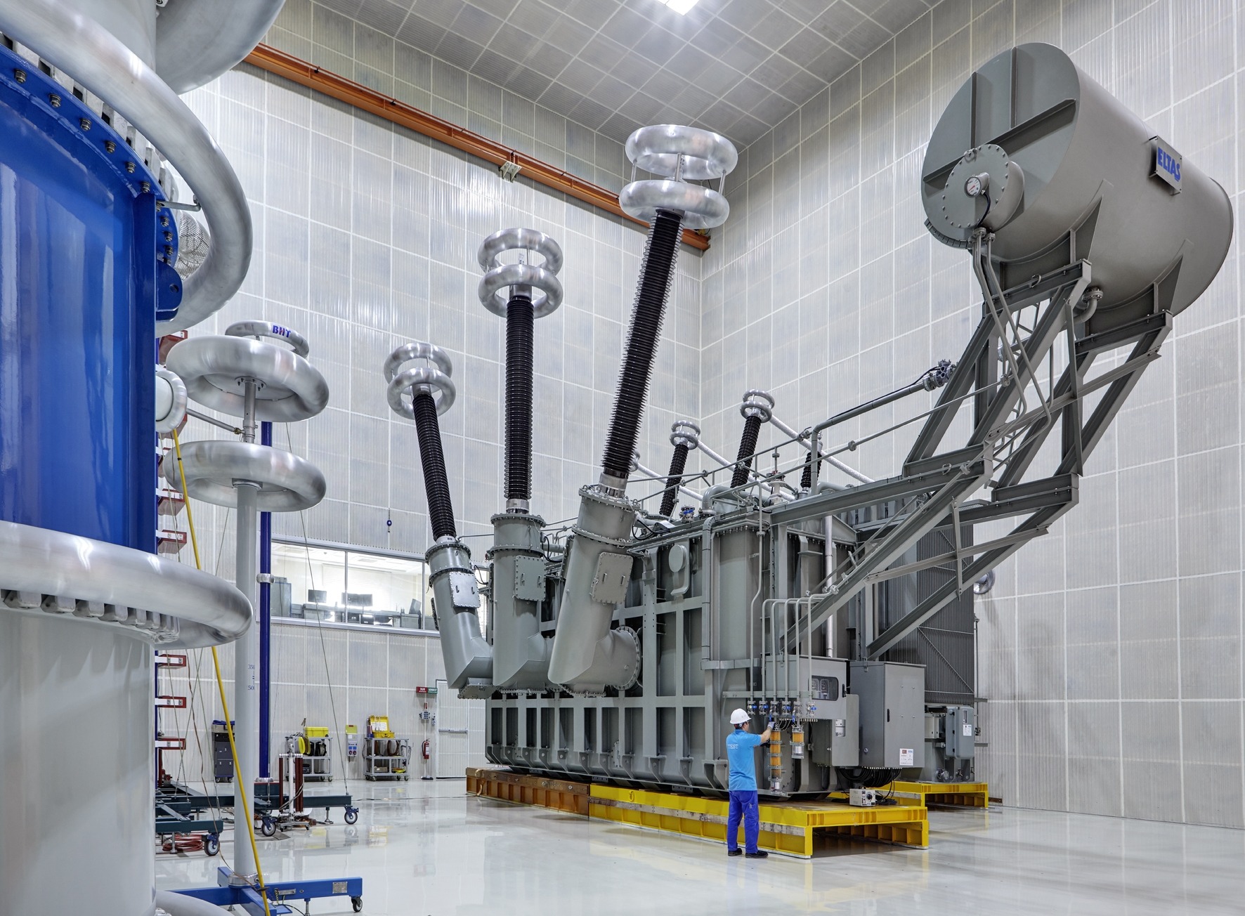

Scary voltages. Have you ever seen how 10 kV power distribution transformers are measured?! Also energizing them is an interesting phenomenon (soundwise).
It certainly scared me: the current that the power supply could deliver wasn't even close to that of a power distribution transformer, but it was enough for a lethal shock.
I haven't a clue how 10 kV transformers are measured. I guess from a safe distance.

Yes and with quite long measurement sticks. I think it is a good experience for many to view such an environment, the avoidance of risks and the way all are involved with safety. Only after having witnessed a few high power incidents I really learned to respect electrical power. It can be VERY scary.
