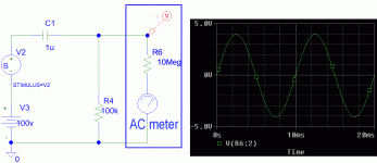

Grarea, all the true RMS Fluke DMMs I owned the last 20 years or so measured ripple. FWIW I work with expensive Fluke DMMs on a daily basis but like my own 117 most of all. Affordable and can take abuse. It really pays off to buy good stuff at once.

Cheap ones are pretty accurate: Chinese know how to use crap material in a clever and effective way - don't underestimate them- however, they cut the the cost down to the barebone, which is problematic in some instances, and some upgrading can do marvels on cheap Aldi or Lidl sold devices.
I have done it, and it works OK. Everything that is required is basically present, you just need some dressing up, at least if you operate at a single frequency (50Hz in my case).
The basic ranges of the original instrument were much too hgh for my tastes, but he adapted version was perfectly usable

When I did measure the AC on the DC before I fried it, all three came in similar.
(Not sure I'm remembering the scale right)
My salas l-adapter, a nineties linear PSU and a RPi official supply all came in between 8-10mv.
I was Wondering if something else was limiting it. As in the cables or the dmm itself.
