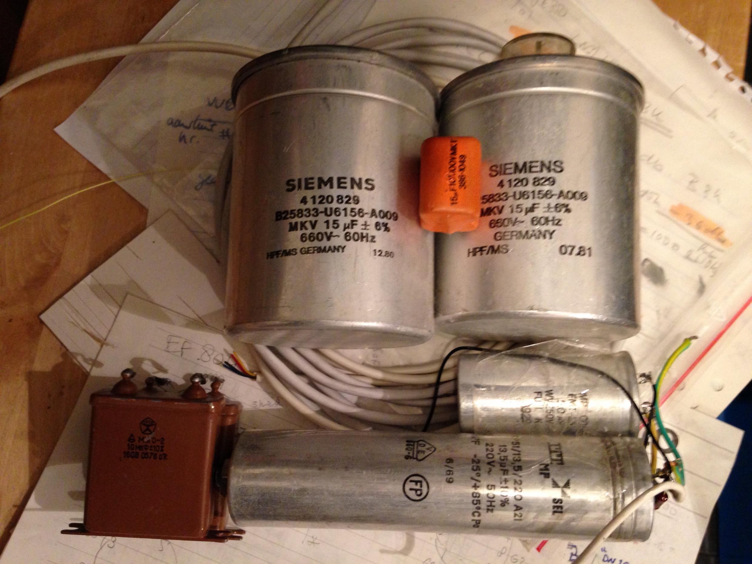

So I went ahead, but got scared, chickened out, because of the sizes.
So I went for 15uF red 4 cm MKT's I have available too in the old box. Wound in anti-inductive way. The result was great (already), sibilance gone. But also more pronounced high frequency in general, balance of harmonics was 'new', you have to learn the new balance.
My wife likes it, that is a good thing.
I should try to adapt the circuit a bit.
The old 15uF bipolar electrulytics (ROE Germany, from 1979) caps looked good, but one strange thing: they meased differently in one direction than in the reverse direction. 16,5 one way, 14,9 the other way, while my cap tester only sends out AC. Might have to do with forming of the dielectic. Good grief.
That implies that in a signal the polarity that changes thousands of times a sec, also changes the polarisation. . . .
- yes I had at hand MKV 15 uF - is 15 cm dia
- and 15uf motor run combination - is 25cm high - . .
