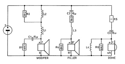

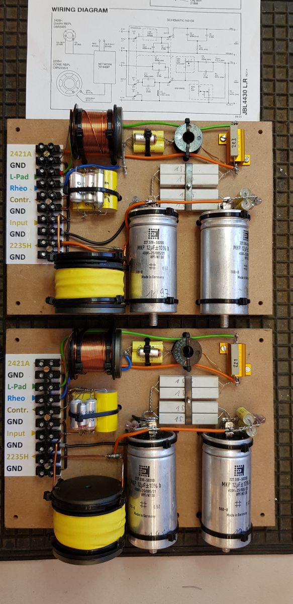

That looks very professional. I would be glad if I can work like that. The Beovox 45 filter is simple: three 6 dB filter sections. And each section has a 15 uF capacitor. I do scratch my head - how on earth have that on a tweeter. But I'll see.

Thank you very much! It took quite some effort to get them into that. I had to unwind all three stock inductors, parallel all resistors and all capacitors to achieve their required values. All components were measured individually, and all actual values match the specifications in the schematics.
The design isn't that complicated: A 12 dB low pass filter, a 12 dB HPF, an impedance correction RD network in parallel with the 2235H woofer, a L pad for the 2421A CD/horn, a 12 kHz bypass, adjustable via a rheostat, that's all 😉.

EDIT: See the N-3134 schematics in the upper part of my pic 🙂!

In comparison, my BeovoxS45 is simple, with 6dB/octave and a few extra components.

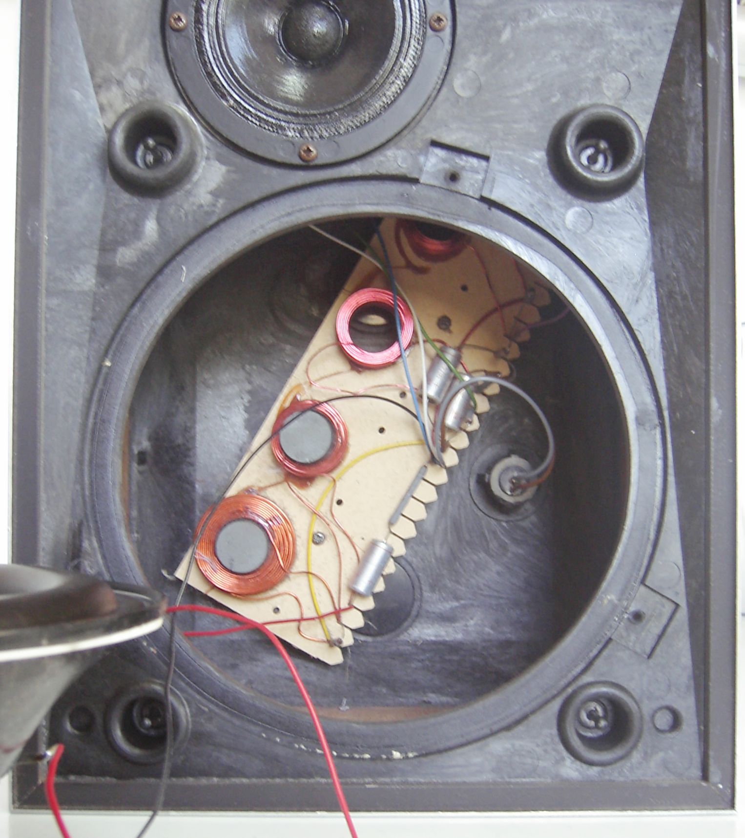

They drew it a bit difficult, should have L1 on top (L2/R2 is sort of baffle step). Then all parts at the bottom are impedance corrections. In real life, the two capacitors c2 and c3 are indeed joined together to the plus.
Most strange is that the tweeter C3 is also 15 uF because with L4 at I-guestimate-@100-150mH it will be a few ohms in low frequency for that segment with R5=1 ohm. There are three electrolytics, all old small dried up 16uF ERO bipolars. . I'll measure everything too. I expect R5 to really be around 4 ohm. Having a small mark in the symbol often was a way to identify the type of resistor . . .
from left ro right L1-4 & the three 16 uF bipolar electrolytics.
- Anyway, I wanted to revisit the schema;
BECAUSE,
- any 3way/db parallel can be better set in series. The speakers then have better damping=less loading, outside the band. And as I want to exchange the tweeter with an RD-1 ribbon tweeter, that is important.
- As I see it, that is how L4 is used already. Shunt all very low frequencies from the tweeter.Placed in series, it will have a double 'shunt'.
- I will have to adjust R5 then, to get right timbre.
