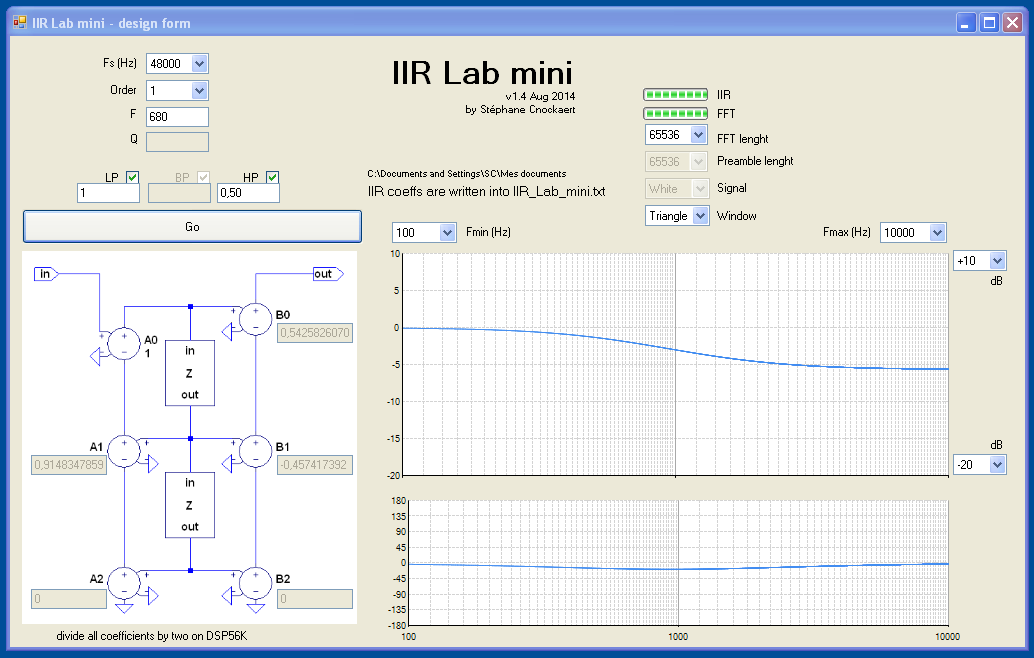

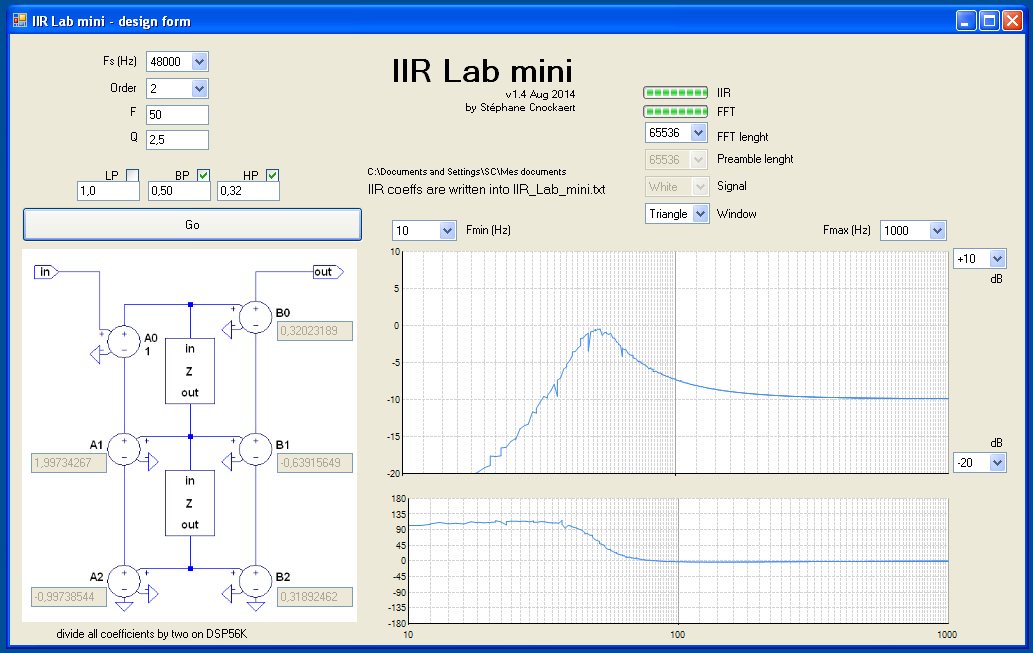

Suggestion : three IIR Biquad filters to be used in a equalizer section, located before the 2-way crossover.

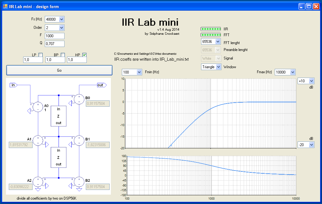

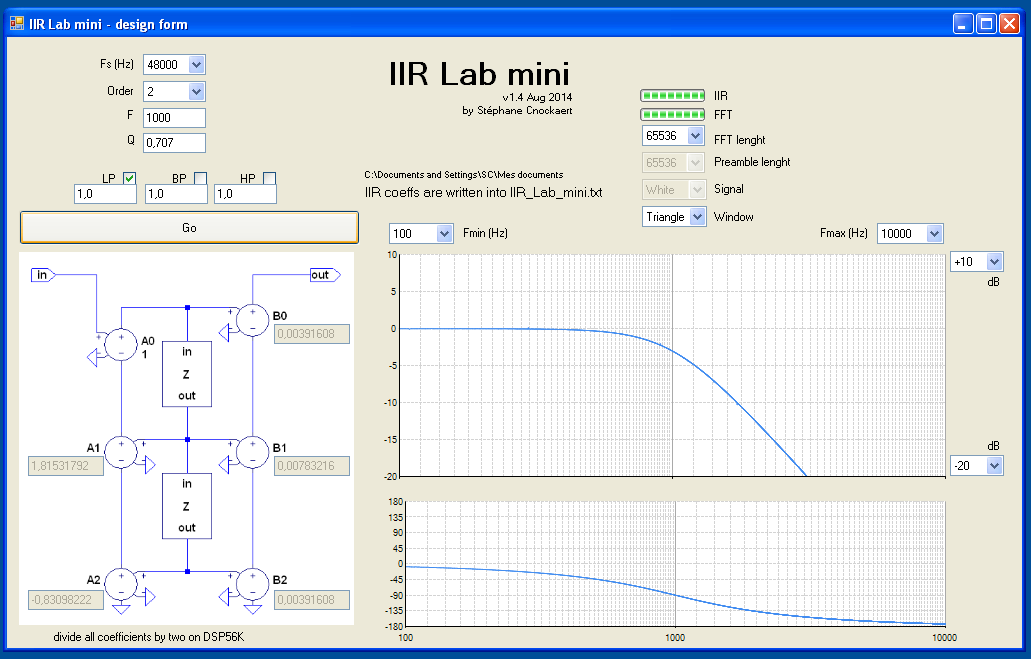

Suggestion : three IIR Biquad filters to be used in the crossover, woofer section.

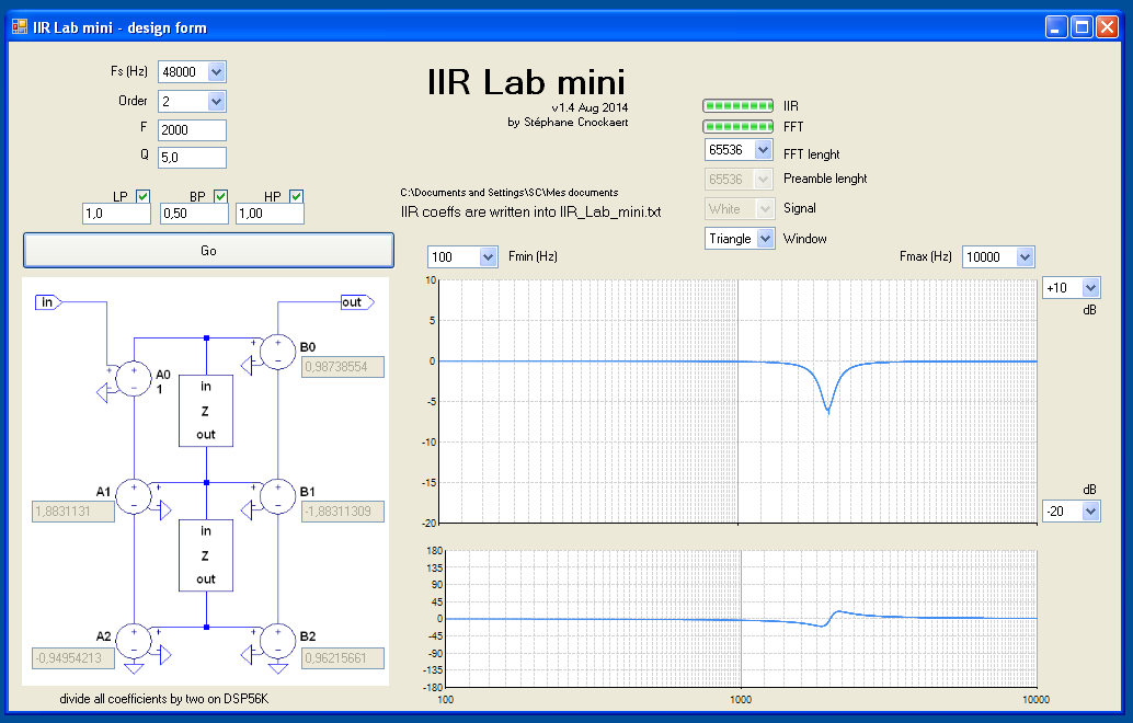

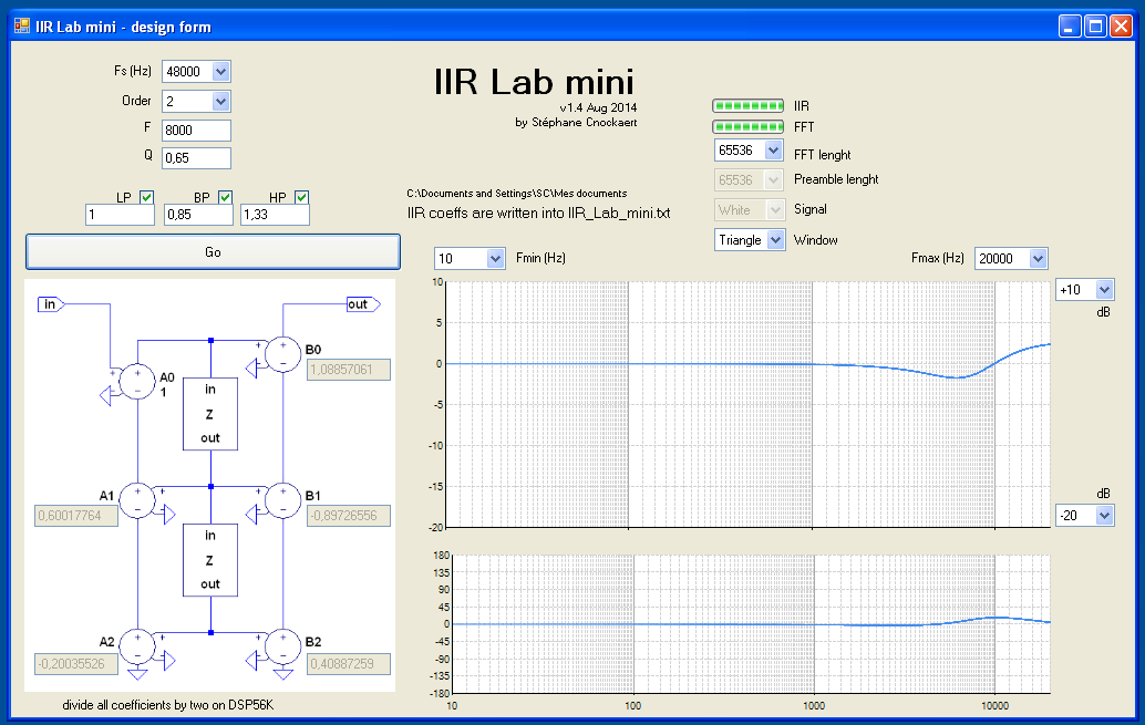

Suggestion : three IIR Biquad filters to be used in the crossover, tweeter section.
