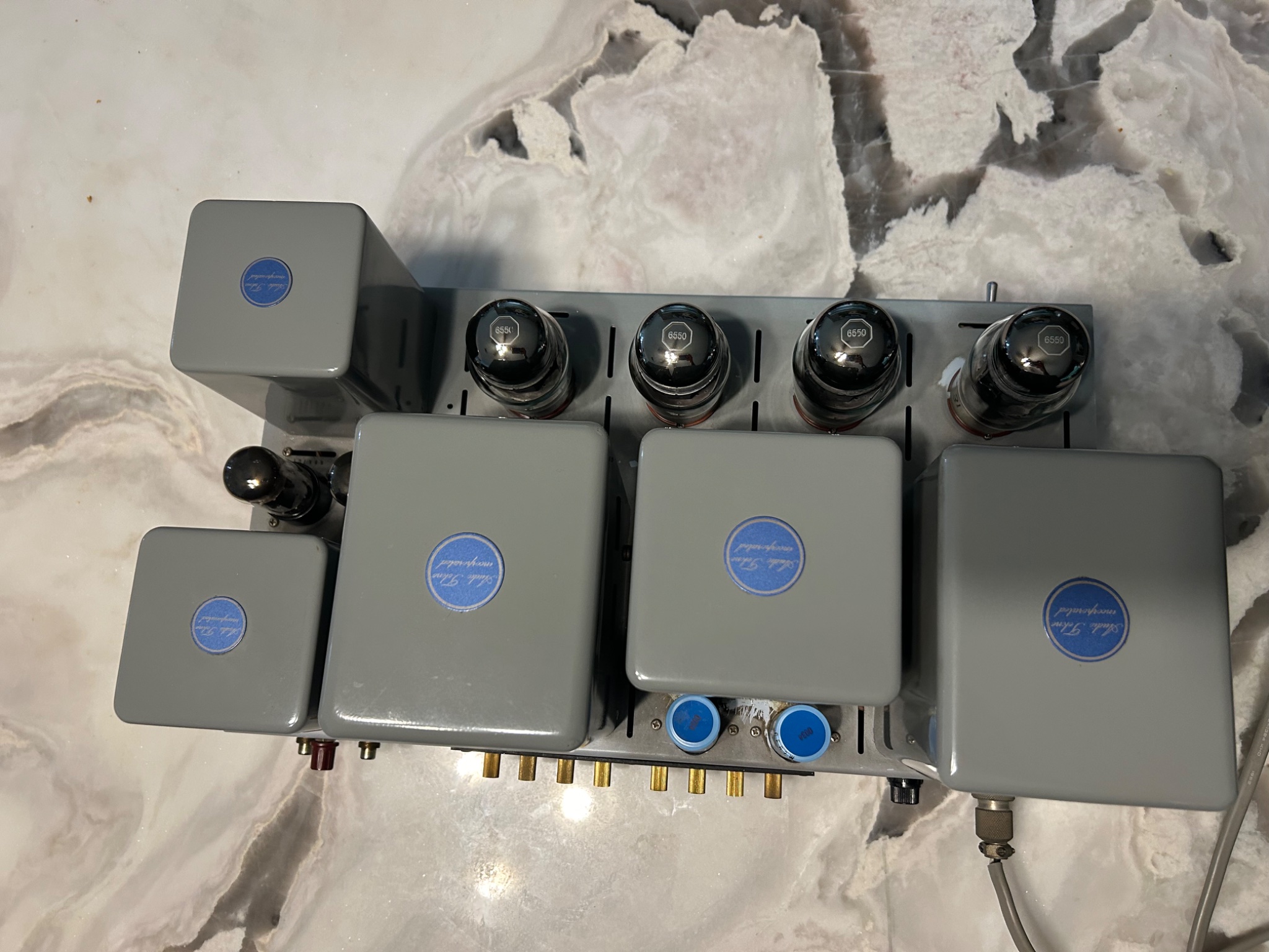

The power amp seems to be professionally built. I would be careful randomly changing parts. Who did this work ?
No reason to expect big sonic changes from parts swapping : the sound may be dominated by the big number of transformers in the signal path.
I see an Input level control in the power amp picture which is not shown in the schematic, some loss of treble can be expected If it is not in "full" position.
Sorry that cable was original cable with that schematic in photo how it was shown in the listing, i just didn't trim the photo to show only the schematic. The schematic is taken from the internet, not exactly representing my amp i don't believe. It's the only one that could be found. The only parts change was taking that round connector and installing an iec inlet at a local tech's shop. All the rest of the parts are original as far as i can tell, but changing resistors and capacitors to better quality with same values was my only intention outside of tube rolling.
I keep the level control at full volume at all times.
I also figured not much change in sound as it is transformer dominated like you said, but it couldn't hurt to put fresh caps and resistors right?
That looks like a nice amp. Can you show us a pic of the top side? Who made it for you? What brand of transformers does it use?

Sorry i didn't see this post yesterday. It's vintage Audio Tekne from Japan. Imai san who runs a small shop with his wife(she wires all the cables by hand) and son transformer couples everything. Always push pull. Carbon for isolation. He uses supermalloy transformers, though im unsure if my amps are. I use the ALT-8905 isolation transformer and voltage conversion and i have an LT-8310 that i use with harsh digital sound. Audio Tekne litz cabling, however my amps are before he started using litz cable so i think they're just vintage tinned copper.

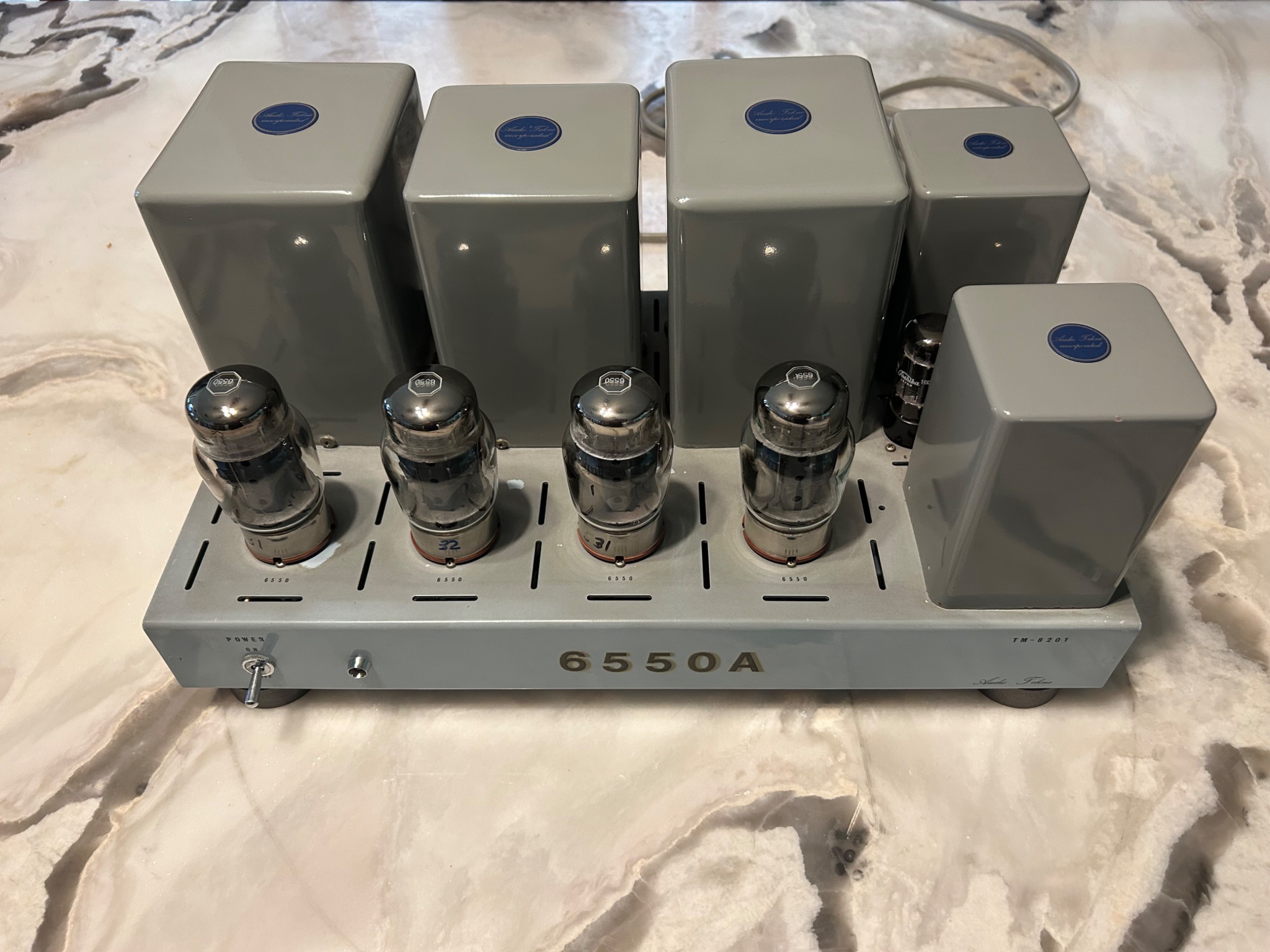

No, the output tubes are cathode biased, which you can tell by the large white cement resistors and bypass capacitors next to each one. I think KT66's would be fine in that amp. The Gold Lion KT66 is a wonderful tube, the only one I use in my Williamsons. Avoid the Chinese KT66 (sold by TAD, for instance). They sound much worse and produce lower output wattage at higher distortion. You could also try 807s or 5933s with adapter sockets. A very romantic, liquid sound, close to a 300B really. The Gold Lion KT88 is a very good tube. Also, any 6L6GC would be fine. The 7581a is quite a nice tube and relatively inexpensive, has a big open sound. The Tung-Sol reissue 5881 is smooth and buttery and would also work.
The limiting factor with the 6384 is the screen voltage limit, which is 325VDC. Triode-strapped as they would be in this amp, the screens would see 400VDC. They might not be happy. Typically they would have been used as pentodes with lower screen voltages. It's doubtful they would "blow up" but if you try them and notice a red glow at the seams of the plates, I would not continue to use them.

Again, a very low max screen voltage. Not advisable.
Ok i'm going to take the dive into the 807/5933 b/c your liquid and near 300b description.

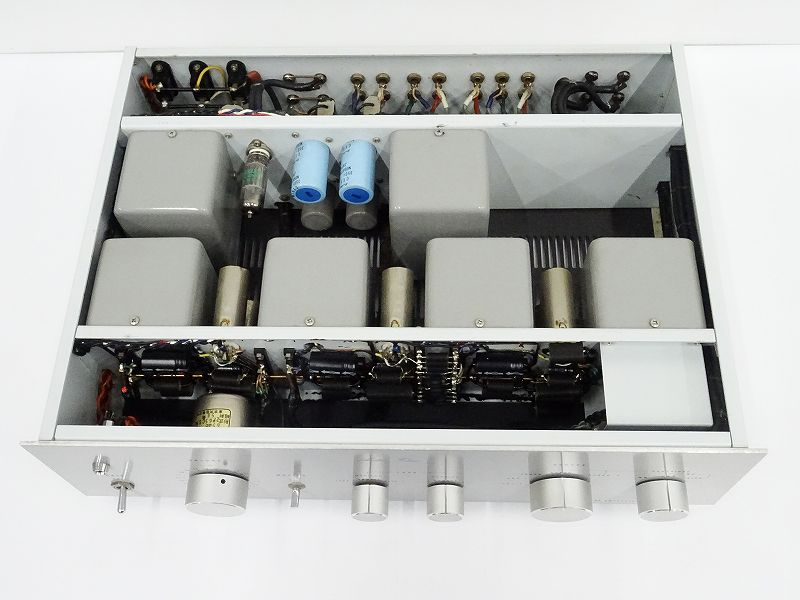

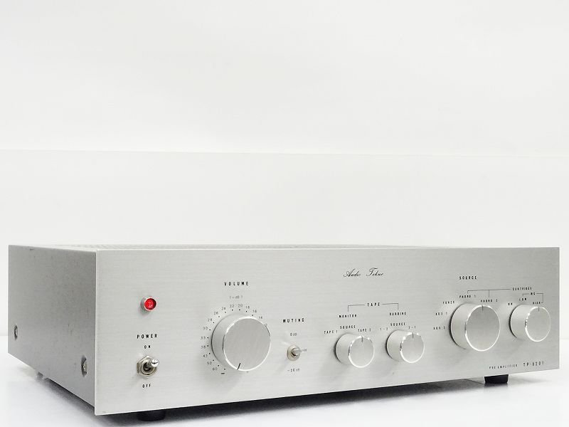

For the preamp, if that is a phono stage I see, then I would not change the 12AY7, since it will mess with the RIAA curve. And I would not mess with the rectifier either.
I do not use phono, so would that change anything? I've come across the 12AV7(gain factor of 41) as well as the 5965 which has a mu of 47, 12ay7/6072 being 45 mu. Is that close enough? I see also E180CC. I'm not sure if thats the same as 5965 or different. I'd love to try a telefunken in my preamp. If a change were to be made, would i need to change all tubes to same type including phono even if i don't use that input? Or if i only use AUX input, could the input tubes remain 12ay7 and the output tubes be 5965 for example?
@grovergardner All i had on hand was a tung sol 12at7 and triple mica GE 5 star 6201, They sound great in my preamp. Surprised it actually feels like i need to use more volume, however. I worried it might be too loud at too low of a volume, but that's not the case. The Tung sol AT7 with my tung sol AY7 at the aux input position sounded great last night. Those Tung Sol 12at7 give me a touch of what i wanted from those Telefunkens ive heard before. 3D. Sparkly highs. Wide soundstage. I've never been disappointed in a NOS Tung Sol. The GE went in this past hour and it's perhaps too sweet now and lacking low end, but increased vocal intelligibility which is where i think the new production 6550s hold my system back. Clearer vocal with the 6201. Highs are still very sweet and sparkly, but it just feels slightly rolled off/rounded off at the bottom.
The 12AY7's i've heard so far. These United Electron branded Tung Sol 12AY7 short plate, musical but soft. The both very well regarded GE 5 star triple mica 6072 and Raytheon blackplate 6072. The GE just didn't do anything for me. The Raytheon i loved at first, in fact i loved every Raytheon at first. They sound dynamic and fast at first, but over time they sound solid state and boring to me. Overall i can see the 12AY7 doesn't add anything and gives lots of headroom. Maybe that's why they are used in high end japanese brands like my Audio Tekne or Kondo's flagship models. I can imagine if i had a dac that used the Tung Sol 12AT7 or a Telefunken, and the power amp used more sparkly tubes as drivers, then i'd be happy with the preamp using 12AY7, but the 6550+6bX7 power isn't giving me that 3d-liquid-sparkly sound. Now, i can't judge it rightfully the way it was intended with NOS 6550. The quad NOS GE 6550 were failing and too quiet. The New production Tung Sol 6550 sounded great coming from failing tubes, but over time i think they are the weakest link.
