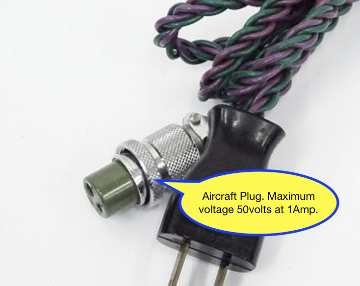

Confusing readers by showing an "illegal" mains cable in post 1 ..

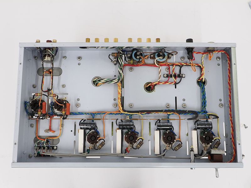

The power amp seems to be professionally built. I would be careful randomly changing parts. Who did this work ?
No reason to expect big sonic changes from parts swapping : the sound may be dominated by the big number of transformers in the signal path.
I see an Input level control in the power amp picture which is not shown in the schematic, some loss of treble can be expected If it is not in "full" position.

Sorry that cable was original cable with that schematic in photo how it was shown in the listing, i just didn't trim the photo to show only the schematic. The schematic is taken from the internet, not exactly representing my amp i don't believe. It's the only one that could be found. The only parts change was taking that round connector and installing an iec inlet at a local tech's shop. All the rest of the parts are original as far as i can tell, but changing resistors and capacitors to better quality with same values was my only intention outside of tube rolling.
I keep the level control at full volume at all times.
I also figured not much change in sound as it is transformer dominated like you said, but it couldn't hurt to put fresh caps and resistors right?

Also, you'd be well off to invest in one of those bias measuring kits. That way you can always check and make sure your output tubes are running within spec. It's a good tool to have, and the math involved is extremely simple:

They make fancier ones with built-in meters, but that simple socket and meter would let you check one of the tubes the first time you use them and make sure they are happy.
